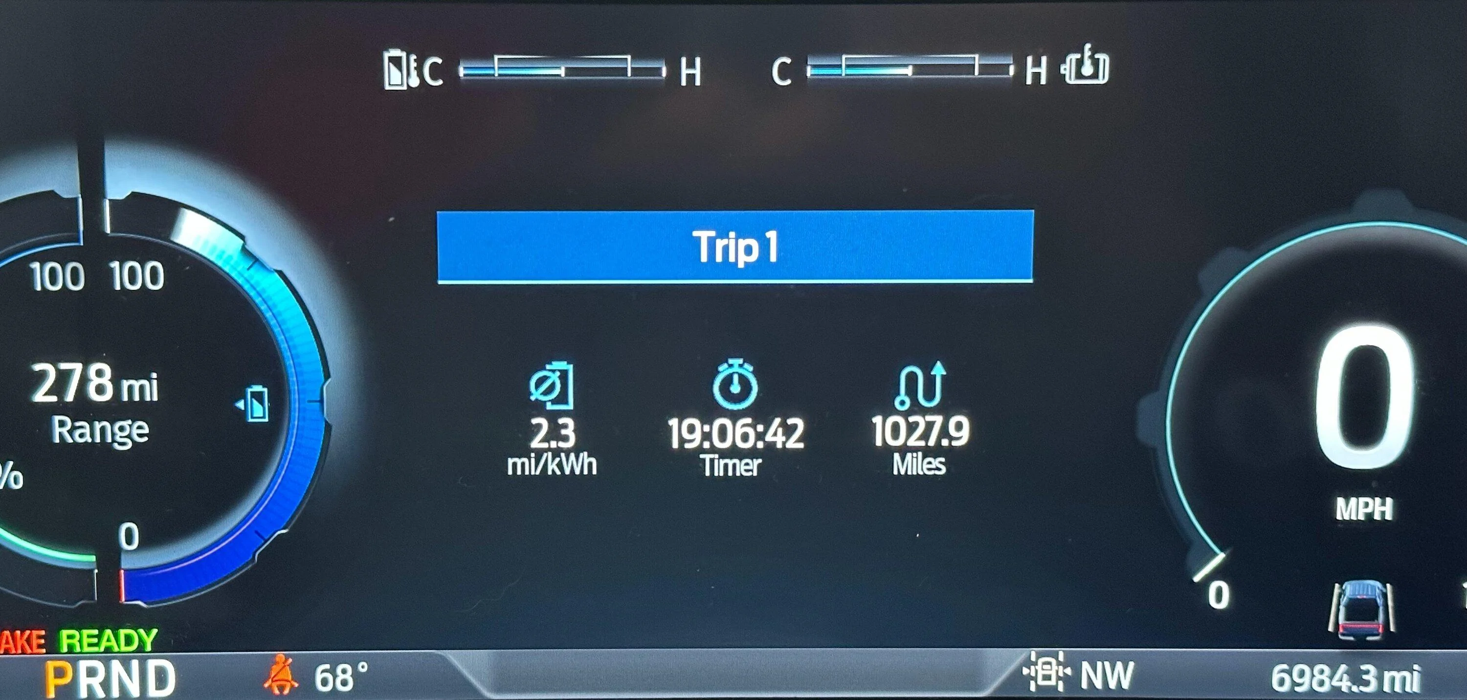

I just completed a thousand mile road trip that I had done previously -- prior to the navigation update that was supposed to make the guess-o-meter more accurate. Before the update, sure, yeah, the guess-o-meter was pretty optimistic and I could see how it might get a new EV driver in trouble. Unfortunately, since the update, the needle has moved far in the opposite direction as it's now extremely pessimistic. For example, on one leg of my trip, it suggested that I wouldn't make it to my destination without a charging stop. I turned off the nav, powered through and ignored it. I pulled into my destination with 42% battery -- clearly no intermediate charging stop(s) was/were necessary.
Ford F-150 Lightning Guess-o-meter navigation update is very pessimistic IMG_2120
On this trip, I was driving through mountainous West Virginia and western Pennsylvania. Lots of regen opportunities or at a minimum, almost no power consumption on the downhills. For the whole 1000 mile trip, almost exclusively highway, I averaged 2.3mi/kWh, which, with almost 7k miles on the odometer, is pretty typical now for me. I don't do the one-pedal driving mode, because it's not efficient for highway miles. I'm sure some current/past Tesla owner may try to counter that point, but I come from the Porsche school of coasting is more efficient, be it EV cars or motorcycles. With more than 50k+ miles into my EV road tripping experience, you're probably not going to change my mind.
Back to topic, is anyone else seeing the same thing?

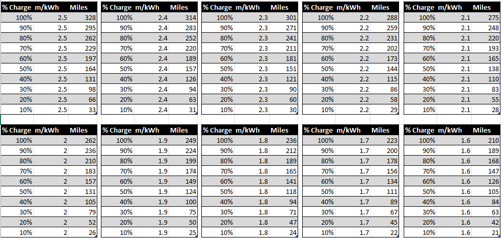

Yes... the GOM cannot be trusted since the last update. I have noticed that using the Ford nav is what really throws everything off.
I received an update the night before a road trip from Vegas to Phoenix (my first road trip) and I was white-knuckling it most of the way, wondering if I would make it. (I made it easily)
I just created a chart to keep with me that calculates range based on my driving.
