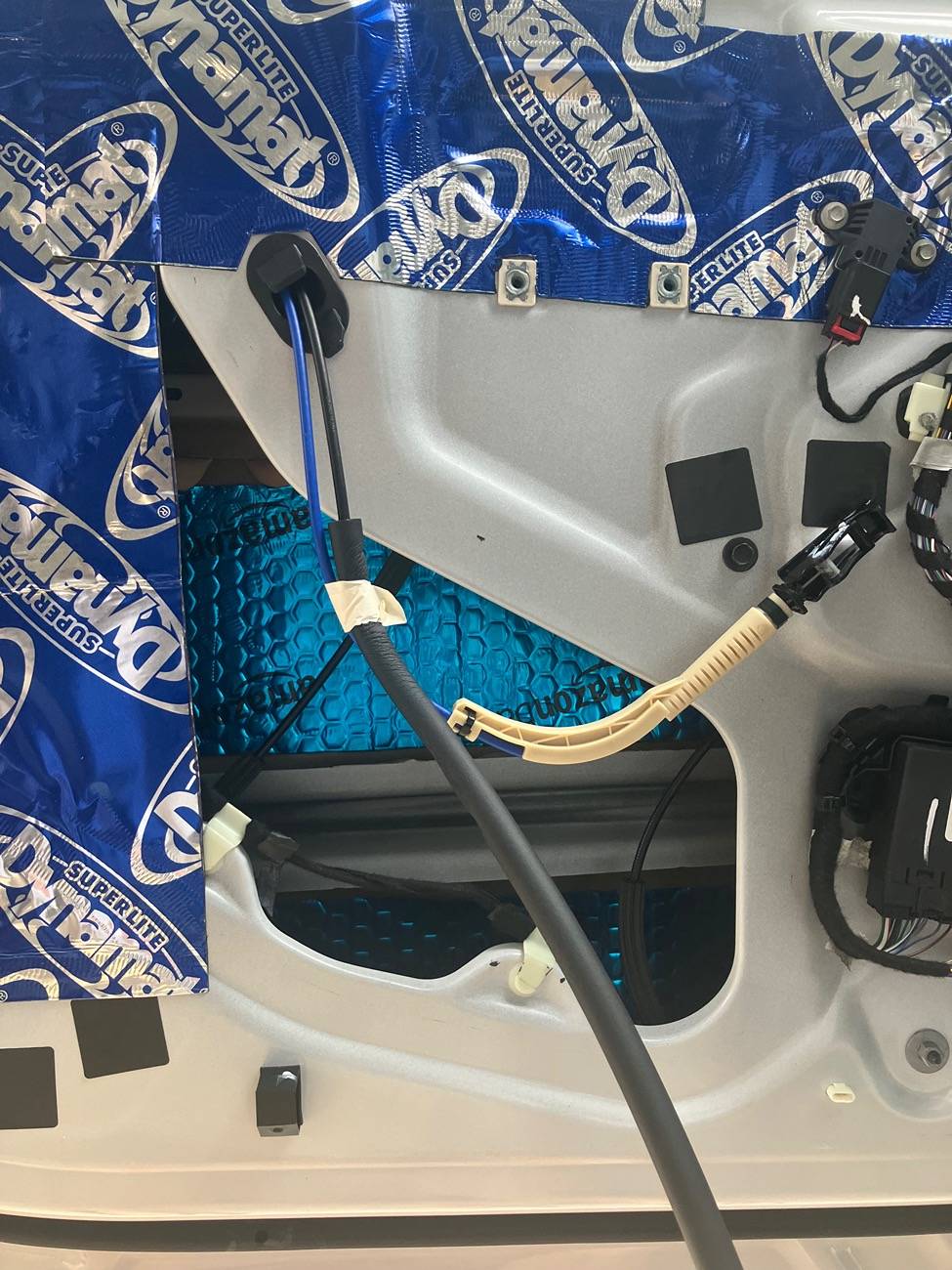

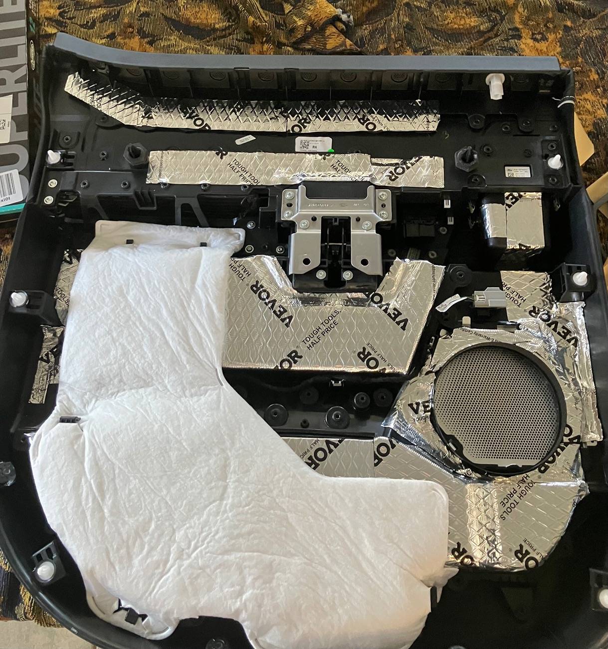

When I did my sound suppression, I ended up using a combination of materials on each of the three door surfaces. Simply did dynamat on the rear panel behind rear seat after pulling everything off.
For thermal control, I just focused on the glass & went with a ceramic film on the windows and haven’t been unhappy since.
The way the doors sound now when they’re made to close - bank vault solid.
