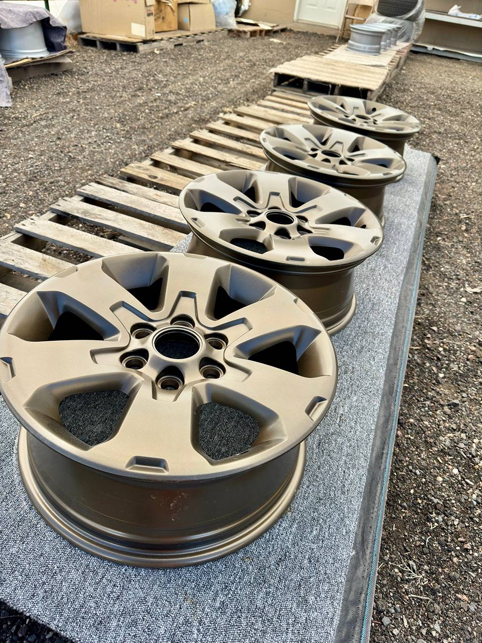

I'm looking to pickup some Michelin X Ice snow tires for the winter here in Colorado. They'll go on a second set of 18" rims. Michelin sells these tires in 275/65R18 and 255/70R18. These two-size tires have identical diameters and load ratings. The 255 tire weighs 36 lb and the 265 tire weighs 41.3. My rims are 18x7.5" OEM wheels off an older F150 FX4 lariat that I had powder coated.
Are there any performance negatives with downsizing a winter tire?
Have you downsized and enjoyed the setup?
