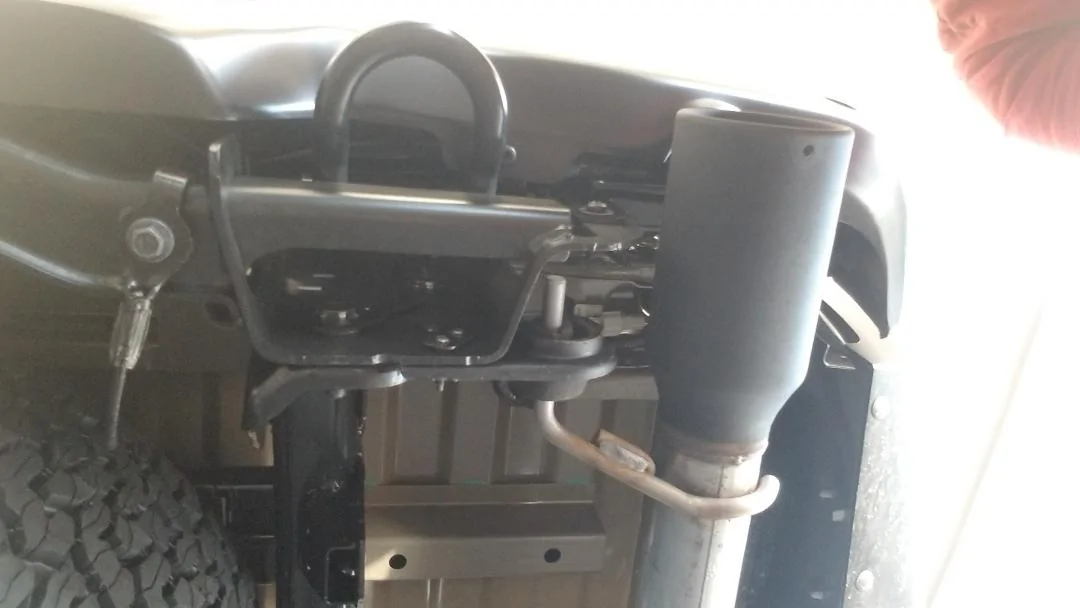

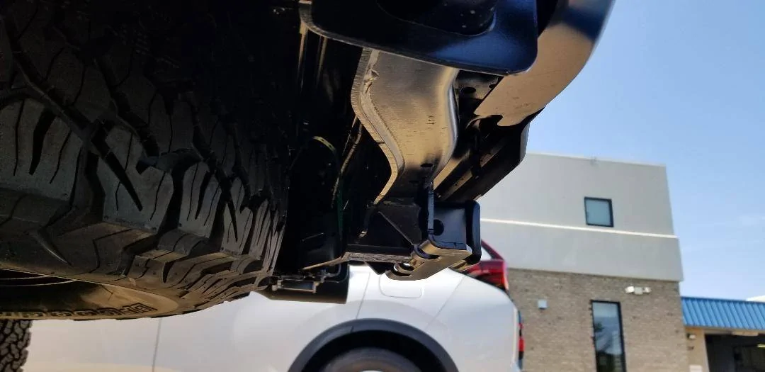

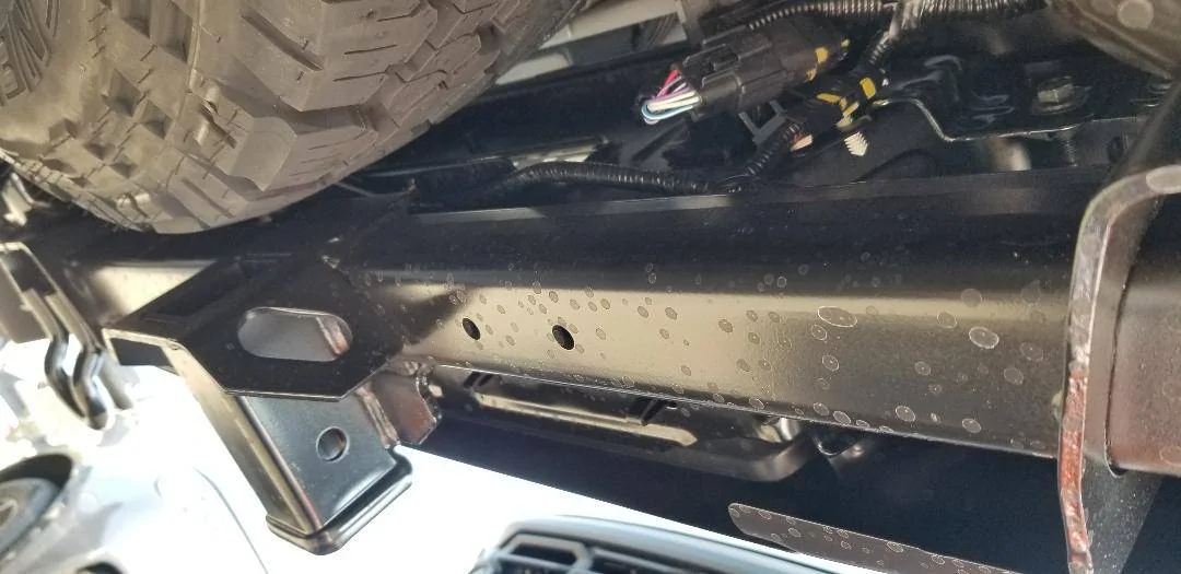

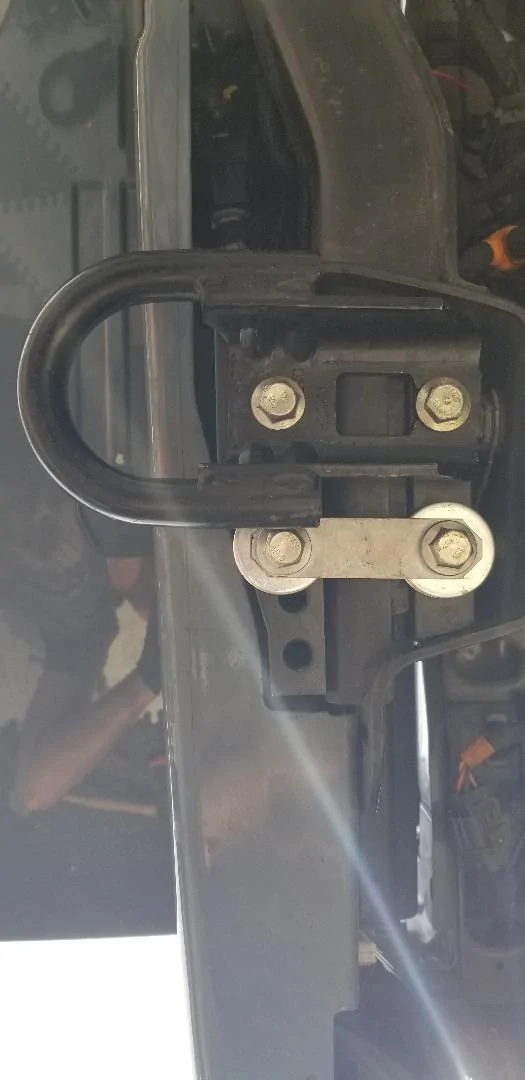

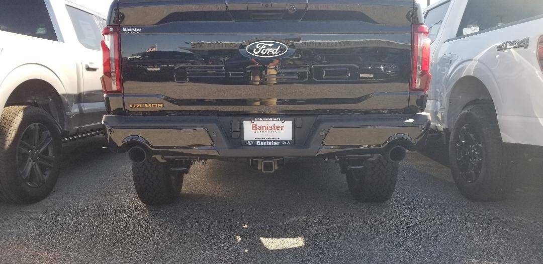

For what it's worth and after doing some hands-on research, I am convinced that either the late-model Raptor rear bumper horizontal hitch draw bar or the late model Tremor rear bumper horizontal hitch draw bar would work on our Lightnings. Both these horizontal bars with OEM welded-on tow loops appear to be a bolt-on item. However (there usually is a "however", right?):
The Tremor bar will cause the loss of the full-size spare tire underneath, although its welded tow loops will fit just fine under our Lightnings' rear bumpers without modifications. Part # is ML3Z-17D826-D. Details are in the next section below.
The Raptor bar will allow the retention of the full-size spare tire underneath, but its welded recovery tow loops will either force accomodating cuts in the Lightning OEM rear bumper end cap casings, or will necessitate the addition of Raptor end cap rear bumper casings. Part # is ML3Z-17D826-G. Details are immediately below.
WHY: on the Tremor rear horizontal tow hitch draw bar, its OEM recovery tow loops are welded onto the bottom of the bar, and furthermore angle downward from there, therefore, they will clear the Lightning's bumper end cap casings. Unfortunately, this horizontal hitch draw bar is straight all across (see picture #1). The Tremor's full-size spare tire allows this when nestled underneath the bed in its spot... likely because the Tremor doesn't carry a humongous axle-to-axle battery and motor down there to push the spare tire location further back, and also perhaps because the Tremor's rear suspension is old-style leaf springs and not the Lightning's huge independent rear suspension cast arms and so its mountings take up less front - to back space. And so, the center section of a straight horizontal tow draw bar from the Tremor's will simply not fit under the Lightning if our spare tire is nestled underneath. This might work for some but it wouldn't work for me.
Ford F-150 Lightning Has anyone installed tow hooks, loops or shackles on the rear frame rails? Tremor rear hitch horizontal draw bar

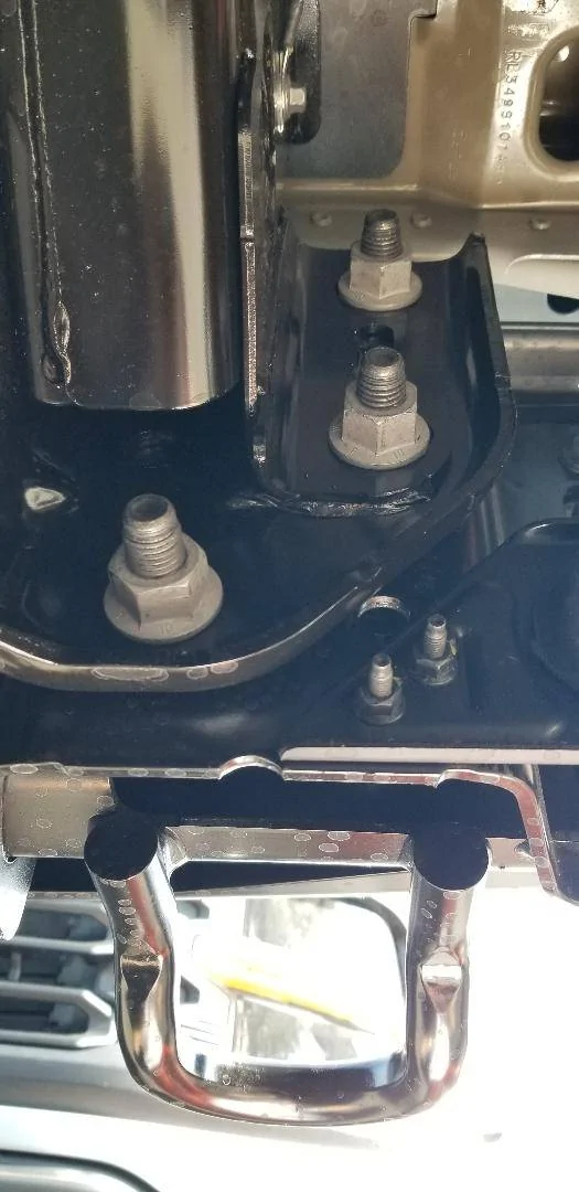

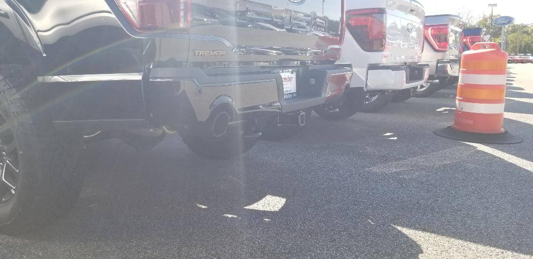

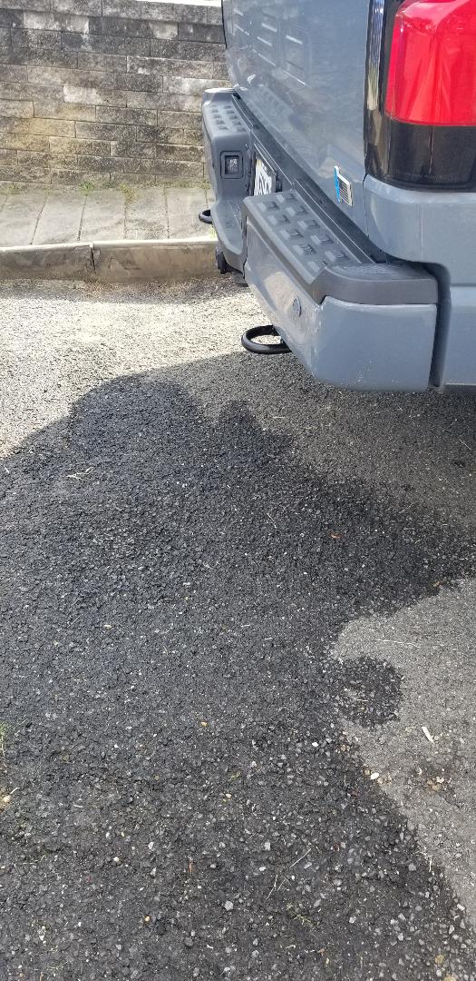

On the other hand, the Raptor's horizontal hitch draw bar will fit just fine with the spare tire in place, because its center section has a nice rearward bulge shape just like the same bar on our Lightnings (see picture #2).
Ford F-150 Lightning Has anyone installed tow hooks, loops or shackles on the rear frame rails? Raptor rear hitch horizontal draw bar

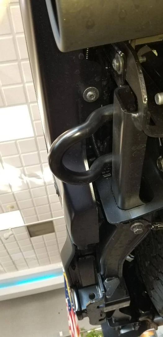

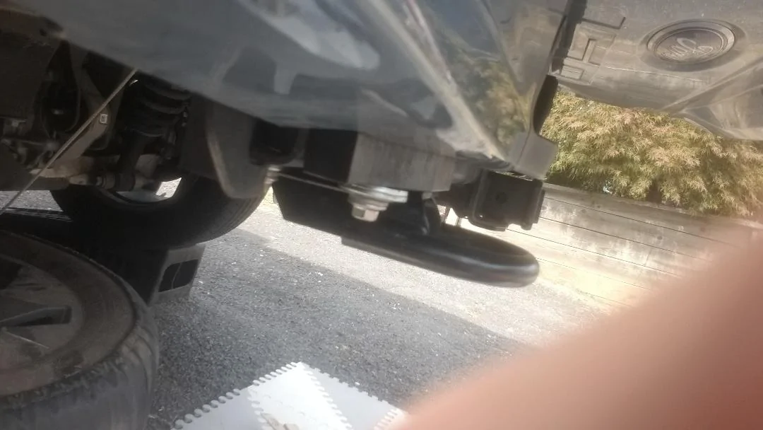

Maybe it's designed this way because the Raptor also has an independent rear suspension with its huge cast arms? Unfortunately, even though this horizontal hitch draw bar will fit, its OEM recovery tow loops are welded onto the top of this bar, vice on the bottom like the Tremor's... and so once bolted on, this bar's recovery tow loops will prevent the Lightning's end cap casings from getting bolted back into place (unlike the Tremor's recovery tow loops which would definitely fit under the bumper end caps with room to spare) unless the Lightning's end cap casing bottoms themselves are trimmed up about two inches in their centers... or unless we swap them out for Raptor end cap bumper casings, with the subsequent issues of different colors etc. See Tremor recovery rear tow loops welded under the bar (pictures #3, #4 and #5)
Ford F-150 Lightning Has anyone installed tow hooks, loops or shackles on the rear frame rails? Tremor rear bumper recovery tow loops
Ford F-150 Lightning Has anyone installed tow hooks, loops or shackles on the rear frame rails? Tremor rear bumper recovery tow loops 2
Ford F-150 Lightning Has anyone installed tow hooks, loops or shackles on the rear frame rails? Tremor rear bumper recovery tow loops 3

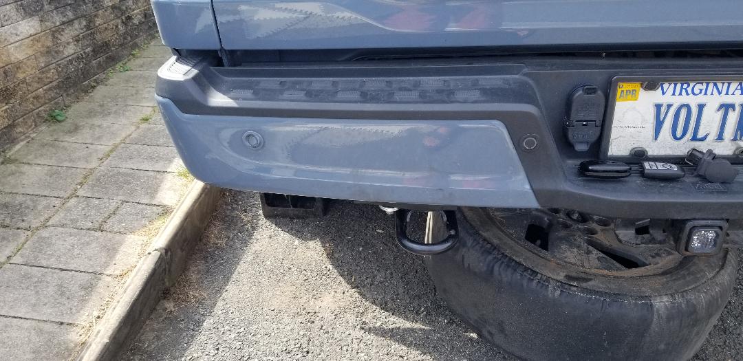

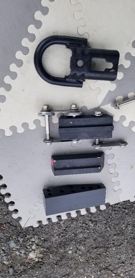

and Raptor recovery rear tow loops welded on top of the bar (pictures #6 and #7).
Ford F-150 Lightning Has anyone installed tow hooks, loops or shackles on the rear frame rails? Raptor rear bumper recovery tow loops
Ford F-150 Lightning Has anyone installed tow hooks, loops or shackles on the rear frame rails? Raptor rear bumper recovery tow loops 2
I personally will prefer to keep my full-size, full-function spare tire right there underneath the truck bed, so I'm now leaning toward trimming my rear bumper end cap casings where needed, with radiused cuts on every turn and corrosion protection on the cut steel etc. Too bad that Ford chose to weld one set of recovery tow loops onto the top and another set onto the bottom of practically identical tow bar components.

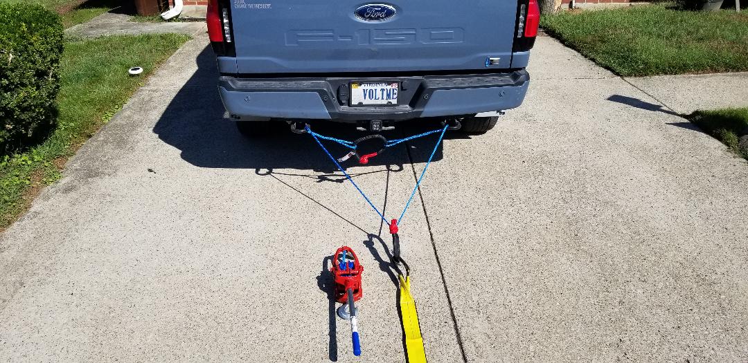

If I understood the parts discussed earlier, your tow loops are still welded to and are apart of the draw bar. If that assumption is correct, then really the forces applied to the truck are still going to transfer to the frame at the draw bar bolts. By all means do this swap and document it for us, but I wouldn't do it thinking you will be able to put a substantial more amount of force on the tow loops that your adding instead of 2inch reciever with shackle. Your failure point will still be the draw bar bolts shearing off or if they hold, a bent frame, hitch reciever, or draw bar.
Agree... but I note there'll be two separated attachment points rather than one such point. Especially with a More Power Puller come-along and snatch pulleys, and if the other vehicle or my Lightning is (are) pulled at a horizontal angle. Distribution of force instead of its concentration is an inherent advantage, right?
BLUF: I shake my head at Ford Corporate's sometimes-seen chintziness in little stuff like this issue. I mean, our Lightnings are pretty and all, yet they are still basically a truck, right? so they should be set up to do truck things that a sedan wouldn't be set up to do, but that pretty much all other F150 are set up to do.
BLUF: I shake my head at Ford Corporate's sometimes-seen chintziness in little stuff like this issue. I mean, our Lightnings are pretty and all, yet they are still basically a truck, right? so they should be set up to do truck things that a sedan wouldn't be set up to do.
Adding these Tremor-like rear tow recovery loops at the factory would have cost, what... $1.99 or so over the whole annual produced fleet, or some such tiny amount.
I had time in the Army's armored force and remember pulling our M1A1s out of stuck spots, sometimes with another M1A1 because that's what was available. I also remember the one time we could only get to one recovery point on a stuck tank because the frozen mud was THAT deep, and the resultant failure of that recovery point (yes, at night in the snow on Nightmare Range up in the mountains of South Korea - optimal Winter conditions for the event's memory to remain with me for life :wink: ). As the company commander I sure learned some good lessons from grizzled Armor and Maintenance NCOs on the wisdom and preparedness for the one event that "will never happen" haha. And on the mechanical advantage of having two good recovery points instead of one.
This anecdote only partially applies to our Lightnings... nonetheless, I do expect to pull out & be pulled out at some point in the truck's life. Hence, my search for two rear recovery points.
