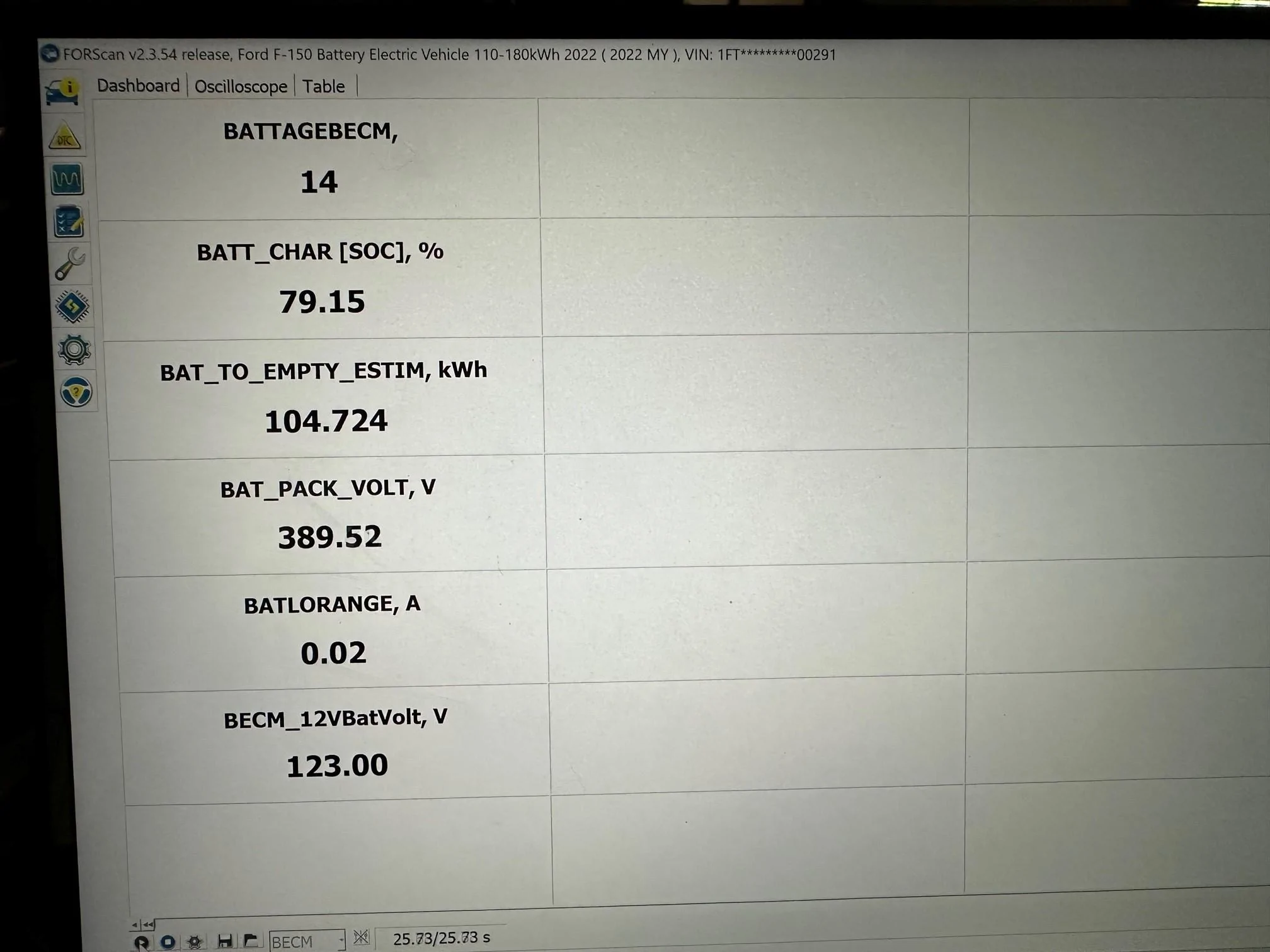

I hooked the lightning up to Forescan and at 66% SOC unplugged the pack voltage was 377 volts (truck on, AC on, stereo on). While fast charging to 90% the pack voltage was about 393 volts (truck on, AC on, stereo on).
Are these voltages low for a lightning? Looking to see what other have seen with Forescan or Car Scanner.
I'm going to see if Forescan will let me connect with the truck off.

At 82% SOC with the vehicle off and unplugged the pack is at 389.52 volts according to Forsan. 96 cells x 4.035 vpc = 387.36 volts (I figured out the number of cells and the 4.035 vpc from the Ford dealer battery teardown video)
So I believe my pack voltage is normal. That still doesn't rule out any bad cells. I won't know for sure until my dealer scans my truck or I can figure out if there is an OBDII scan tool that will show individual cell voltages.

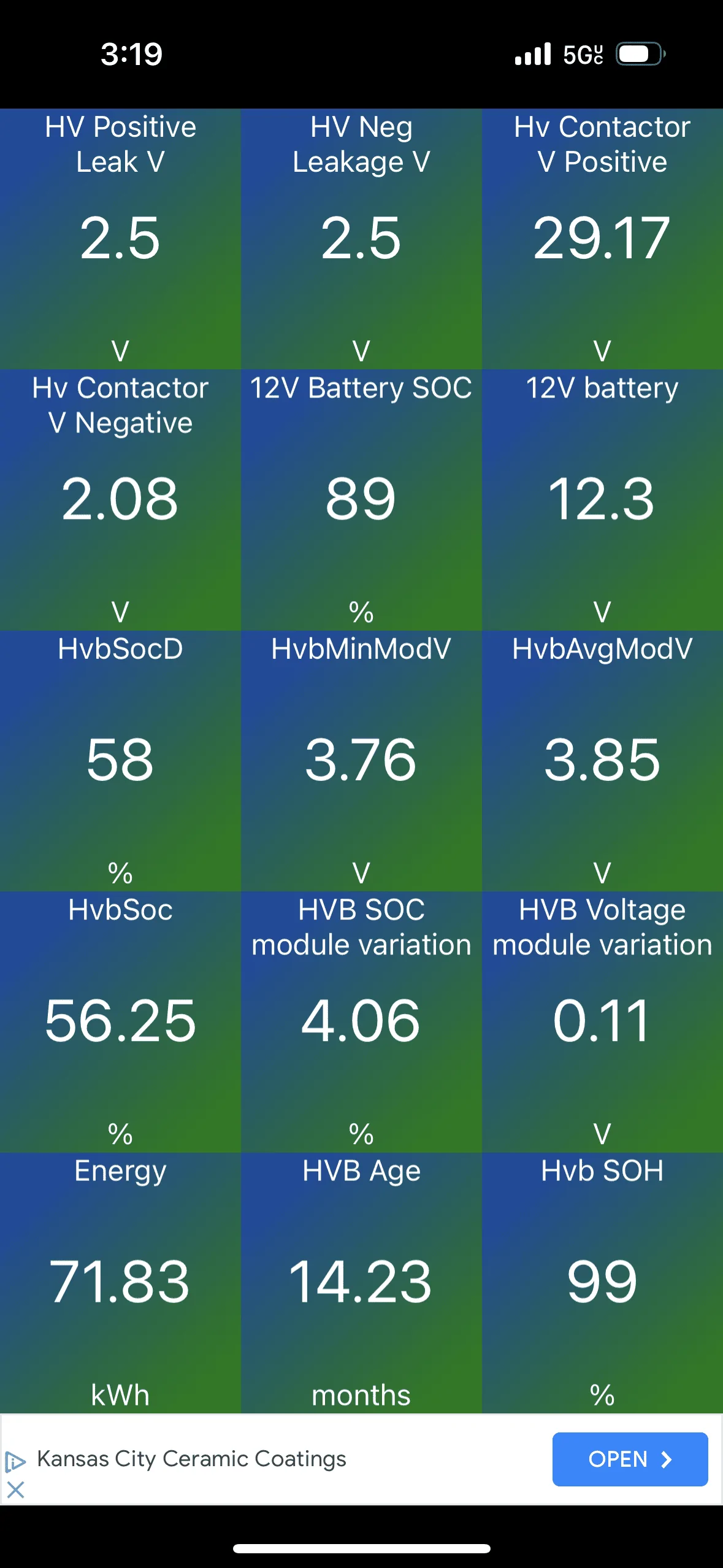

Thanks. I charged to 100% this afternoon. At 92% SOC the battery jumped to 100% and charging stopped. Car Scanner had the HVBSOC at 88.3% Same think happened yesterday at the EA fast charger. And when I drove the SOC dropped from 100% (dash SOC indicator) to 92% within a tenth of a mile. I assume this is abnormal and caused by the module Ford wants to replace.
I drove the truck for 104 miles averaging probably 73mph and returned home with 58% SOC (dash SOC indicator). Trip efficiency was 2.0 mi/kwh. The HVB Voltage module variation on Car Scanner showed .11 volts when I arrived home. It stayed below .09 for most of the drive. The navigation arrival SOC estimate was spot on.
Tomorrow or Sunday I'm going to take the truck to 10% SOC and then fast charge it. If the voltage variation doesn't go much higher than .11 I think I will trust it to make the trip. It is performing just fine.
I asked the Ford rep to schedule my module replacement for 7-24
Thank for all the great info.
Check what HvbSoh (State of Health) says. If you grab the dbc files from the Mach E forum, you should be able to see it. HvbSoc and HvbSocD will not match for the most part...you need to hit the one spot where they cross over for them to agree.
From my years of testing cells, modules, and packs, there is an elevated resistance somewhere in the pack that causes the jump from 92% to 100%, usually isolated to a module, or a cell imbalance.

Thanks MickeyAO. Car Scanner shows 99% SOC as you can see in the attached photo. Not sure what dbc files are. Do the mach-e guys use those to see individual cell voltages?

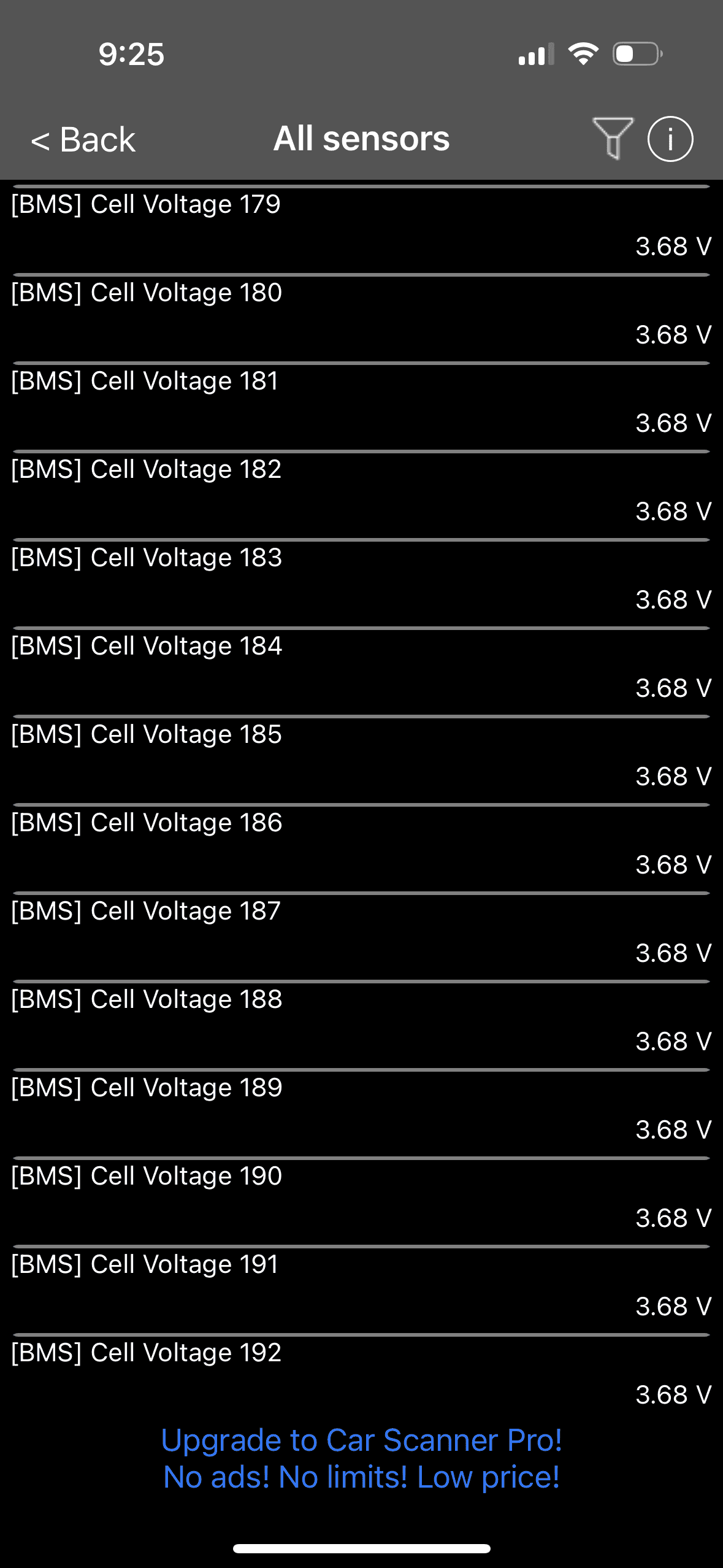

I ran Car Scanner on our Ioniq 5 AWD and all 192 cells are shown as sensors and every one is at 3.68 volts.
So can a dealer see cell voltages through the OBD2 port or do they have to connect directly to the pack to see them?
Ford F-150 Lightning Help please.  Do I have a battery problem? 34
Ioniq 5 scan:
