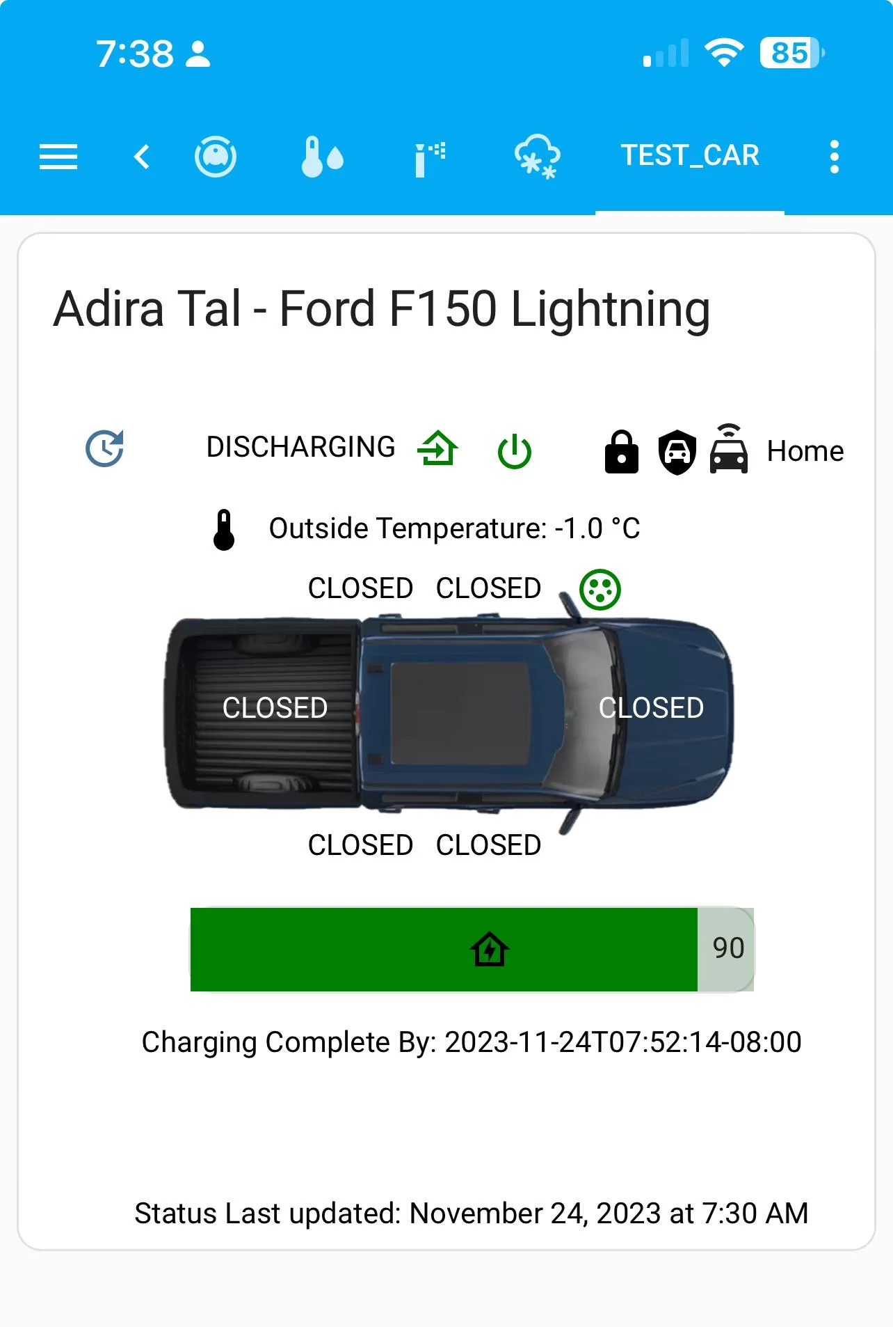

I spent some time yesterday playing with Home Assistant and the FordPass-HA integration, and with a little playing, I've ended up with quite a usable start for a custom card for my Home Assistant Dashboard.
I would LOVE to take all the credit, but it's not actually my doing. I basically adapted this card (from a Tesla owner) with the relevant data from FordPass-HA. I also had to make some templates in order to pull the right data out of the right status messages. It's not finished yet, and ultimately, I'd love to make it work with our Home Integration System so that I can record when power is being fed out of the truck and into the house. Now it's working, I need to figure out some logic to fix things.

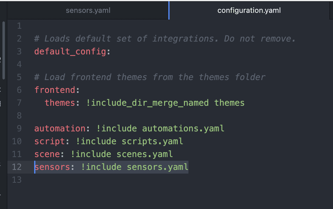

Note: Below is my current code - but it's certainly NOT finished yet and there are MANY errors that I need to go back and fix, including some of the conditional statements (which won't work in HA picture cards unless there's just one main status). Please be patient with my terrible code, and if you're going to use it, know that it will break...

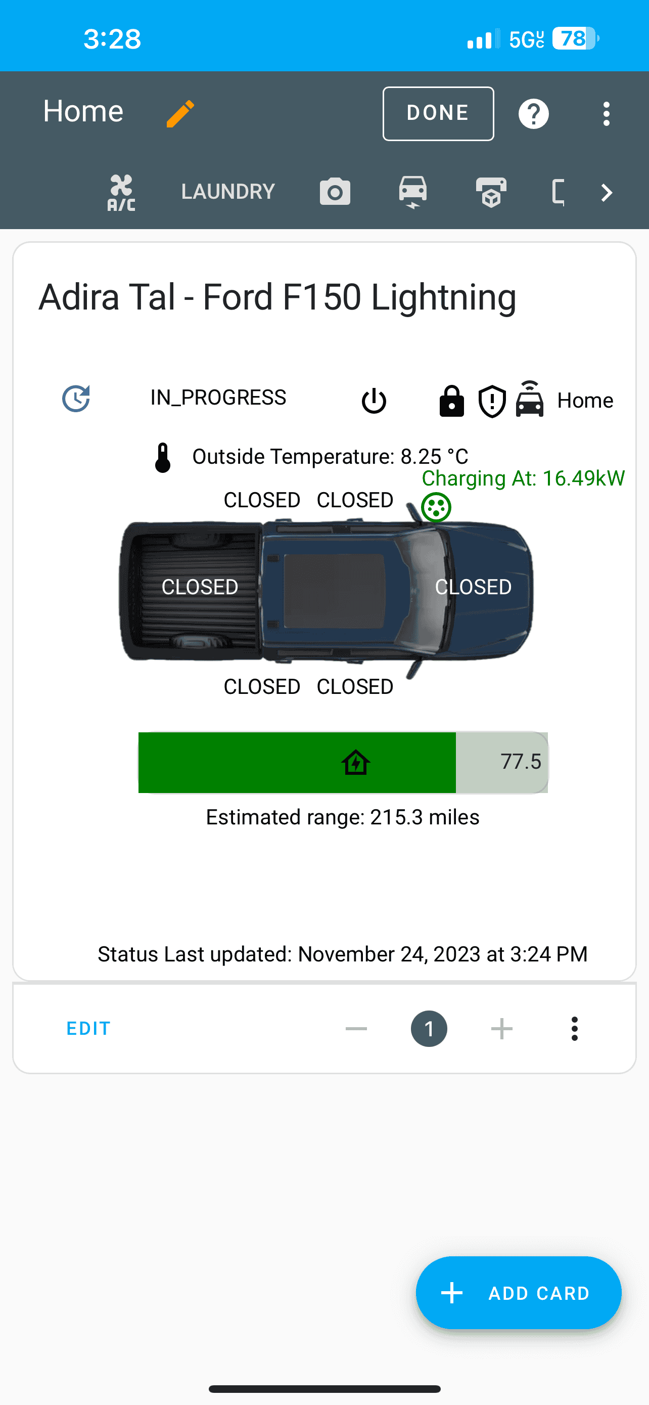

The first image was from this morning, when I was running the house off the truck - but I had to fake the status because I've not yet written the right templates to make it work automatically.
The second one was snapped this afternoon while I was grabbing a coffee while my Vectrix VX-1 charged, (and my wife had just returned back home with the truck from the DIY store). I also know that some of the elements are off - and that's going to be in my ToDo list.
Also in my ToDo: Make a similar card for our Chevrolet Bolt EV (which also has a Home Assistant integration), and eventually, do something similar for my Motorbike (which currently doesn't have any telematics, but I have plans...)

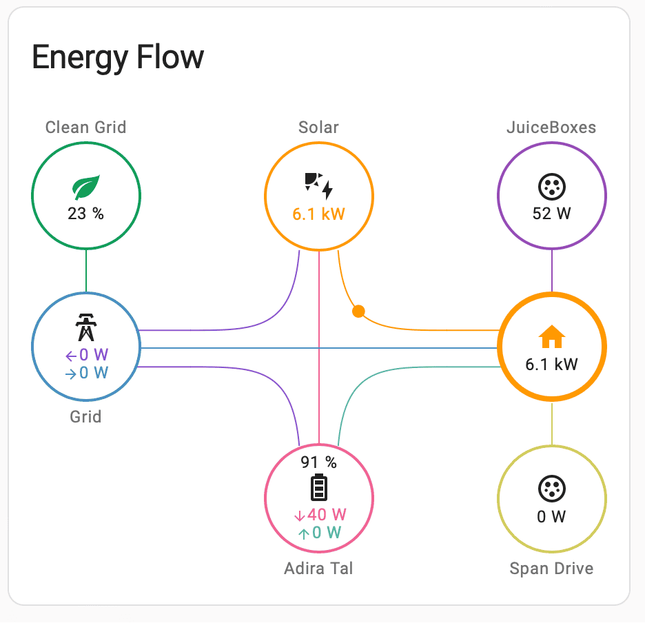

FYI, the THIRD image shows the status of the F150 Lightning battery pack on the Energy Flow Plus card, but again, needs work to be super usable. It is NOT recording power flow OUT of the house, or indeed all the consumption, because we don't have current meters on everything yet, and while I have now found a way to potentially pull data from the Home Integration System's Delta Inverter - I haven't looked into it yet. Based on my knowledge of the Delta invert that's part of the HIS, and reading the manuals for installation, I believe we can use the same hybrid ethernet/modbus setup to pull data from it for home automation. But that's for someone better than me.

        state: IN_PROGRESS
      - entity: device_tracker.fordpass_tracker
        state: home
    elements:
      - type: icon
        icon: mdi:home-lightning-bolt-outline
        tap_action: none
        double_tap_action: none
        hold_action: none
        style:
          top: 65%
          left: 55%
          color: black
  - type: conditional
    conditions:
      - entity: sensor.ford_charge_station_power_flow_template
        state: IN_PROGRESS
        state_not: home
    elements:
      - type: icon
        icon: mdi:ev-station
        tap_action: none
        hold_action: none
        style:
          top: 65%
          left: 55%
          color: black
  - type: state-label
    entity: sensor.fordpass_elveh
    attribute: null
    style:
      top: 74%
      left: 53%
      font-size: 100%
      font-weight: normal
      color: rgb(0,0,0)
    prefix: 'Estimated range: '
For custom templates, I've added the following into my sensors.yaml file (the file where you custom-define special sensors or parse out data from other states as their own sensors).
YAML:
-platform: template
  sensors:
     battery_percent_template:
        friendly_name: "Ford battery charge"
        value_template: "{{ state_attr('sensor.fordpass_elveh', 'Battery Charge') }}"
        unit_of_measurement: "%"
        icon_template: mdi:battery
     12v_battery_template:
        friendly_name: "Ford 12V battery"
        value_template: "{{ state_attr('sensor.fordpass_battery', 'Battery Voltage') }}"
        unit_of_measurement: "V"
     ford_left_rear_tyre_template:
        friendly_name: "F150 rear left tyre"
        value_template: "{{states.sensor.fordpass_tirepressure.attributes.REAR_LEFT}}"
        unit_of_measurement: "PSI"
        icon_template: mdi:car-tire-alert
     ford_left_front_tyre_template:
        friendly_name: "F150 front left tyre"
        value_template: "{{states.sensor.fordpass_tirepressure.attributes.FRONT_LEFT}}"
     ford_right_rear_tyre_template:
        friendly_name: "F150 rear right tyre"
        value_template: "{{states.sensor.fordpass_tirepressure.attributes.REAR_RIGHT}}"
     ford_right_front_tyre_template:
        friendly_name: "F150 front right tyre"
        value_template: "{{states.sensor.fordpass_tirepressure.attributes.FRONT_RIGHT}}"
     ford_charging_power_template:
        friendly_name: "Ford_F150_Lightning_Charge_Rate"
        value_template: "{{ state_attr('sensor.fordpass_elvehcharging', 'Charging kW') | float }}"
        unit_of_measurement: "kW"
        icon_template: mdi:truck
     ford_charge_station_power_flow_template:
        friendly_name: "Charge_Station_Pro_Power_Flow"
        value_template: "{{ state_attr('sensor.fordpass_elvehcharging', 'Charging Status') }}"
Ford F-150 Lightning Home Assistant - Ford F150 Lightning Dashboard. IMG_5254
Ford F-150 Lightning Home Assistant - Ford F150 Lightning Dashboard. IMG_5262.PNG
Ford F-150 Lightning Home Assistant - Ford F150 Lightning Dashboard. energyflow

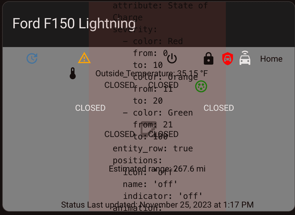

This is way nicer than what I have set up. I have fordpass set up in HA, and know where to add the card yaml but it's giving me an error but doesnt tell me where. I didnt have a sensors.yaml before so I created one and added "sensors: !include sensors.yaml" to my configuration.yaml. Is that the correct thing to do?
Ford F-150 Lightning Home Assistant - Ford F150 Lightning Dashboard. Screenshot 2023-11-25 at 1.29.31 PM
Ford F-150 Lightning Home Assistant - Ford F150 Lightning Dashboard. Screenshot 2023-11-25 at 1.30.08 PM
Nick503955
Nick
Aug 31, 2022
124
105
San Diego, CA
2023 Ford Lightning Lariat, 2024 Kia EV9
Sounds right. I followed this video's instructions on adding the custom sensors config include file:
