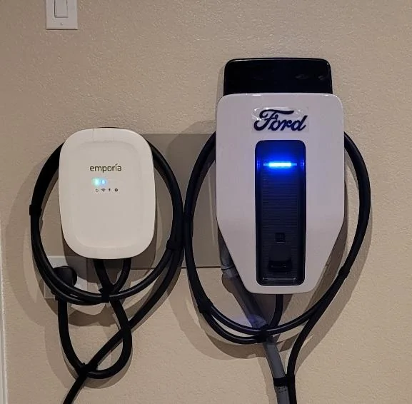

I have both the FCSP and an Empria charger installed. If my truck hadn't of come with the FCSP I would have bought a second Emporia. Great charger, good info on the app and the price can't be beat unless you get an incentive through your electrical provider on another brand.
Unless you need to recover a full battery very quickly the FCSP might be overkill. I have a 6 hour window to charge in my TOU plan and a 100 mile commute. I have my FCSP derated to about 54 amps and have plenty of time to get back to 90% every night.
