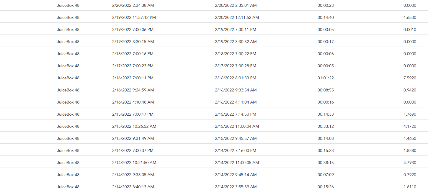

As noted, if you buy an intelligent charger, such as a ChargePoint Flex or JuiceBox, you can not only track charging but download the info. You could also give the employer access to the charging information if they wanted to download it themselves.
My JuiceBox charger has the history to the beginning of time. I have used 794.704 kWh since 8/19 when my charger was installed. I can run a report for any period, so if I wanted to match my electric bill I could (see below).
HOWEVER, note that no app is going to track your electricity cost. I'm on the same meter as my house. Therefore, I would have to take the JuiceBox data and match that up to my monthly electric bill (since the unit costs vary over time). I suspect you could show the bills to an employer, and have them say "you are always paying 12.5 - 12.7 cents, so let's go with 13 cents per kWh and you let us know if your bills track higher. Keep in mind that the unit cost is likely broken into 5 - 8 components on the electric bill. If I ran a report to match my electric bill period, I could then send the bill also and note the unit cost I calculated.
If you had a separate meter, it would be easy. But you'd likely pay for that with a monthly meter fee in addition to electricity.
Lastly, your utility company MAY provide a discount for buying a certain brand of charger, or a rebate. I got $500.
