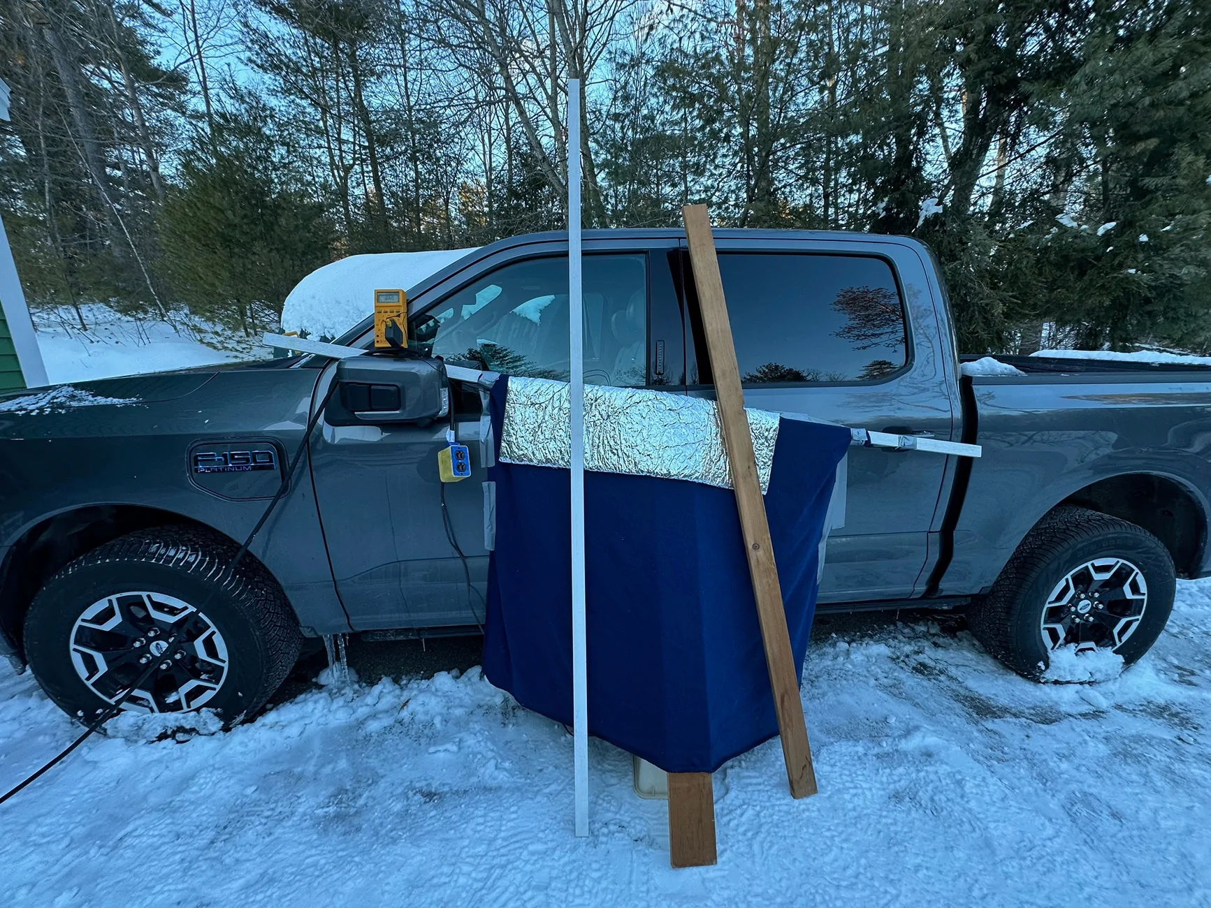

Are you sure the door isn't frozen by ice? can you push on the door and will it flex at all?
Good thought. I tried three things to rule out ice: (1) Hairdyer for 10 minutes, (2) Heat gun with higher temp than hairdryer for 10 minute and then I setup a "tent" with a spaceheater that delivered 80F (measured via thermocouple) for an hour and half. No luck...
