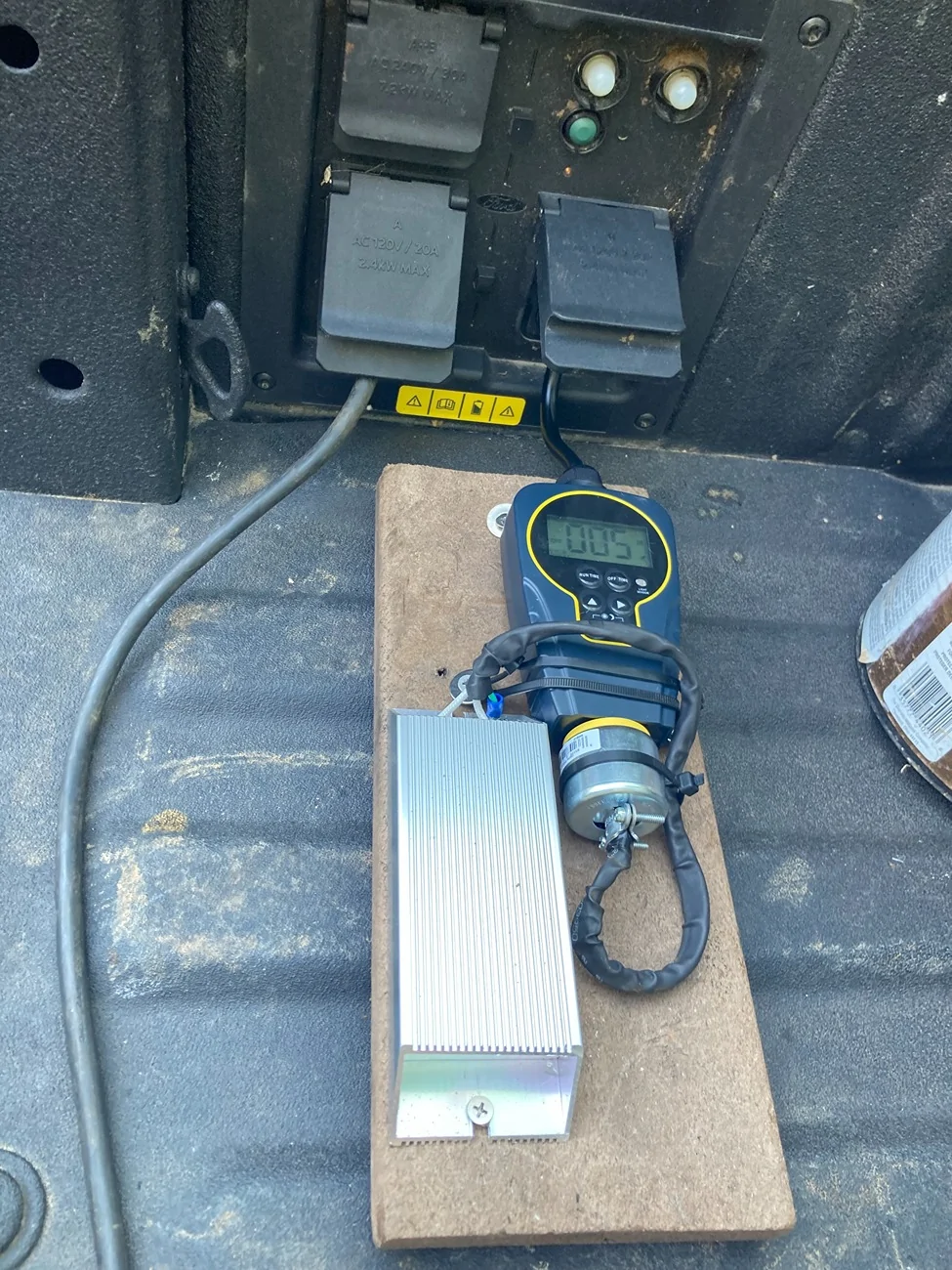

Many Lighting owners have noticed that Pro Power shuts off even when you click the "Keep Pro Power on when Vehicle Off" toggle. It is frustrating when you want to run a cooler or anything that turns on and off. If it stays off for more than 6 minutes, Pro Power will shut down.
The "trick" is to make sure you suck some power to let the truck know you're still using it.
How much power? 90-100 watts minimum.
So you can run a fan or a 100-watt light bulb, etc., but then you're using 100 watts ALL the time you don't need to. It turns out you can put an intermittent load on the Pro Power, and it will stay awake.
How intermittent? Very! Others have had success with various regimens, but my successful experiment was 144 watts for 3 seconds and then a 5-minute rest. Kept the Pro Power on all night and used very little juice.

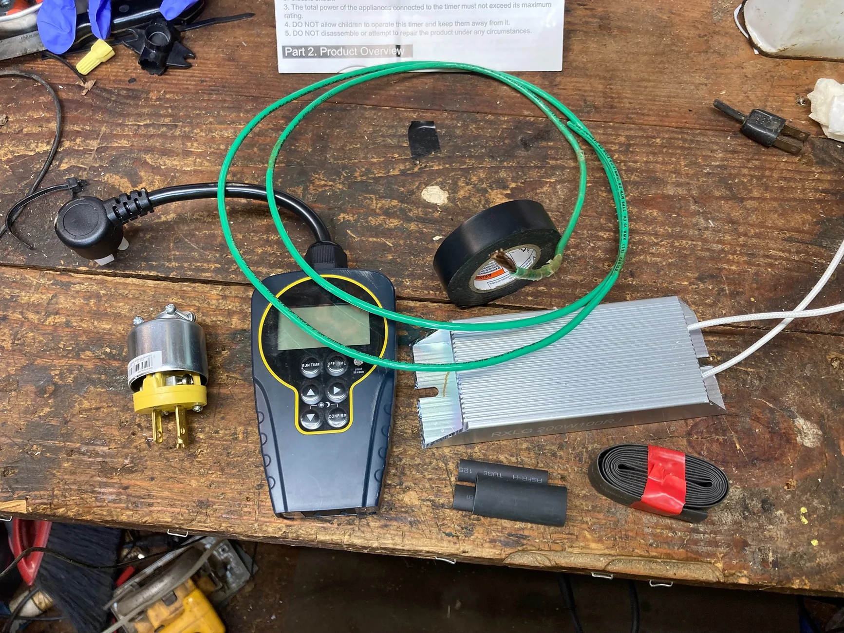

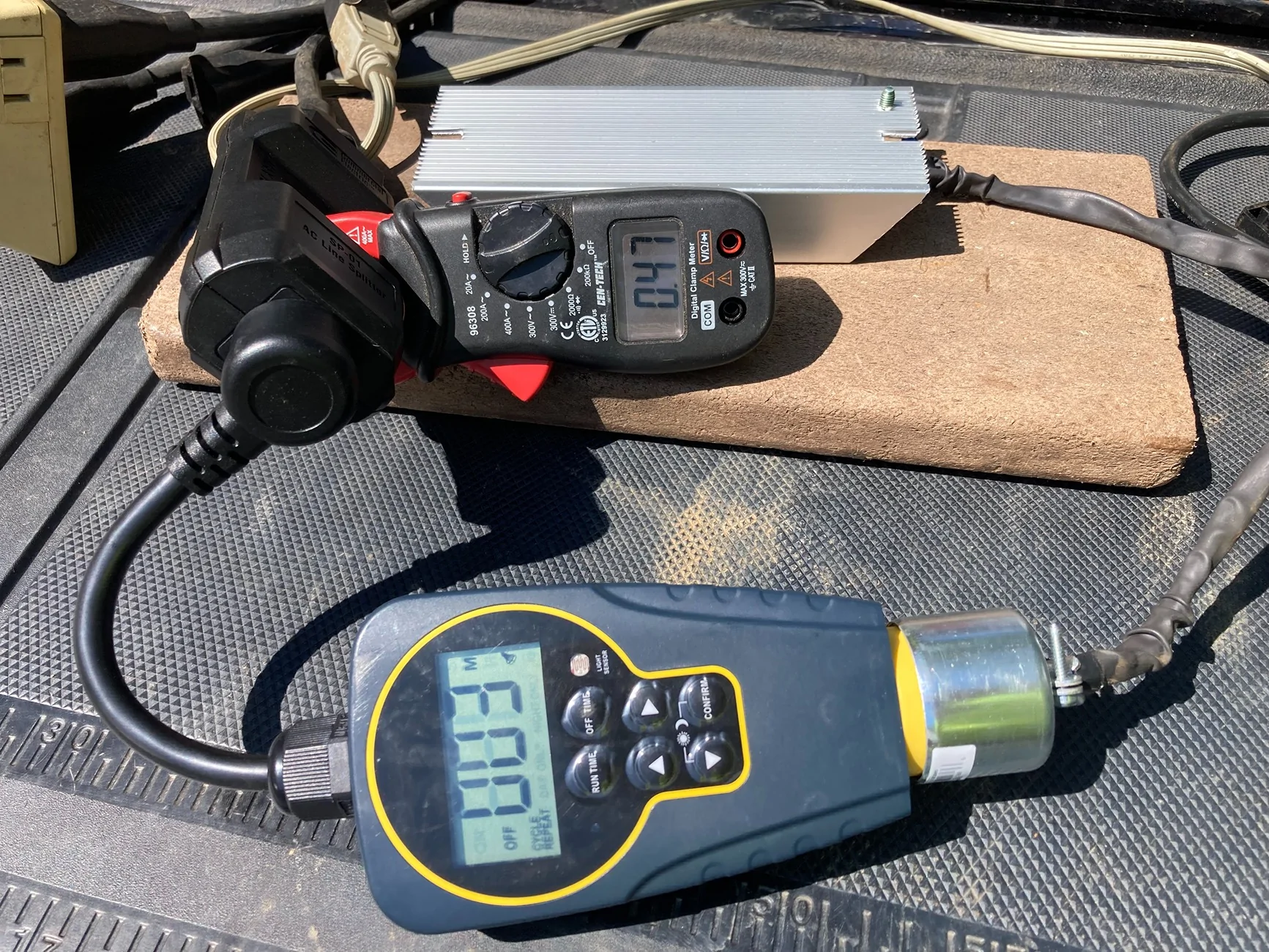

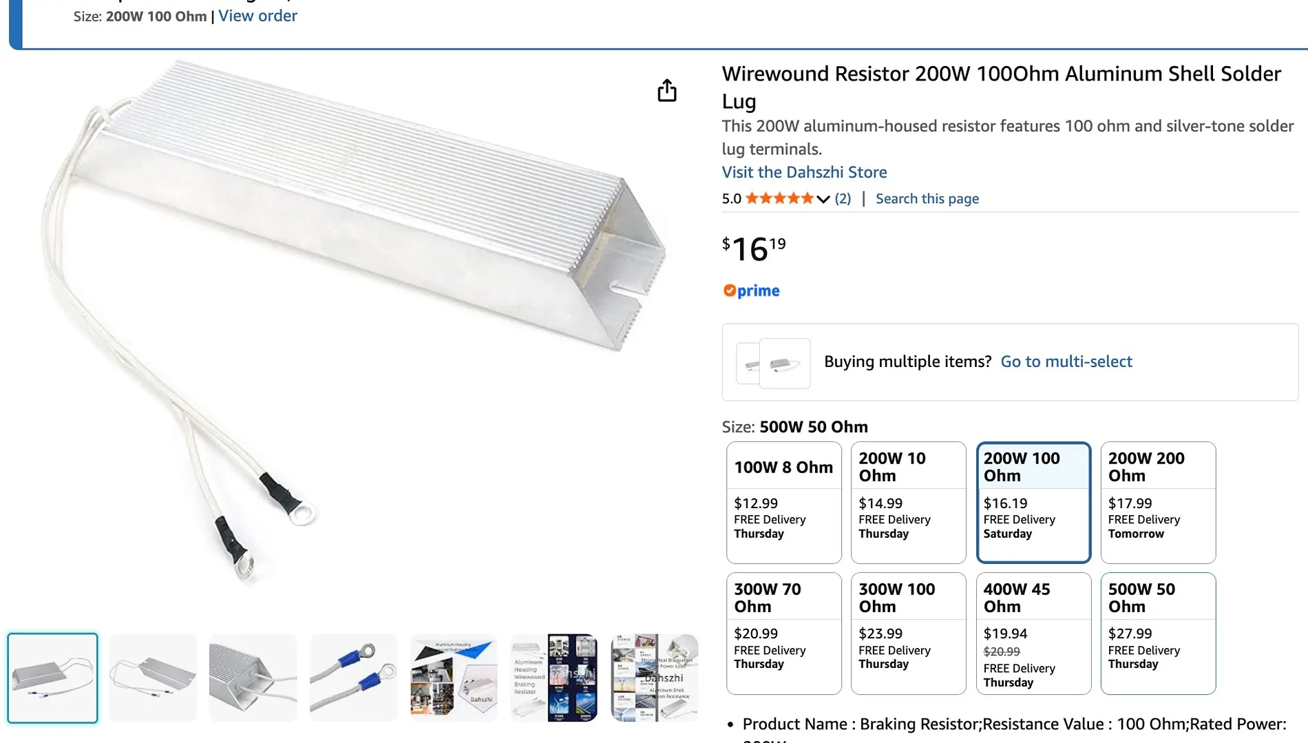

I was worried about the heat generated from a light bulb or a heat lamp, so I did some math (Ok, I had AI do it, but I confirmed) and discovered a 100-ohm resistor will consume 144 watts if fed 120 volts. Note you have to get a resistor that is rated for MORE than the watts you want to run to it. This is a 200-watt-rated resistor getting 144 watts. I put the whole thing together, measured it with a clamp meter, and it was spot on.

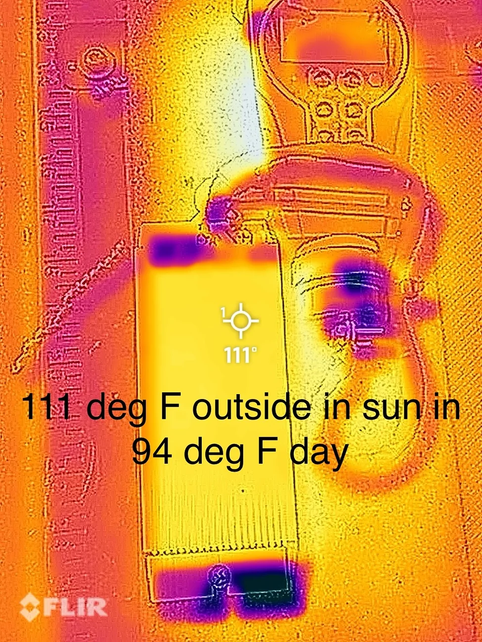

To measure the heat, I used a FLIR camera. It was 94 deg F out, and the truck was sitting in the hot sun. The heat sink on the resistor was warm, but I could touch it at 111 deg F.

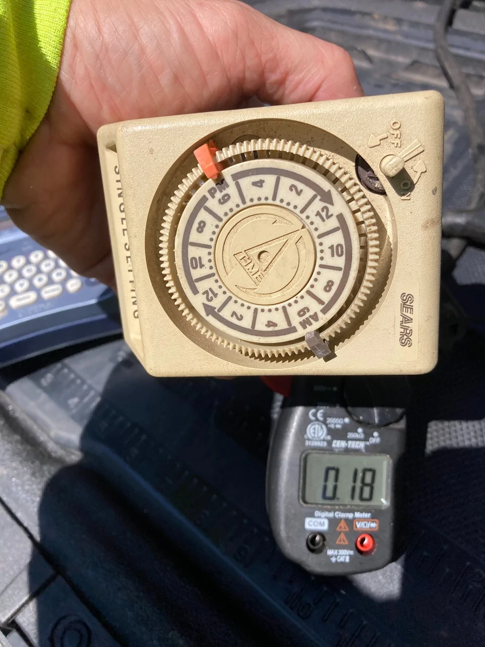

I wanted to see how low I could go on the duration, so I used an old Sears timer to tell me when the Pro Power went off. Indeed, if no draw, it turned off in 6 min. I tried 5 sec on, 4 min off, and that worked. I did 4 sec on, 3 min off, and that worked. I landed on 3 sec on, 5 min off, and that is good enough for me. I believe there is some magic time/watts that must be used every 5-6 min, but I'm posting mine as "good enough" at 3 sec on, 5 min off, 144 watts.
The whole thing cost me less than $40 using some scrap TREX, a few screws/washers/tape/shrink fit tubing I had lying around, and took about an hour to build.
YMMV, but happy coolering!

Ford F-150 Lightning How to make "Keep Pro Power on when Vehicle Off" actually work -- DIY solution Resistor

Your own take and partially homebuilt construction version of what many of us are doing. I'm using the same timer, and a 200W heater with 1 second on and 210 seconds off (220 seconds was reliable, 230 was not, so I padded it a little to make sure it would stay working). With 1 second of on time, the heater essentially never gets even slightly warm, and should I have a need for it, I have a handy 200 watt heater that lives in the truck.

Resistors are rated in ohms with a maximum watt rating. In my case P = V²/R = (120volts)² / 100 ohms = 14,400 / 100 = 144 W which is less than the rated 200 watts.
But I get your point, it is basically a heater. But his one has a nice heat sink and that made me feel a bit better in case, for some inexplicable reason, the timer failed and it was continuously on.

144 watts continuously into a 200 watt resistor will get quite hot after a while. When I set up the heater, I always place it such that the heat wont cause a problem in case the timer fails. Sounds like we both think alike on that part...
