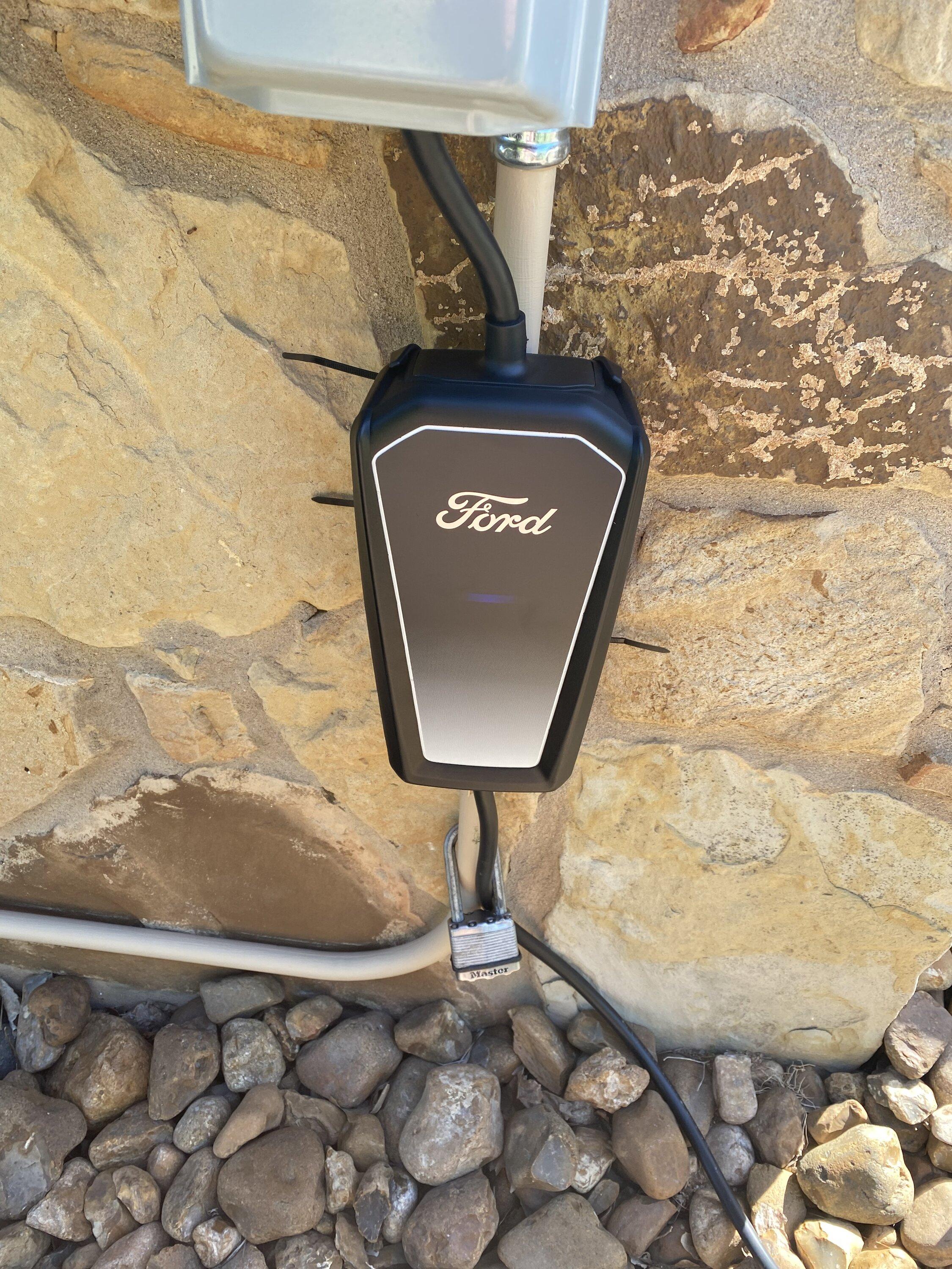

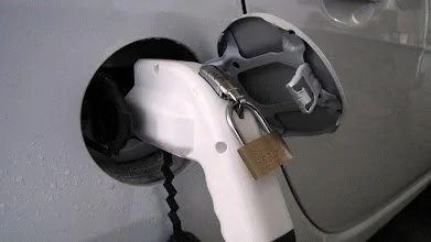

Does the travel chargers have a small lock shackle area ?
I saw lots of them when I was in France - they have chargers on the sidewalks where EV cars can charge. They all had small padlocks near the release button to prevent disconnection or a steel cable was secured to prevent theft.
