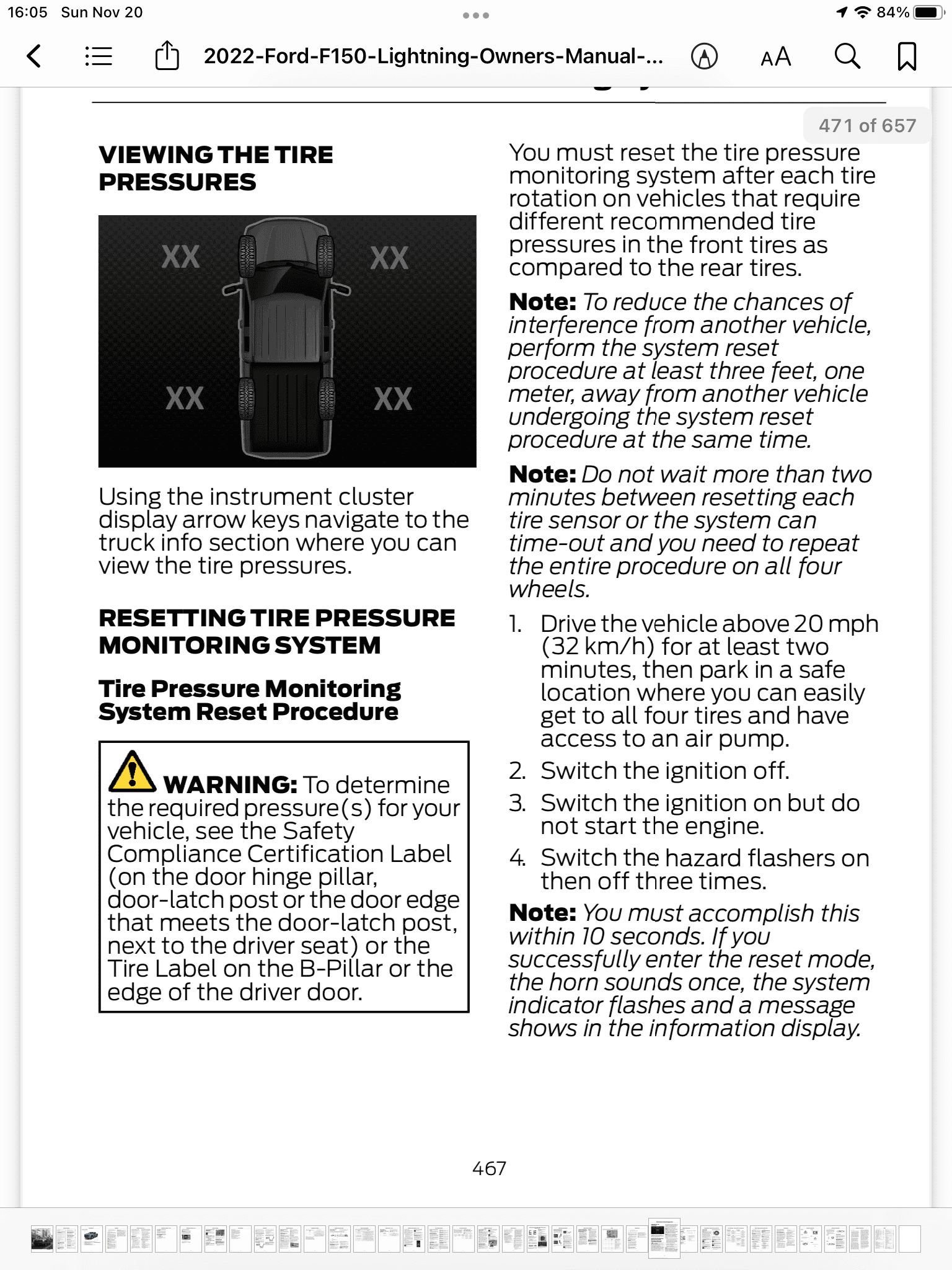

How do I reset the low tire warning?
With cold weather hitting, my tire pressure dropped a couple lbs. One tire was 2 lbs less than the others so I added 2 lbs, and now it’s the same. All have been at 34lbs for a few days but the one tire warning light is still on. On my other cars it just goes off after driving a bit… not in this case.
Can I do anything to turn it off?
