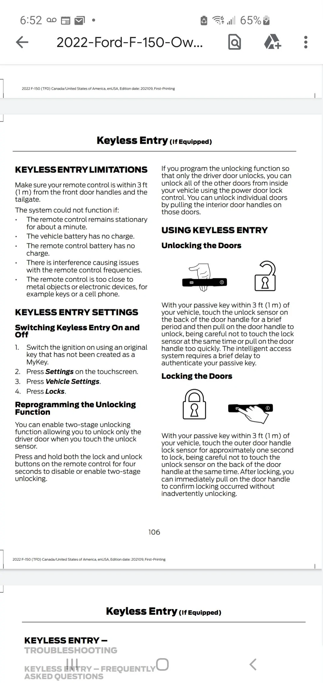

Page 88 of the manual says you can turn off "Keyless Entry". But the steps they suggest (Settings > Vehicle Settings > Locks) does not present an option for turning off "Keyless Entry". Can anyone set me straight on how to turn off "Keyless Entry"?
"Keyless Entry" is when the car unlocks by simply putting your hand inside the handle for 1 second. If you have left your remote (fob) in the vehicle, ANYONE can unlock it by just putting their hand on the handle.
Note that "Keyless Entry" is not related to the "Keyless Entry Keypad". It's something separate. Also, "Keyless Entry" is not related to pressing the "unlock" button on the remote.
I'd appreciate hearing from someone who has figure out how to turn off Keyless Entry. Thank you.
