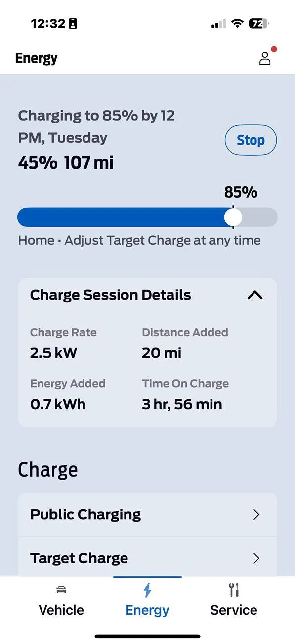

The App, related to charging is a trainwreck. Mine's been charging for 2-3 hours at 2.5kW and it says it's added 0.7kW. Not sure how you screw up simple math, but the Ford App developers have managed it. (missed changes from python 2.7 to 3.x ? Don't know an int from a float ? LOL)

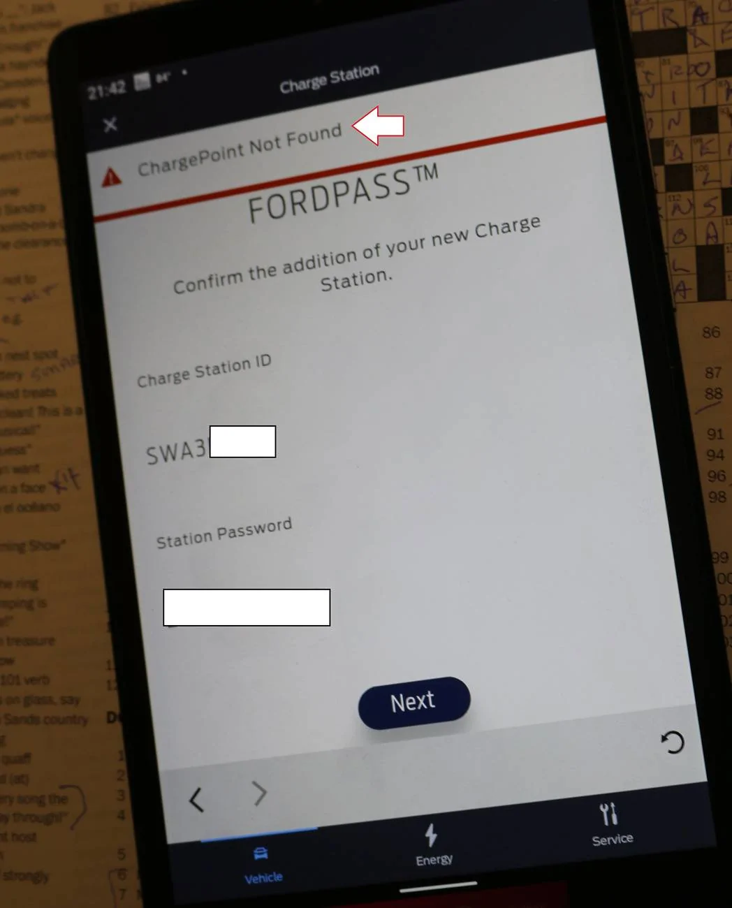

I also am leaving the FCSP in a semi-dumb mode - I never could get it added to FordPass, the last setup step. It at first gave an error "ChargePoint Not Found"
Ford F-150 Lightning I’m leaving my FCSP in “dumb” mode. IMG_5643-connect to FordPass 4-error
But now it gives a different message at the last step:
"Incorrect Station ID or Access Code" even though the setup app had the correct ID and PW and had connected to the FCSP...go figure.
