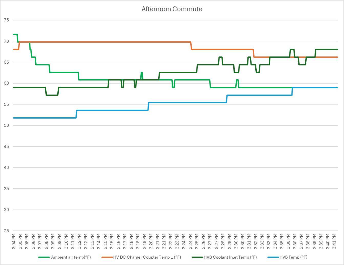

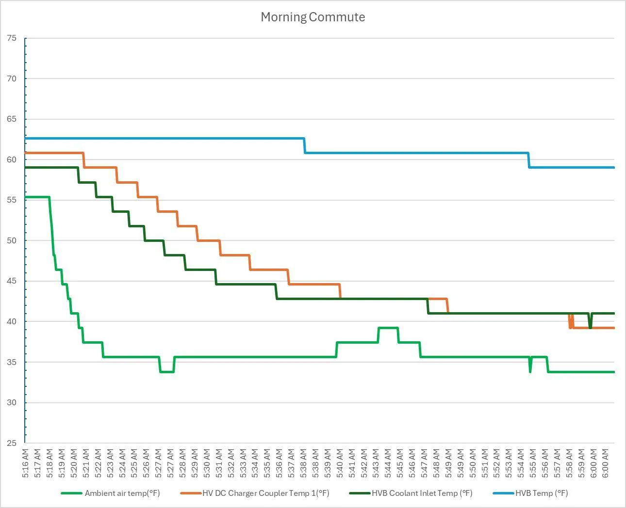

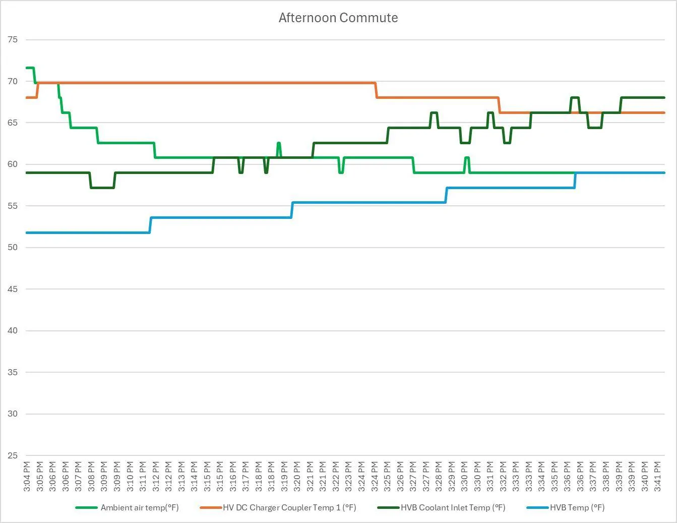

Finally got around to looking at some data I logged
Ford F-150 Lightning I guess I need to be a garlic farmer 1738342008627-v3
Ford F-150 Lightning I guess I need to be a garlic farmer 1738342069906-gs
From what I can gather...the battery held temp quite well from being in the garage over night. I have it set to charge at 11pm and it usually finishes a little after midnight. It seems the battery is actually getting cold soaked while I'm at work? And that's resulting in a drop of Voltage->Lower SoC. I'll try to start tracking start/stop temps and voltages to see if that's the trend as weather gets warmer.
That said, 59F down to 52F doesn't seem like that significant of a drop for 2-3% drop in SoC. Or is it?

That's a large swing in ambient temp. From ~72 down to near freezing at night. Wow!
