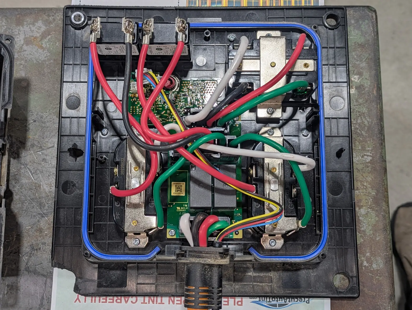

Awesome, Interesting, the GFM3 is the 7.2kW split phase inverter. Your outlet bed box also does NOT have the thermal circuit breakers like the US 7.2kW ProPro Power in the bed. Go into the As Built configuration for both the DCACA and GFM3 and do a save-all. Send the two files to me @ [email protected]
Just for reference if anyone is curious here is the inside of the 7.2kW outlet bed box:
Ford F-150 Lightning Identify ProPower, APIM says 2.4 kw, but 240V available. 1778697397280-mu
Notice how the 240V twist lock outlet is simply the combination of the split phase 120Vs below.

"Notice how the 240V twist lock outlet is simply the combination of the split phase 120Vs below."
yes, as testing has shown that these 4) 120v outlet set, two sets on separate sides of the 240v power, originate from the exact same 240v Inverter at the twist lock outlet, with the Exact Same 30amp 'breakers'/AutoFuses... meaning that while they look like the typical household 15/20amp outlets, they actually have a much higher maximum of 30amps, each...
now, if you are using the 240v 30amp twist lock outlet, at the same time, you are 'sharing' all the 240v power from the inverter, therefore limiting the output potential of each of the 120v outlets....
in any case, you have 7.2kw of maximum power from this power box, whether using the 240v outlet, or the 120v outlets, or the combination of all three...
the outlets in the cab and frunk, though, with this optional 9.6kwProPower setup, are powered thru the original front 120v inverter, and totally separate from these...
if you have, though, only the original 2.4kwProPower setup, the outlet set in the bed also originates from the same front 120v inverter.

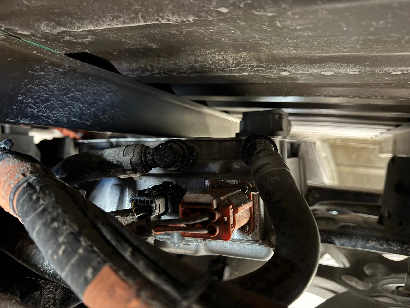

What is this? Under the bed.
hturnerfamily
2,450
3,179
rural Georgia
Owner
rear 240v INVERTER, to power your outlets
On my truck, that is the 7.2kW inverter for the bed outlets, the other inverter, 2.4kW is up front under the frunk tub.
Kinda makes sense. They are just taking a leg from each side. In the past I’ve made that same kind of thing. A 240 outlet “extension” cord by taking a hot from 2 different outlets that were on opposing legs. Sometimes one has to get crafty. 👍
