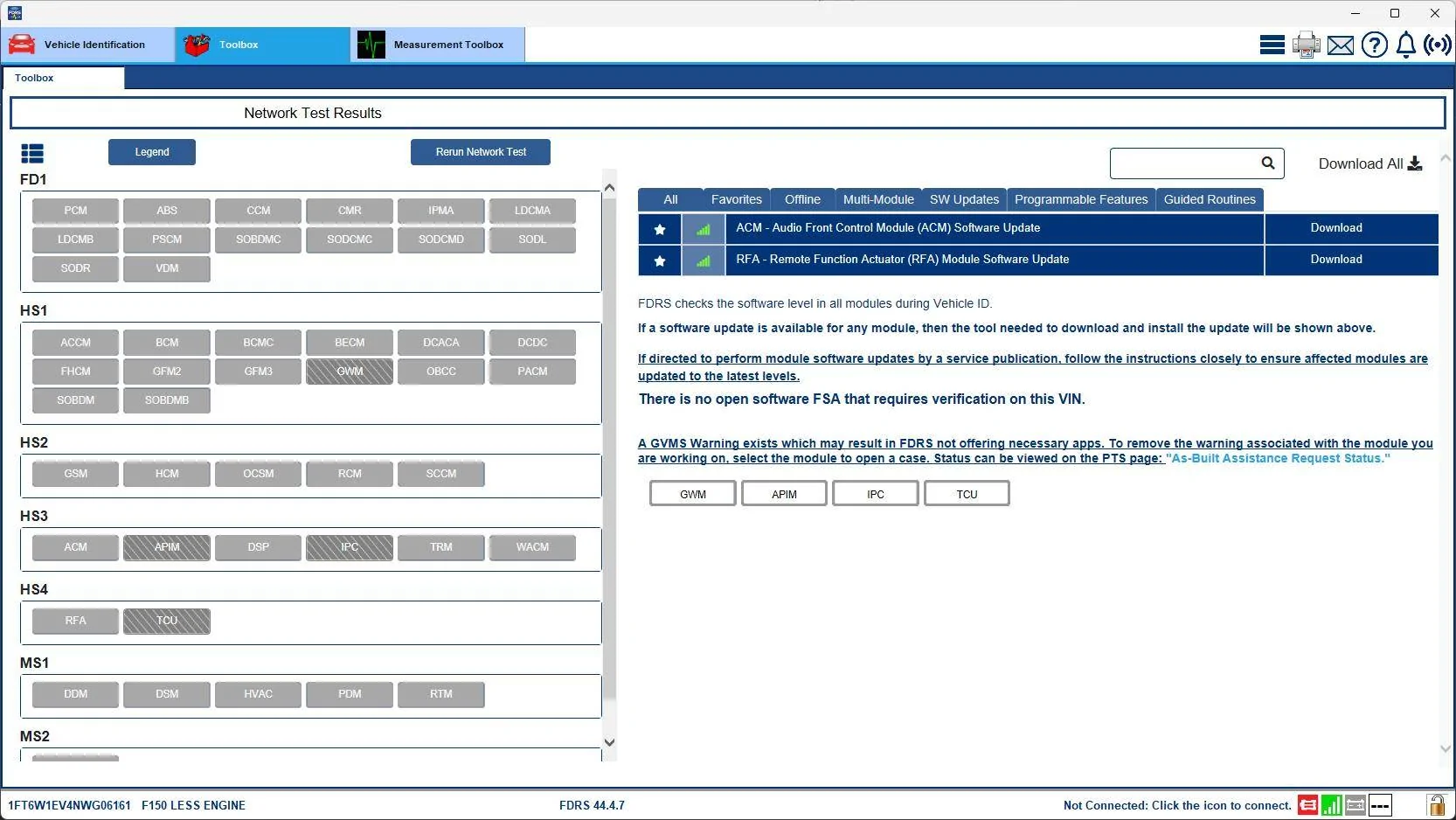

And to add to that.....when I checked FDRS this morning I see that there are GVMS data warnings on not just the APIM, but the rest of the usual 'USB-based update' suspects as well:
Ford F-150 Lightning If your Sync version is at or below 23187 your service tech may not be able to update your truck using FDRS - repairs on hold GVMS_21-Jun-25
Same thing on my Mach-E as well.

I've got the FDRS laptop connected right now, and after the network scan completed...those GVMS data warnings dropped completely off the display without me doing anything at all.
So that's interesting.
