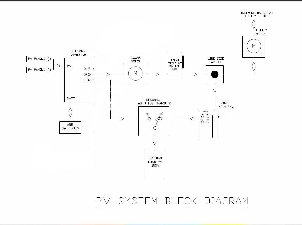

I am having trouble putting all this together.
This is from the Sol Ark 12 owner’s manual:
The system must have Ground connections and Neutral connections. Ground MUST be bonded to Neutral ONLY ONCE in the circuit.
And this is from the Lightning manual:
Grounding Type
Neutral Bonded
The neutral of the inverter generator is bonded to system ground. Connecting loads that also have neutral bonded to ground causes the ground fault detection to trip.
A neutral switch (Generac 6852?) appears to be the safest way to remove the bond to ground in the Lightning Pro Power generator:
The problem I see with that is the same problem for any installation without a neutral switch, the generator in the Sol-Ark 8K wiring diagram bonds neutral and ground at the main panel. As soon as Pro Power senses return current on the ground it will trip the breaker.
There's no code compliant way to get around this. The non-code compliant way to do it is to pull the ground from the power inlet box. I wouldn't do this because I don't understand all of the risks associated with it. I've seen terms like "bolted hot ground fault" and decided it's not worth it.
I have a working system with both a critical loads panel and automatic transfer switch:
Ford F-150 Lightning Incorporating a Lightning into an existing PV system - without HIS PV Power Flows-no AC couplin
But to avoid messing things up and to take advantage of the Sol Ark’s ability to recharge my AGM batteries (260ah) it would seem my only option is installing a neutral switch in the circuit between the truck’s 240v outlet and the connection to the Sol Ark generator port?
