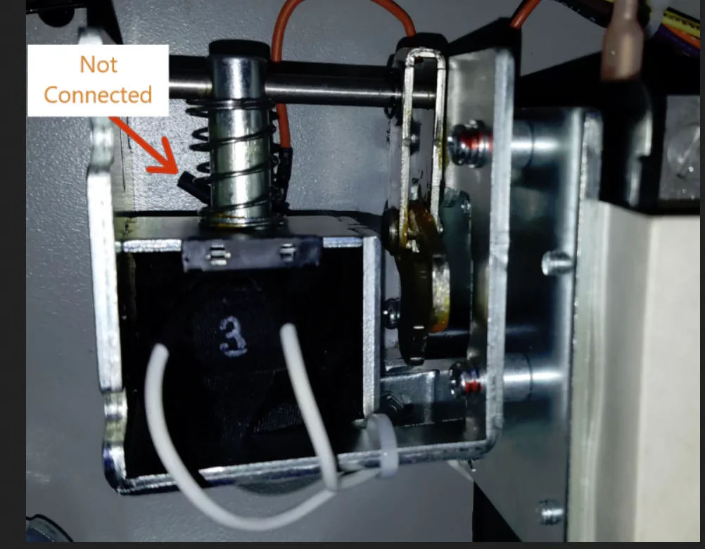

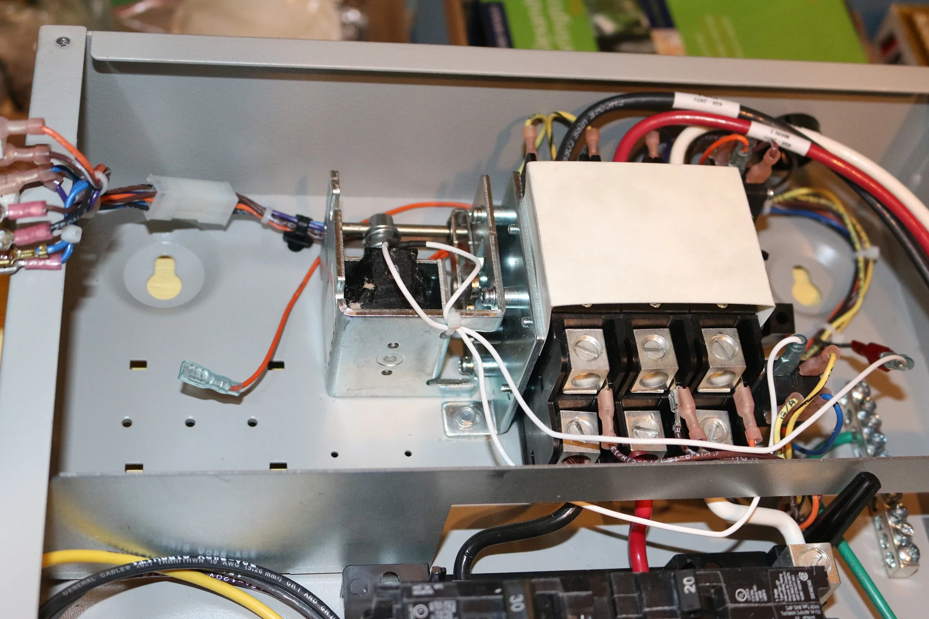

One other thing I just remembered, there was a loose unattached orange wire inside the transfer switch which had me worried, but then I saw on the GENERAC web site that it was a wire that would not be used with the manual transfer.
Ford F-150 Lightning Installed a $1,300 investment to avoid kicking myself in the head if the grid goes down. IMG_5563-unattached orange wir
My switch above - from GENERAC web site FAQs below
Ford F-150 Lightning Installed a $1,300 investment to avoid kicking myself in the head if the grid goes down. unattached orange wire ok
