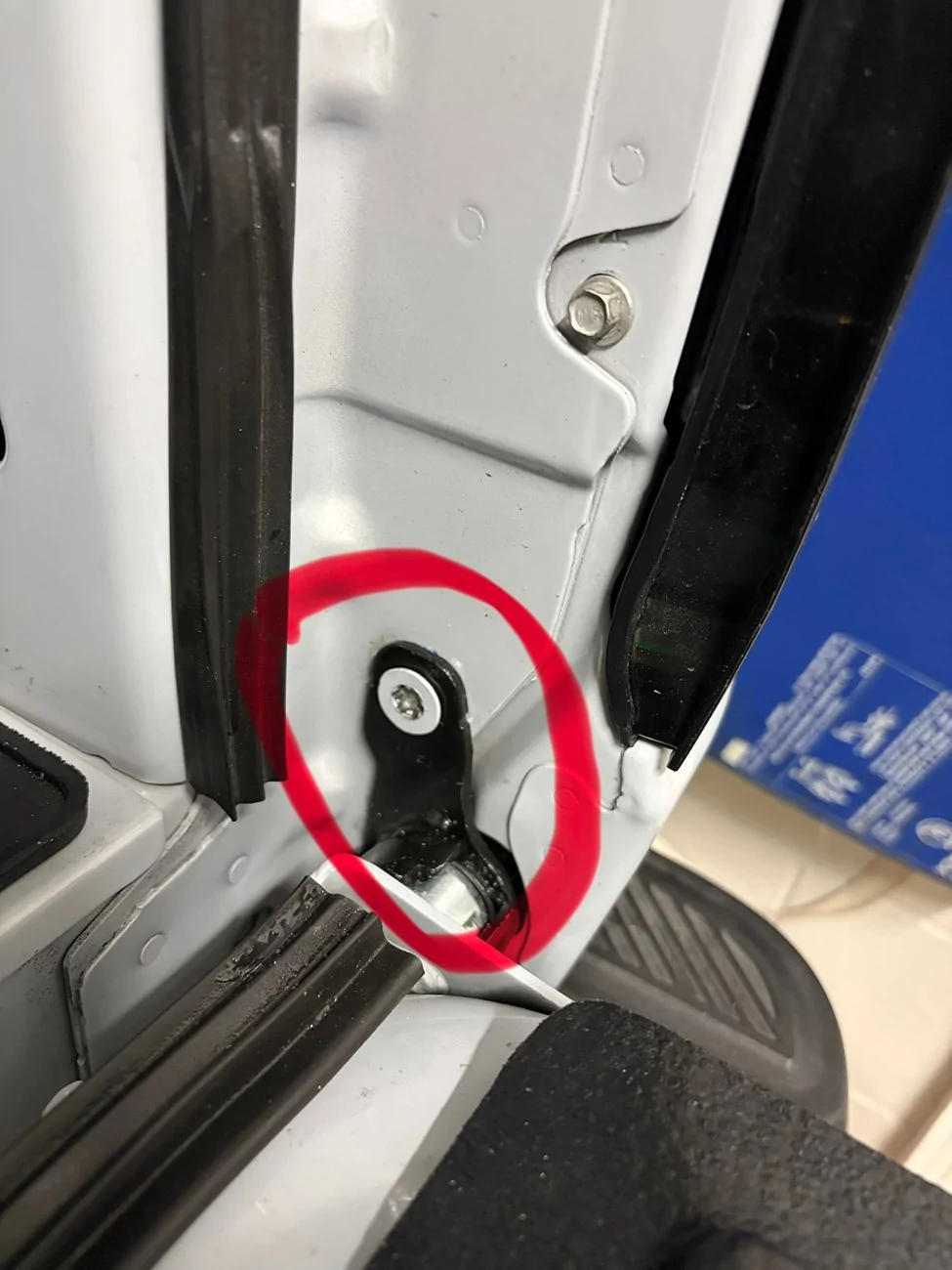

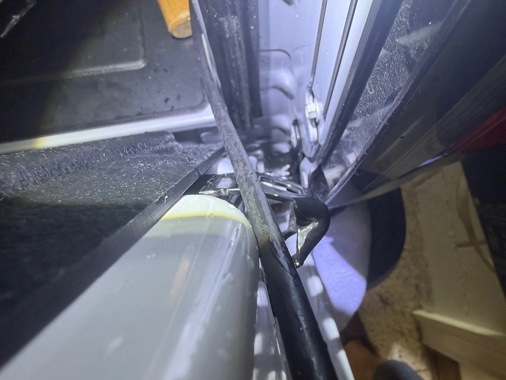

Wow, I was in for a surprise, this was not plug and play like the $37 dampers are, no Sir, remove the right tail light, undo the right bracket, install the new bracket and hide the damper behind the tail light.

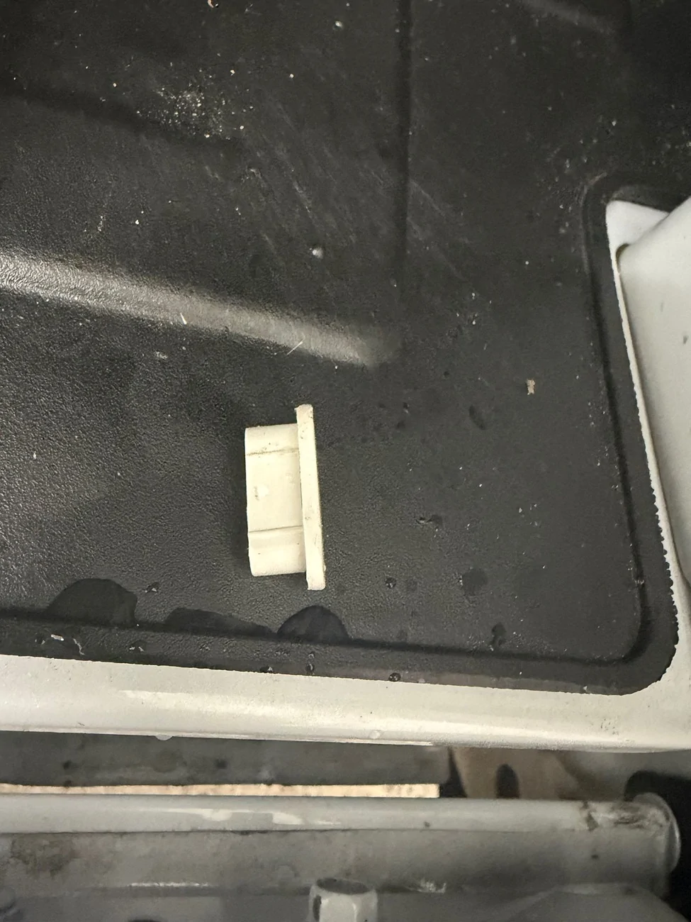

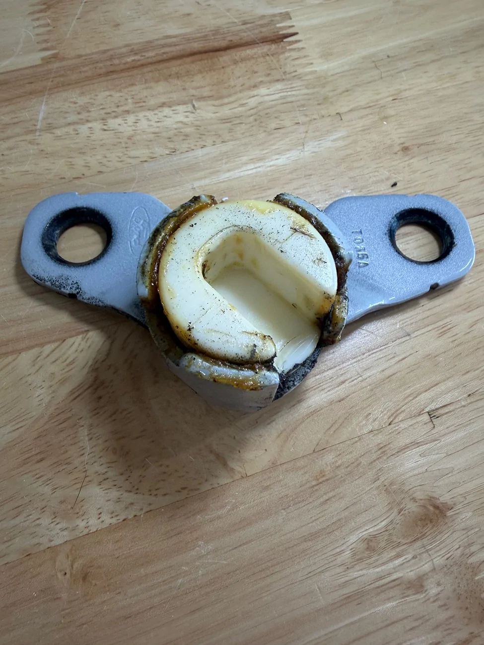

Did all that but didn’t realized a new alignment of the tail gate was needed,, couldn’t figure it out at first, got everything installed and the tailgate was slightly crooked, then the little plug/spacer did fit anymore. (The original bracket had a nylon insert for hinge, the new Ford kit‘s hinge was metal and the insert didn’t fit. )
Nothing in the instructions or the video, one cable was slack (left) and the other side was tight.
The gate closed, but barely, it was almost aligned but not quite. My initial thought was the nylon spacer needed to be there, I was wrong.

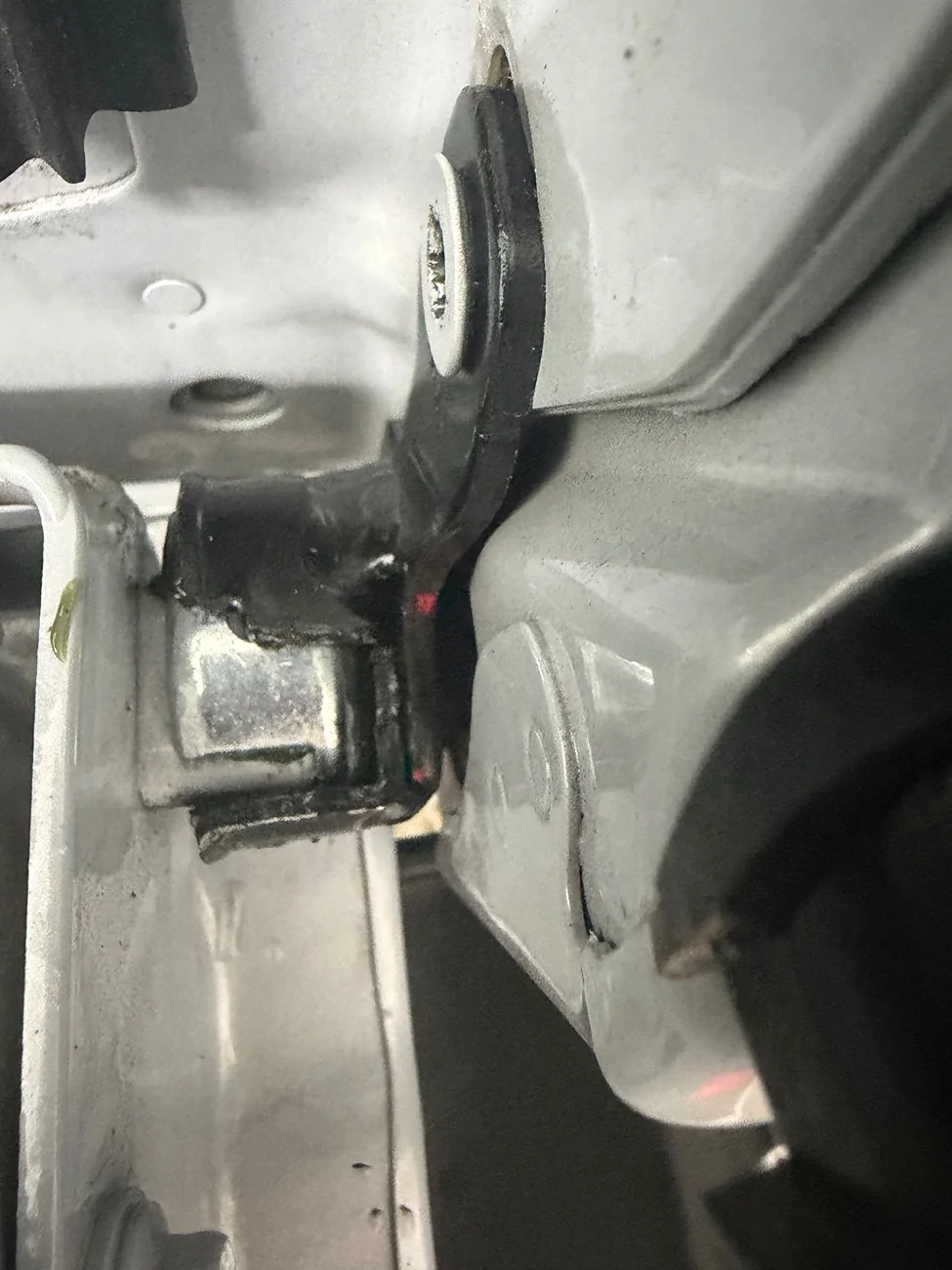

Tried again and again, realized the mounting bracket for the right side was adjustable, took everything apart including removing the tail light and tried again by tightened one bolt but not the other while adjusting to make the tension on both cables the same.
It worked, but it took me 2 hours in my hot garage.

Yeah, I should have spent the $70 as well if I had known, but the actual installation was not bad but something was lacking in the instruction: Do not use the little spacer/plug on the new bracket, it doesn’t fit. Wasted some time figuring that one out.
The taillights removal was the easy part.
I looked at YouTube videos but didn’t see any adjustments of the tail gate, but figured out how to do now. (The right side hinge bracket can move up and down an inch or so and the correct position is somewhere in the middle.)

1) The bolts holding the tailgate bracket/hinge on the right side was in there good with some kind of thread lock and I got a good workout and the Rambo feeling just getting them out, wow..
Had to screw them back in and back out quite a few times to figure out the adjustments. 100 degree garage and I skipped the gym today.
2) The Ford directions was not detailed, but the devil is in the details..
Hint: Before removing the old bracket apply blue tape on the upper end and on the fore-aft bottom end, now you know where to torque it down.
I didn’t and had to redo and redo the installation to make the tailgate flush and perfect.

So, If I outline where the original placement was, will that be sufficient? Or does the added parts change the line up of the tailgate?
The added parts, or rather the new bracket probably and most likely has the same profile and the same foot print as the old one, so yes, use tape or a marker to outline the correct position.
I didn’t as I had no idea the bracket was movable up and down, fore and aft.
My first instal was off and the tailgate didn’t quite fit.
(Long story short but I figured it out, rather low tech but I thought the screw holes were fixed and everything would fall in place. Silly me. The bracket moved around and no indication (s) where it should really be)
