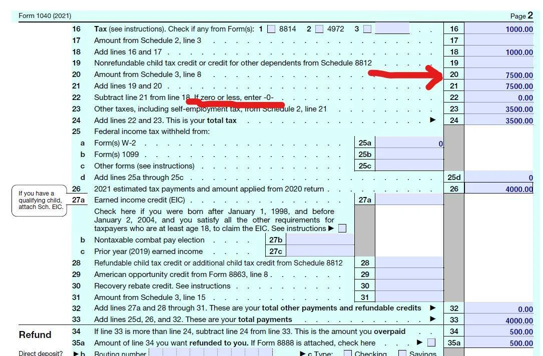

Regarding {LIABILITY} make sure your line 16 is equal to or more than $7500, if that's the case (no need to give us real numbers), then you'll feel the positive value of the tax credit, pay attention to the note on line 22, this is a NON REFUNDABLE credit, that is it can only reduce your income taxes, but NOT self employment taxes and other taxes located on line 23.
This graphic shows how a person with low income tax liability loses out.
You’re absolutely right, and I 100% appreciate the thoughtfulness in your reply. My taxes owed in that line are around ~8k.
I am just a little nervous that I don’t have sufficient documentation to prove the credit.
I’ve claimed the credit successfully before, but the “new” guidelines seem to say that both the dealer and I need to submit. The dealer (my sales rep and finance guy) insist the dealer has/will submit it to the IRS. But nothing on the docs they provided to me confirms that they did…
