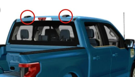

I removed my antenna and replaced it with a stub. I am trying to activate my free AT&T data service and I am wondering if I need the antenna on the fender for that to work. Anyone?
Thanks
2,327
3,250
No, that's AM/FM. The cell antennas are inside the two plastic caps on top of the roof on either side. Driver side is primary cellular. Passenger side is secondary cellular, GPS, and SiriusXM.
Ford F-150 Lightning Is the antenna required for the AT&T data services? 1741620134480-1m

Thank you. It seemed like it would not activate, but I just got the message that is working.
