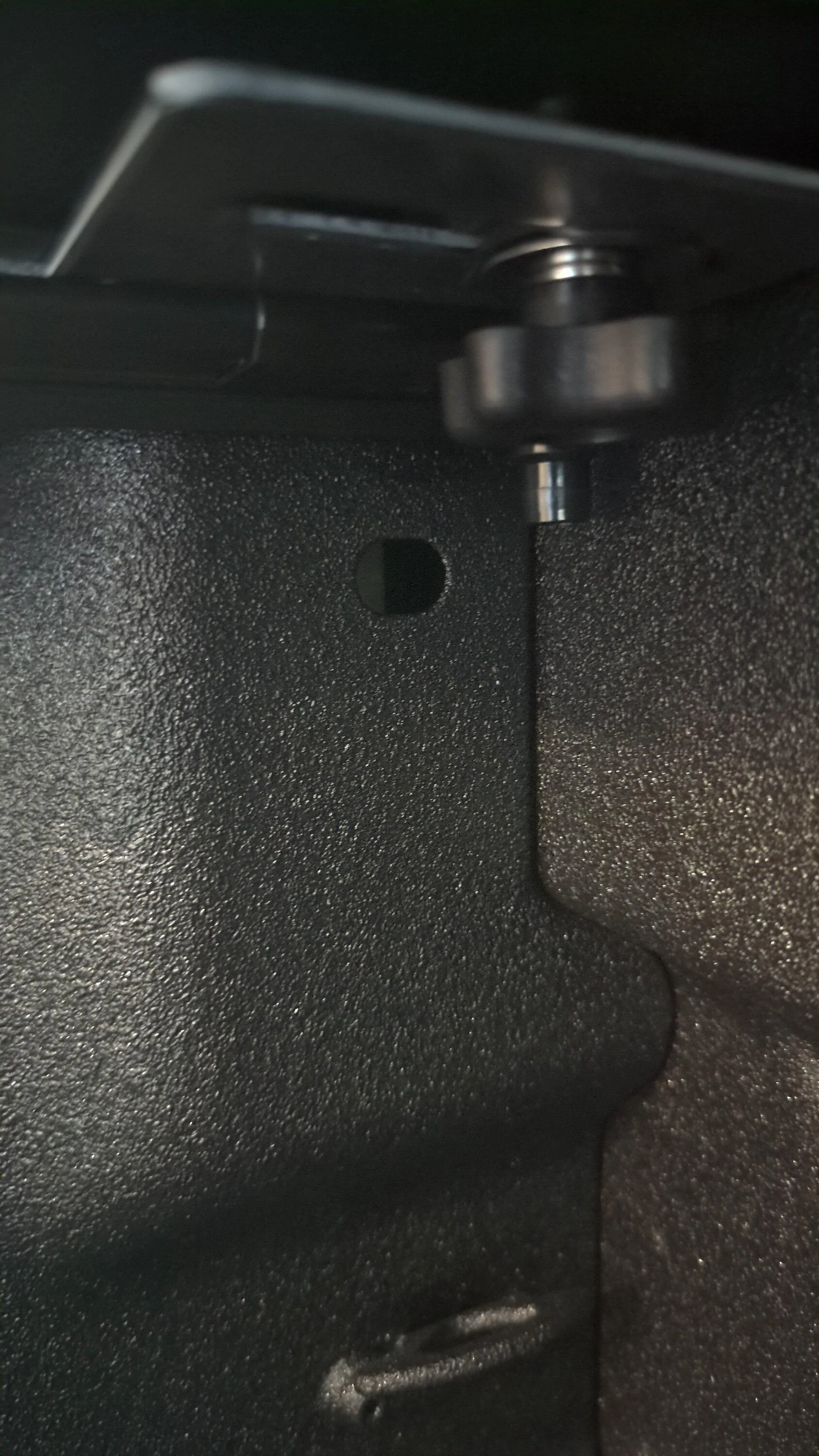

Installed a tonneau today and got a bit confused by what I was seeing. I ended up drilling into the plastic cover at the bottom (which ruined the spray-on liner), but then noticed that at the top, right near the drain pipes, there's a hole.
Is this for drainage? If it is, I'll use those and seek to resolve the issues with the plastic covers/spray-in later...
Thanks

No, that is not the hole for drainage. The round oval plastic covers at the bottom is for drainage, and it sounds like that's where you drilled. I had the same issue with the spray in liner but figured those pieces are plastic so the liner wasn't really intended to protect those anyways. The holes you pictured can be used for other attachments, etc to secure to the bed.

While those holes are not intended for drainage (they’re there to accommodate bolt-in stake pocket accessories), they do seem to drain OK. If they didn’t, the stake pockets would hold water when the top of the pocket is exposed. I ran my tonneau drains into those holes and haven’t had any issues. When I first did this, I figured I could always drill the plastic plugs if it didn’t work.

Mine were installed in those holes from FORD. Figured that's what they were for. No problem with drainage.

Interesting. I am not too sure what to do here. Obviously, the one's near the top are very convenient.
Out of curiosity, for those who used the top holes for drainage - did you cut your hose length? I kept my tonneau's drain pipe length (approx 1.5 feet). Should I cut it or is it beneficial to have the drain pipe go as close to the ground as possible?

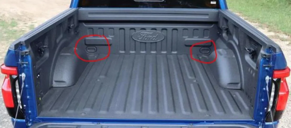

I did an aftermarket bed liner and did not mark where in the oval the drainage hole is for the bed with a tonneau cover is. Anyone know or have an image of the front of the bed so I can better line up my drill holes through the bed liner?

Like for pointing out this hole, just installed mine and routed drain to those holes vs cutting a hole!
