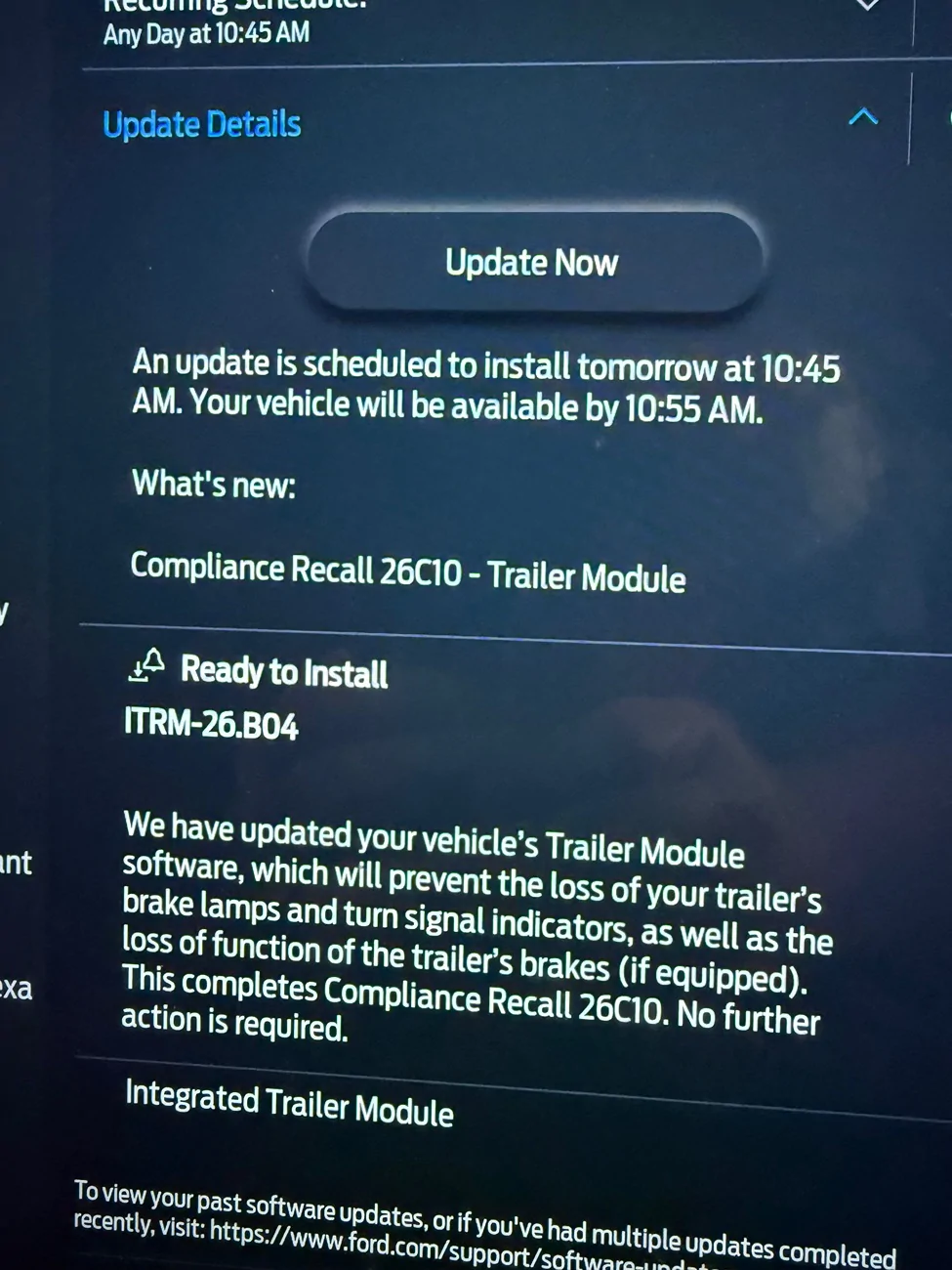

Update - this downloaded for me yesterday, but it won't install. 22 Lariat. I'm EAP, but no email from Ford, so has to be general. The splash screen is updated to say 26, not 25. Although it is downloaded, it won't install. I've hit the update now button 3 different times, I've adjusted the clock to install in about 30 minutes to an hour, but those times pass and it never installs. Maybe sometime later today, we'll see.
This would be a general deployment update, unfortunately something is inhibiting the install, hopefully it'll post at some point.
EDIT thread title to include 26B04, hmmm is this flavor a continuation of general release or testing of revisions to the 25 version!????

Same here. I have a 22 and tried to install it 4 times yesterday. It would go through the process of preparing the update then the Sync screen would just go to the normal radio screen and sit there. I observed all this from outside the truck with the doors locked and keys all far away. I checked and my 12v is fully charged. I other errors reported.

I'm in the same boat still. I disconnected the 12v over the weekend in case other modules needed a good reset. The SW still reminds me each time I turn off the truck. I have a standard daily time set and each time I get out of truck, I go ahead and force the install, but it never does. Another of Fords little life mysteries.

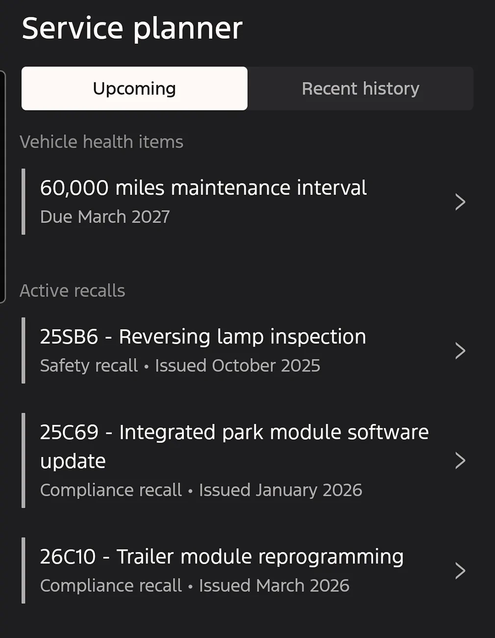

I didn't get that update yet. Although the truck was at the dealership 2 weeks ago for a 50kmiles service and taking care of the 3 recalls I have:
- tailgate lightbar (again). They changed it back last year because it had water in it and was not working anymore. Process took a little while to complete. Obviously this time because of the new recall they checked the install and concluded it needed a new bar (water intrusion + wrong screws or clips i don't recall). Unfortunately the parts are on back order. So no ETA on resolution!
- the 2 other recalls were/are the parking and trailer modules. They told me one of them got done (I don't recall which one and I don't have any paperwork). But I remember them saying one of them is a 8 hours update and I was waiting for the truck on that day. I couldn't leave it there.
All that to say maybe I got the trailer recall done which is why I didn't receive the OTA update??
Either way all the active recalls are still showing in fordpass.

Mine is still listed weeks after the reminder call the service manager to have them "close" the recall work-order, the mother ship still shows it as incomplete.
Had this and the parking done over the weekend, my app shows all recall notifications (including tail lightbar and sunroof) cleared the day after I picked it up. It only shows the 70k service as up coming now.
Apparently my service team is incompetent :sadface:
My two recalls (park pawl, trailer module) are now cleared, within 3 days of service.
