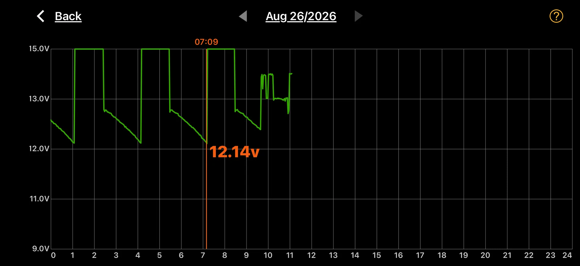

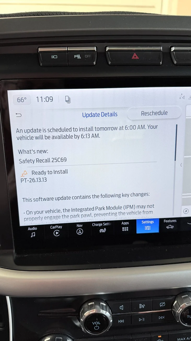

Woke up this morning to a successfully completed update!, Except... Dash went into sleep mode overnight and when I started the truck a warning beep sounded and screen said something like, "Electrical load.... Service vehicle". Truck started anyway and the warning never returned. I suspect the LVB load was pretty high during the OTA. I have included a screenshot below of my battery monitor history showing the graph for recent events. Battery volts dipped to 12.14V several times during the update. I was not plugged in to my L2 charger yet the graph shows the onboard charger kicked in and boosted voltage to 15V a few times. Never saw that before during an OTA. update. I wonder if Ford modified the update software?
Now I have a reminder for upcoming OTA update for the 'IPM' PT-26.13.13 on my screen. (see below) Hopefully it succeeds on the first attempt.
How did you know it completed successfully?
I now show this PT update too but never saw a confirmation the trailer module completed.
I’m wondering if the trailer module timed out. And the PT update replaced it.
