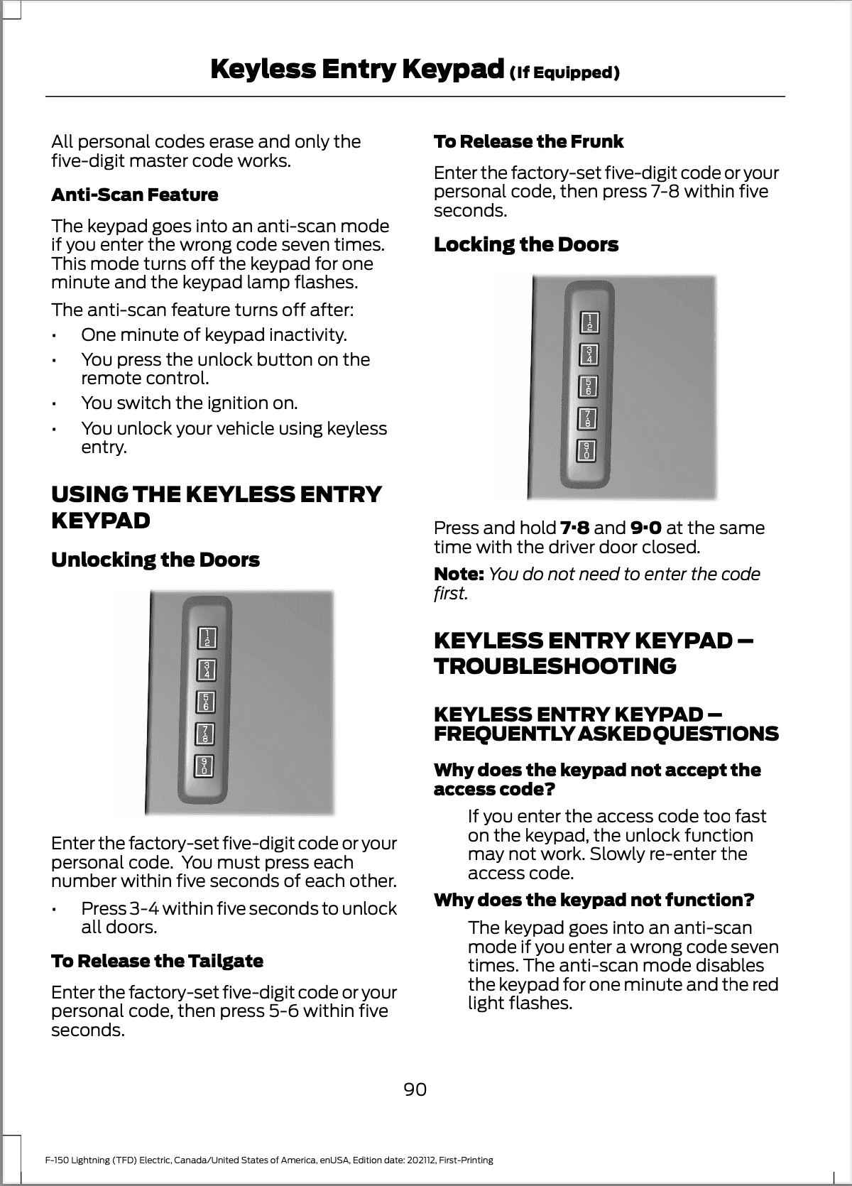

According to the manual, when you use the Keyless Entry pad, you can press
5-6 to open the tailgate
7-8 to open the frunk
On my Lariat, when I try this, 7-8 opens the frunk but 5-6 won't open the tailgate.
Has anyone else tried this?
I'll test mine Friday AM. It's pouring Cats and Dogs here (in Caco Maine) and my Lightning is quite a ways from the house.

@LightningLover You are right. It's a bug in the software. The Frunk works properly (opening with the pressing of the 7-8 key), but the Tailgate does NOT open (with the pressing of the 5-6 key.) Does anyone know how we tell @Ford Motor Company about this bug?
