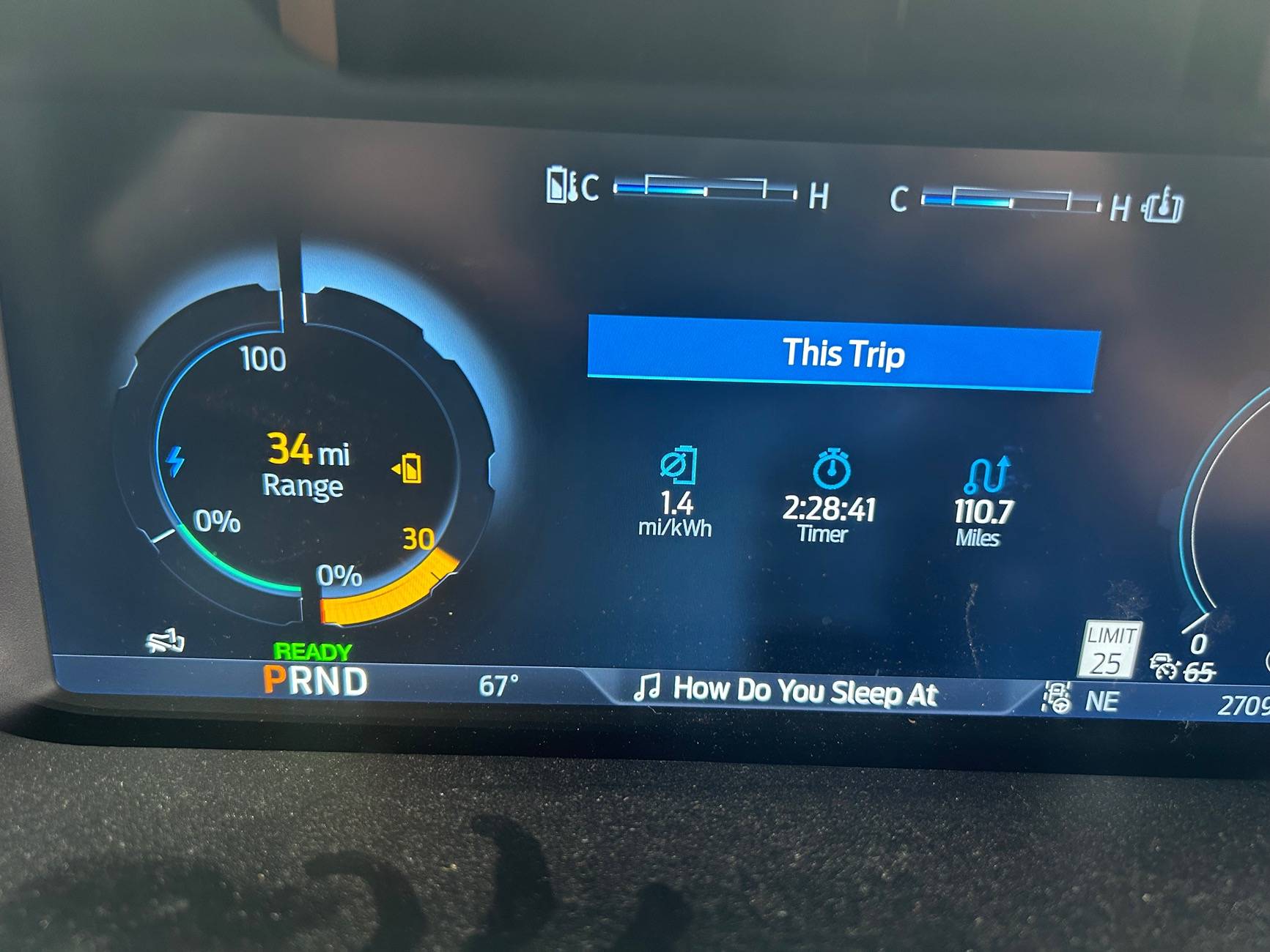

Journey is done! So cool what you can do with this truck. We put it at 45 mph with no AC for the vast majority of the trip just to be sure we would make it. No stop in Seligman and ended up in Williams with 30% battery. Couldn’t be happier ? ?

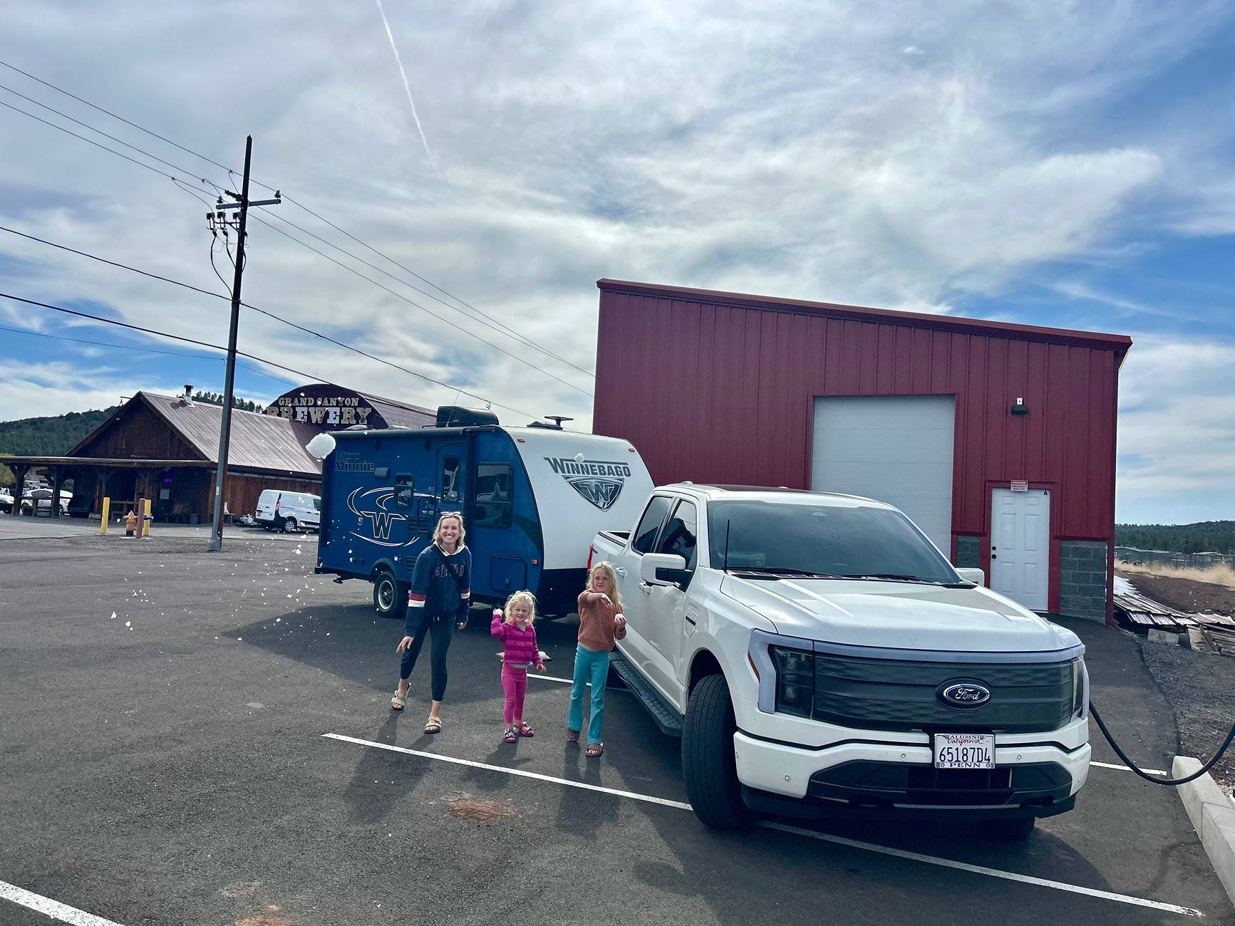

Tesla chargers are at the Grand Canyon Brewery. Truck was already charged up before I could finish my beer and fries.
* The drive time in the photo is inaccurate as we had the cabin on for a little bit at the end of the charge in Kingman. 1.4mi/kwh!

Interesting, thanks. 45 in a 75 is pretty sketch, but, I understand.

Ya. We passed a couple semis up the hills, and would bump the speed up to 60 on the downhills. All worked out. Given those numbers I surely could have gone a bit faster. Live and learn.

No surprise that you got 1.4 mpk at 45 mph. It's all about the aerodynamic drag.
I love the idea of a charger at a brewery! I'd definitely plan a stop there.

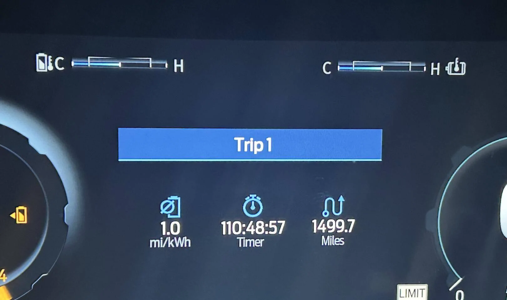

Here are the final stats for the trip. Bay Area-->Las Vegas-->Grand Canyon-->Bay Area.
F-150 Lightning ER pulling a roughly 5000lb travel trailer.
