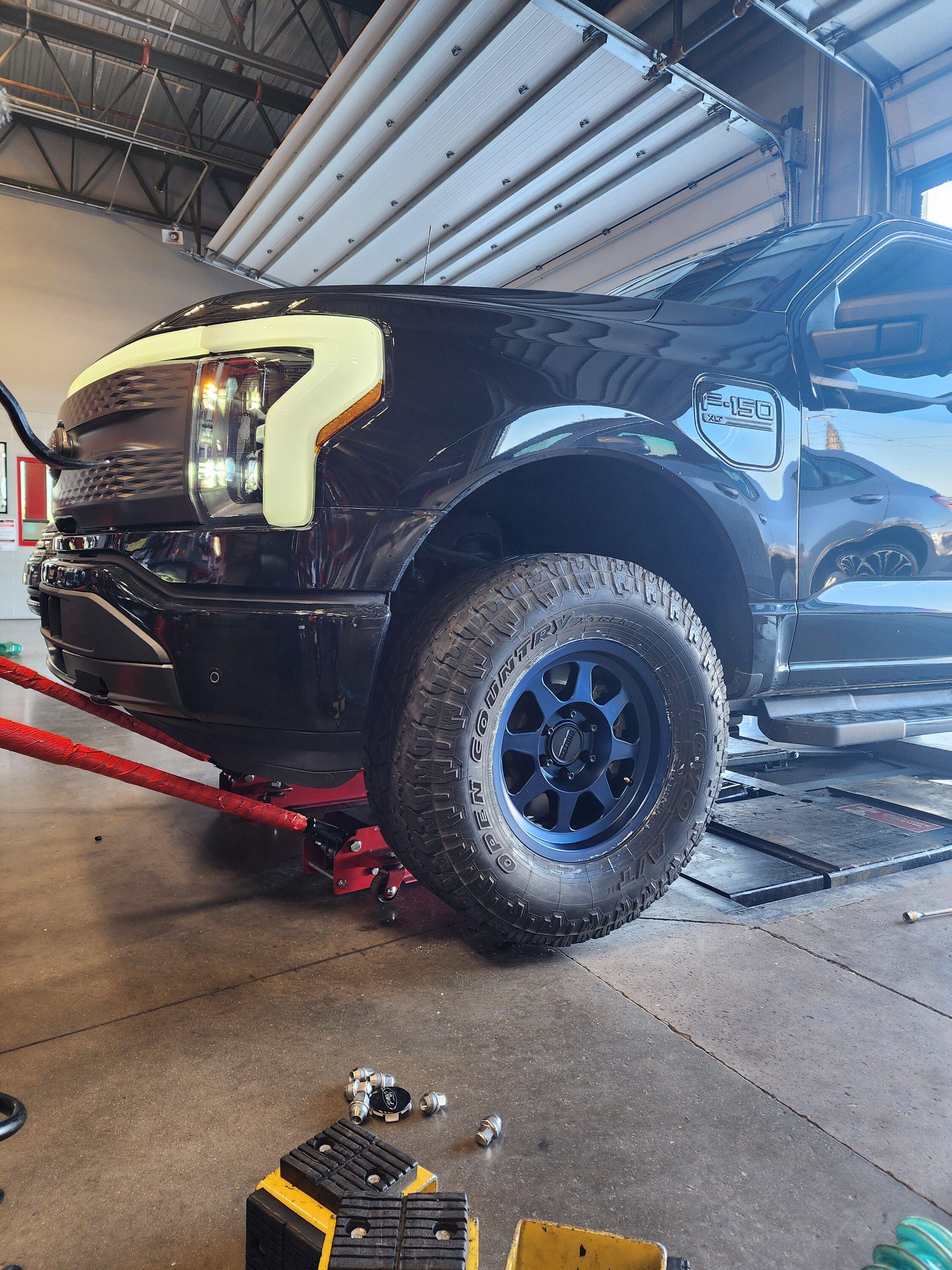

Method 701 / 17x8.5 / +0 Offset / Blue
Used toyos 305/70R17
2" Rough country leveling kit
Rubs in full lock in reverse and maybe some other times, don't recommend this tire size.
Shout out to @Discount Tire yall are some bros.
With all that out the way, good god I made this more difficult than it needed to be. Never done anything like this before and I did the leveling kit myself. If anyone wants a guide let me know.
First post here, let me know what you guys think of the blue. Everyone tells me to keep it, so I just might not paint them. Will definitely show case further mods as I go.

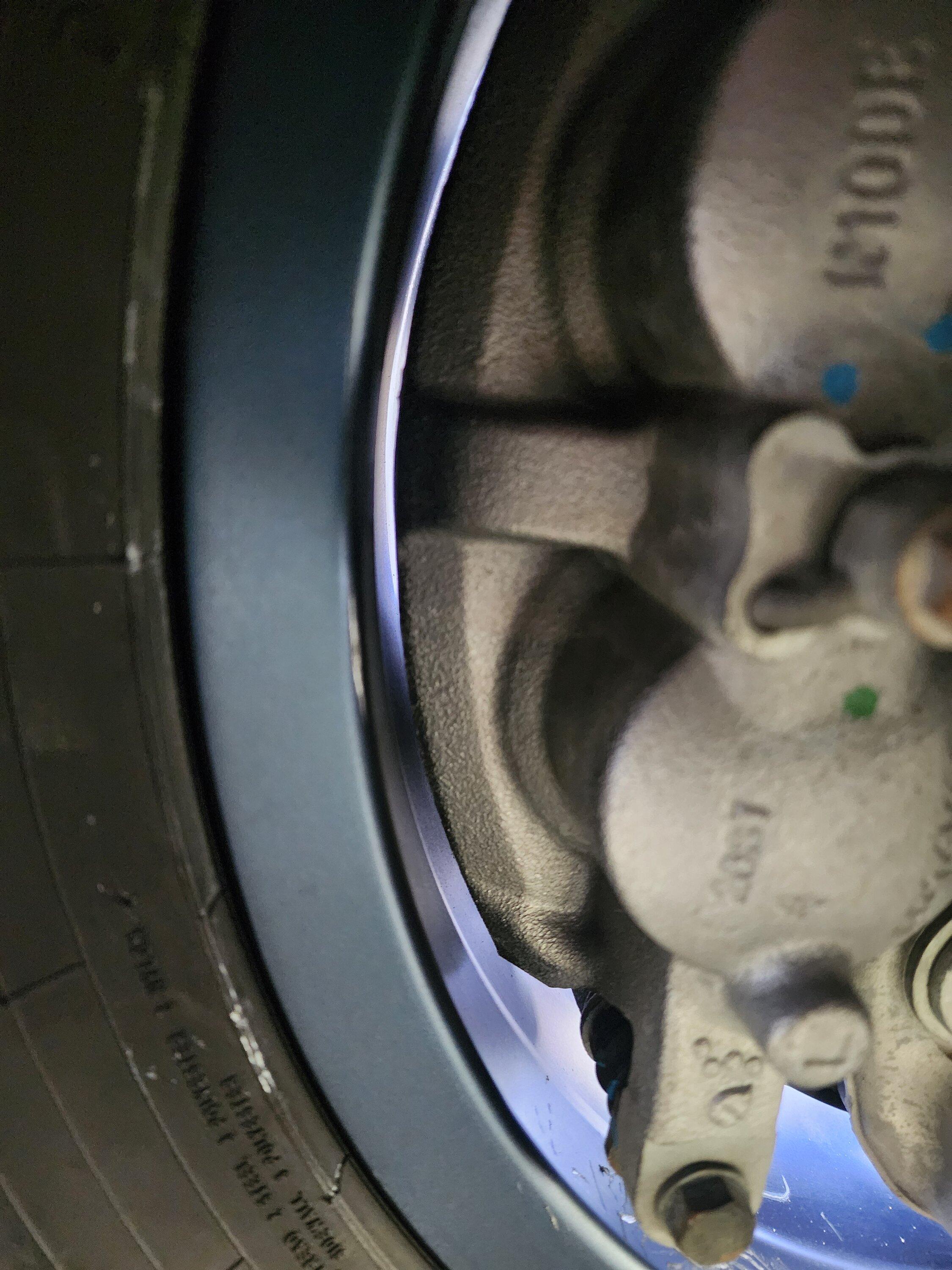

17's fit and clear the brakes? How much clearance do you have?

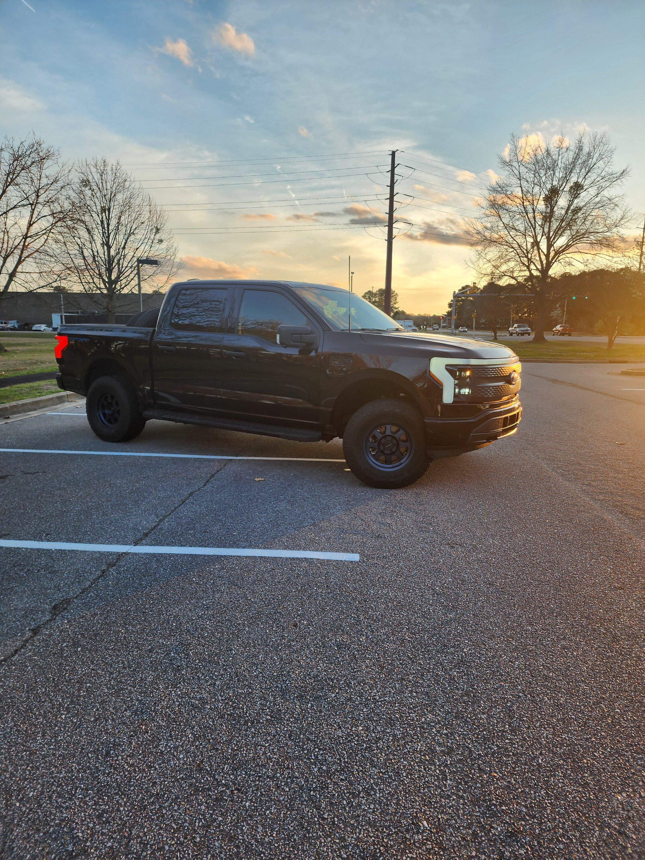

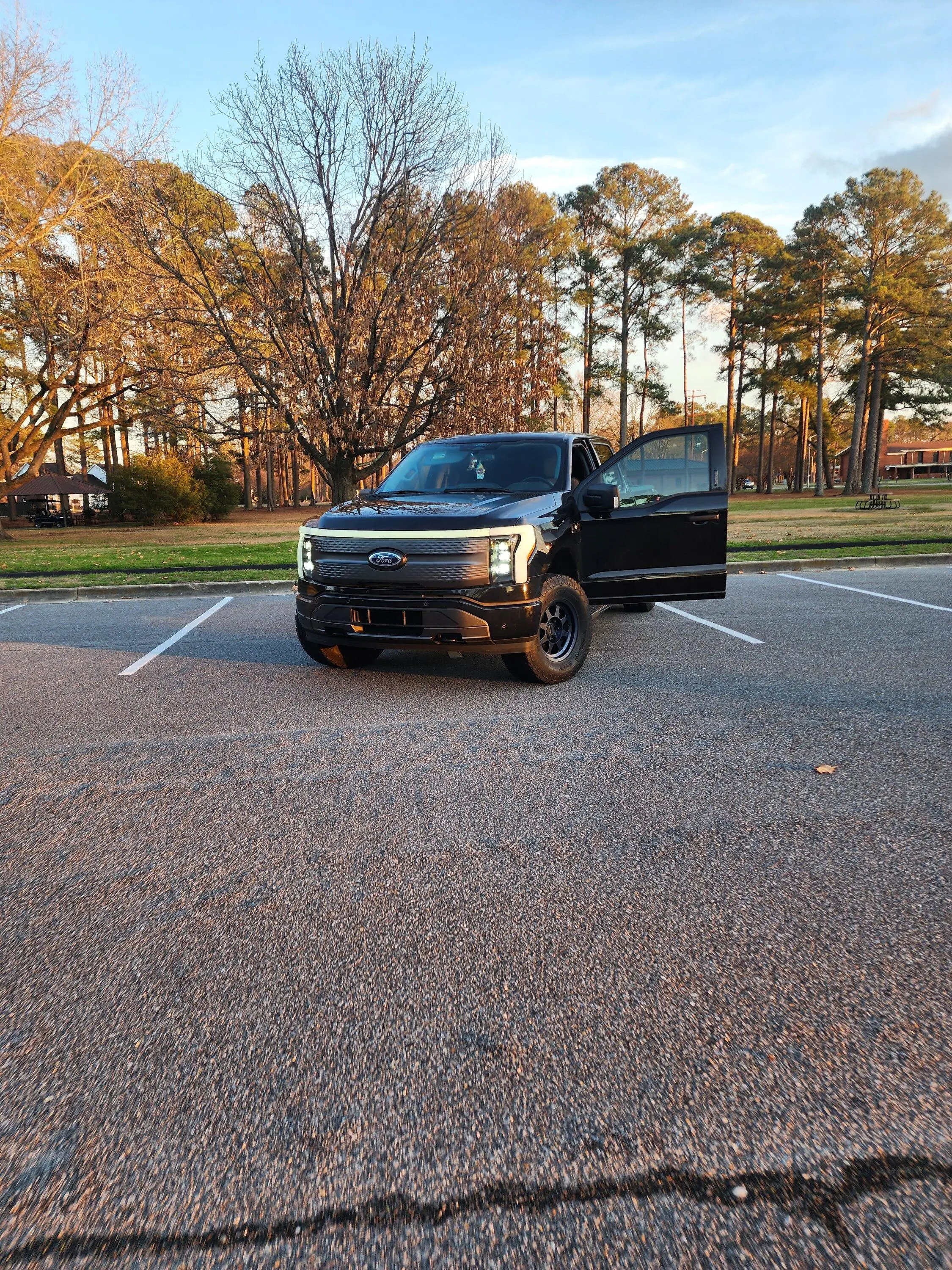

Will update futher on range later, road trips and such where I can give good data. Best guess rn is 10%-15% range hit.
0-60 is slower, but not by much. Still surprises brand new passengers.
Torque/accelerator sensitivity seems unchanged.
Road noise though! Tires are loud! ?‍♂ I don't mind, and would guess newer/skinner will be better.
Pics :D
