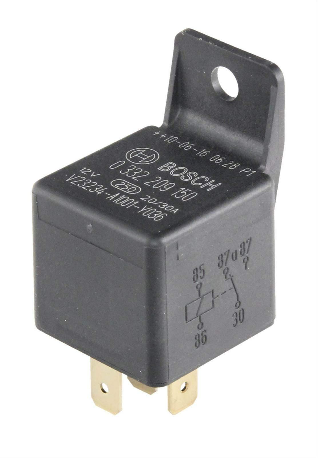

I have my grill filled with single LEDs all wired exactly like this.
Bosch Relay. Summit Racing... Six bucks!
Ford F-150 Lightning Light bar triggered with high beams Bosch Relay

This IS the solution.
I’m familiar with relays and have used them in the past to do the same thing. Do you have LED headlights? I heard it doesn’t work with the LED headlights.

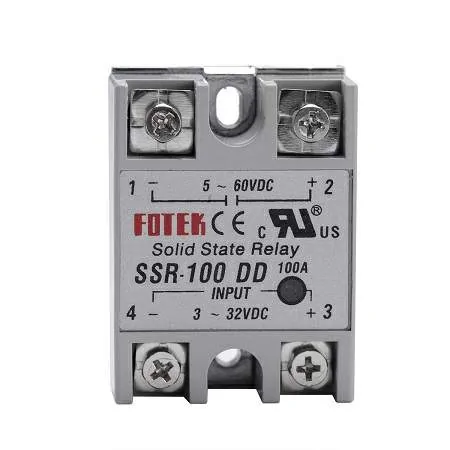

No I don't but I can't imagine why it wouldn't work. You might need to use solid state relay though.
I'm not an electronics engineer but I have had to use Solid State Relays for projects in the past. I went to the surplus store, bought a bag of various 12v relays and wired them until I found one that worked. It turned out to be a Solid State. It worked when none of the others would…
Maybe someone here can tell us “why”.
In the project I'm speaking of, I used the Solid State relay to trigger the Bosch relay. That was 10+ years ago and it's still working today.
I might have something to do with isolating the relay circuit from your "triggering" (high beam) circuit.
(Ten Bucks)
Ford F-150 Lightning Light bar triggered with high beams Solid State Relay
