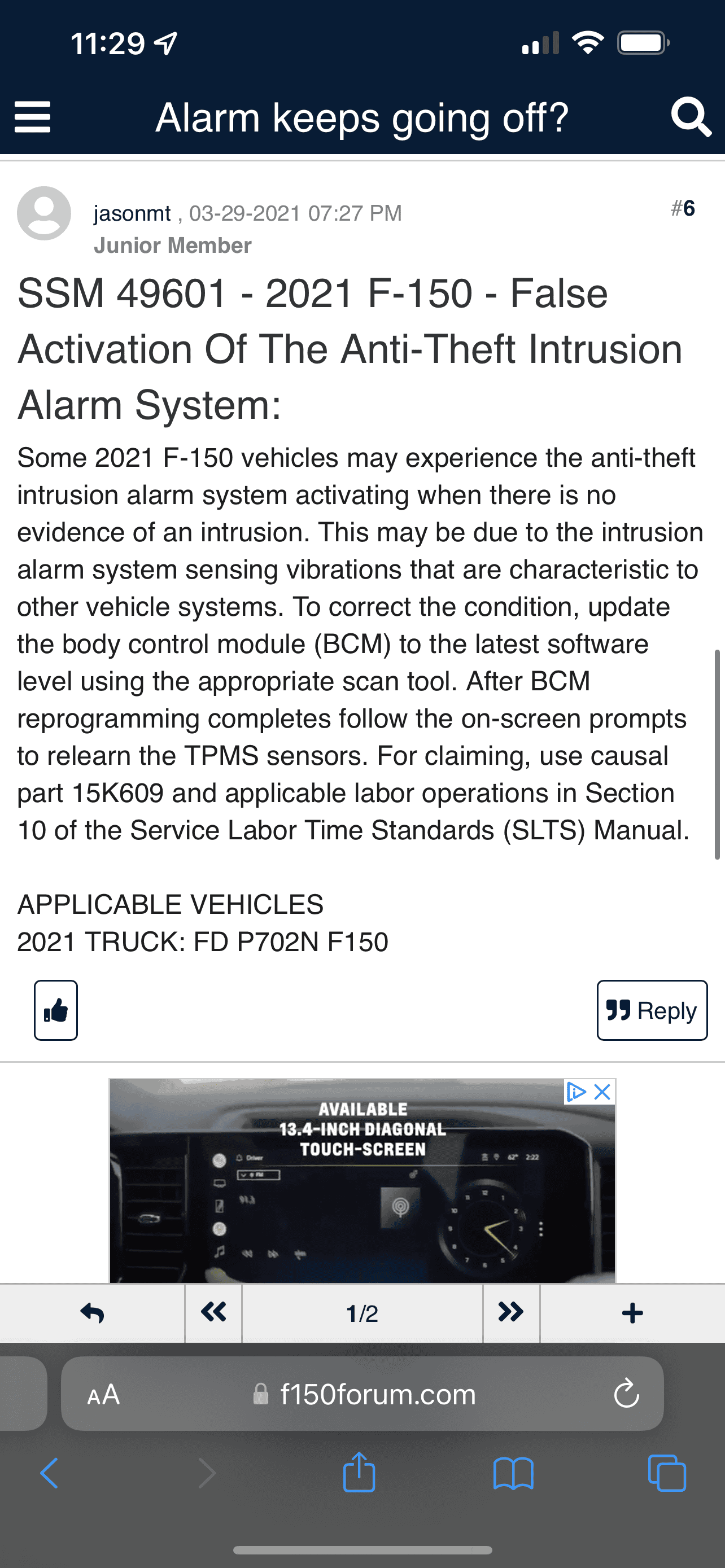

Heads up, if your Lightning’s alarm starts going off randomly.
For years, some ICE F-150’s have been afflicted by a problem of false activation of the alarm, and I now can confirm the Lightning upholds that most annoying tradition.
For the 4th time in the past three hours, the alarm goes off, for no reason.
A search of F150 forum shows that as far back as aleast 2015 this has been a known issue, and in one post someone provided what appears to be the 2021 internal service instructions:
Oddly, my FordPass app pushed my phone an intrusion alert only upon the 4th of these false alarms.
Can’t express how badly I don’t want to make a dealer trip to have this remedied.
