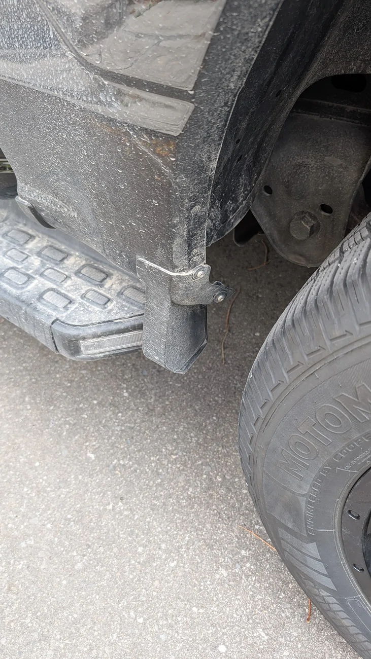

Wow! That Kia did about the same damage to a Lightning than a General Grabber tire blowout did to my wife's Lightning two years ago...
I believe the font is called Sarcastica. 😜 At least, that is my vote for its name if someone were to create it.
In the above damage from a tire blowout, the plastic trim piece tore the aluminum body panel where one of its mounting screws was and bent it where the other is. A body shop quoted two to three grand, citing the panel would need replacing.
A little rebending followed by some resin and fiberglass reinforcement fixed it for about $30 and an hour of my time. My work wasn't the neatest, but that plastic trim piece covers it completely.

I was just thinking that after I posted. Fortunately, my wife is off work this week, so I could take a pic (don't tell her I did without washing the dirt off first!).
Good as new!
