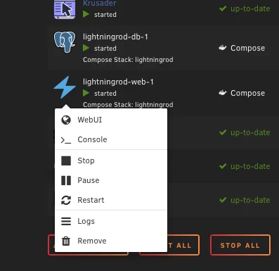

Allright! Nice work @theUNSTABLE! Gonna put a quick how-to for folks with UNRAID who want to make this work for them - assuming they already have HomeAssistant running in a VM or docker.
Ford F-150 Lightning LightningROD - Self-hosted charging analytics Screenshot 2026-03-10 at 5.57.06 PM
1) Make sure you have Docker Compose Manager for UNRAID installed - you can find it here: https://forums.unraid.net/topic/114415-plugin-docker-compose-manager/
2) Log into your UNRAID server using either a terminal, or using a terminal add-on.
3) Run:
Code:
git clone https://github.com/SquidBytes/LightningROD.git /mnt/user/appdata/LightningROD/
4) Go to the Docker window in your UNRAID GUI - go to the bottom section, where Docker Compose Manager should be - and click "Add New Stack". I called mine "LightningROD" but whatever floats your boat.
5) Click on the gear icon next to the name to change the description to your taste. Then click "Edit Stack" and "Stack Settings" to get to "Stack Settings: ENV File Path". You'll need to change this by typing in the window that appears to match where you downloaded the git file to. In my case it's:
Code:
/mnt/user/appdata/LightningROD/.env
6) Go back to that same gear icon and this time select "Edit Stack" followed by "Env File". You'll need to edit this as per @theUNSTABLE's original readme - that means picking a POSTGRES_USER name and POSTGRES_PASSWORD. Write your password down somewhere safe in case you need it in the future, and click "SAVE". (You do use a password manager, right?)
7) One final setup step. Go back to the gear icon again, this time click "Edit Stack" followed by "Compose File". You'll need to modify it slightly - specifically the build context paths and the port mapping:
Code:
services:
  db:
    image: postgres:16
    volumes:
      - pgdata:/var/lib/postgresql/data
    env_file: .env
    healthcheck:
      test: ["CMD-SHELL", "pg_isready -U ${POSTGRES_USER} -d ${POSTGRES_DB}"]
      interval: 5s
      timeout: 5s
      retries: 10
      start_period: 10s
    restart: unless-stopped
  web:
    build:
      context: /mnt/user/appdata/LightningROD
      dockerfile: /mnt/user/appdata/LightningROD/Dockerfile
    ports:
      - "8000:8000"
    env_file: .env
    environment:
      - POSTGRES_HOST=db
    depends_on:
      db:
        condition: service_healthy
volumes:
  pgdata:
Note: If you already have a service running on port 8090, pick any other free external port to map to the internal 8000. The format is EXTERNAL:INTERNAL - so "8090:8000" means your UNRAID host serves it on 8090, while the container always uses 8000 internally.
8) OPTIONAL: Go back to the gear icon, click "UI Labels" and set an icon for the two services. For the db service I used:
Code:
https://www.postgresql.org/media/img/about/press/elephant.png
For the web service, I converted the logo.svg from the project repo and saved it locally as logo.png on my server at:
Code:
/mnt/user/appdata/LightningROD/logo.png
You can also set up the UI address by putting
Code:
 http://[IP]:8000
in the Web UI setting for the Lightning ROD web service.
9) Once everything is saved, go ahead and click "Compose Up". It should boot!
Fantastic!
Thank you!
I will add this to the docs.
I am also on/using Unraid but as I've been working on this and testing it I don't have it running there just yet because I rebuild it constantly. When it's closer to what I completely envisioned I was thinking about setting it and configuring it to be an easily installable Unraid docker.
