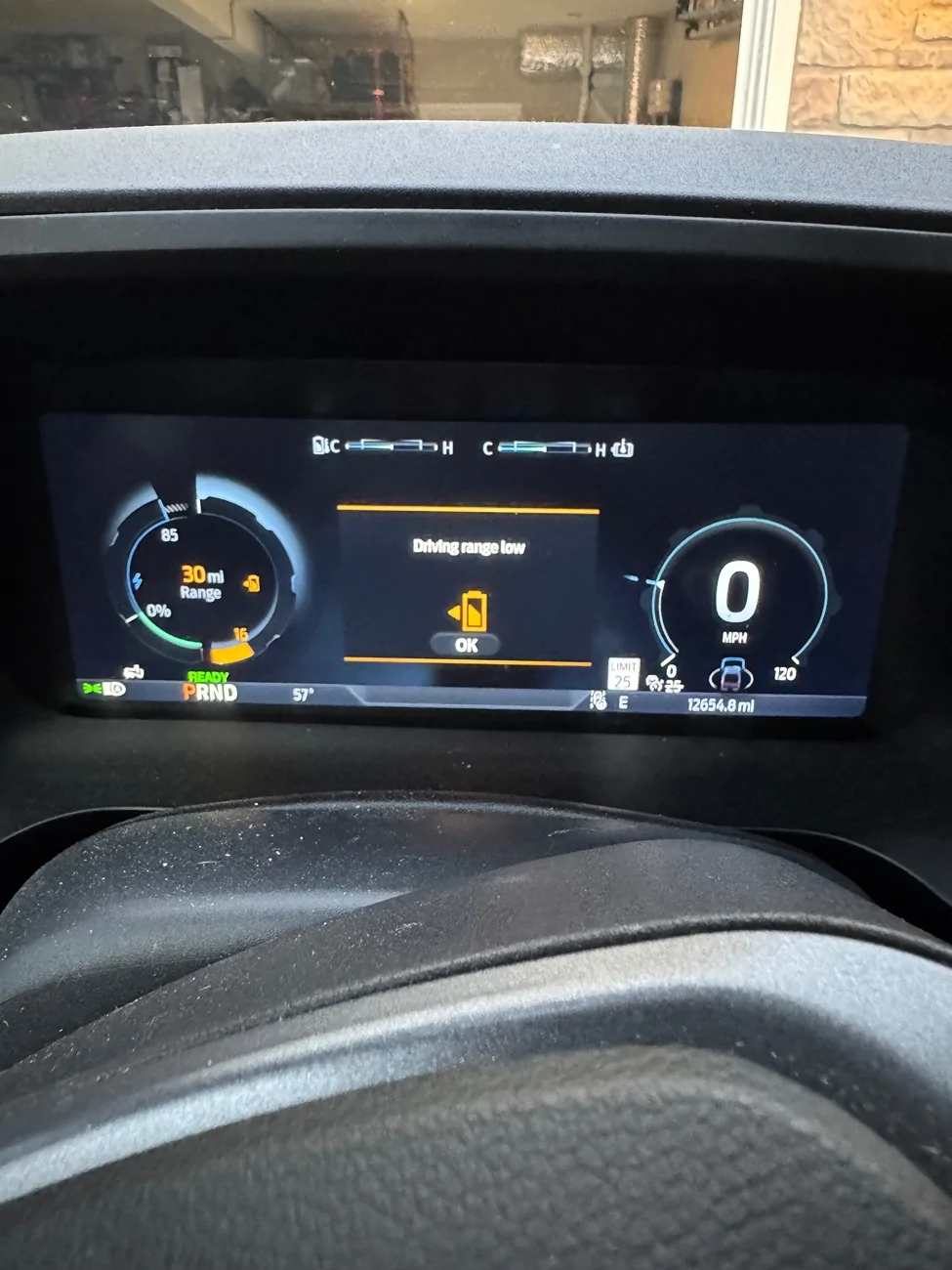

Have you drive under 30 miles?
I went from a 2021 explorer to a 2023 Lightning and I get that exact same message. Mine occurs at 30 miles. And I know for a fact I am not up to date on software releases (yet).
