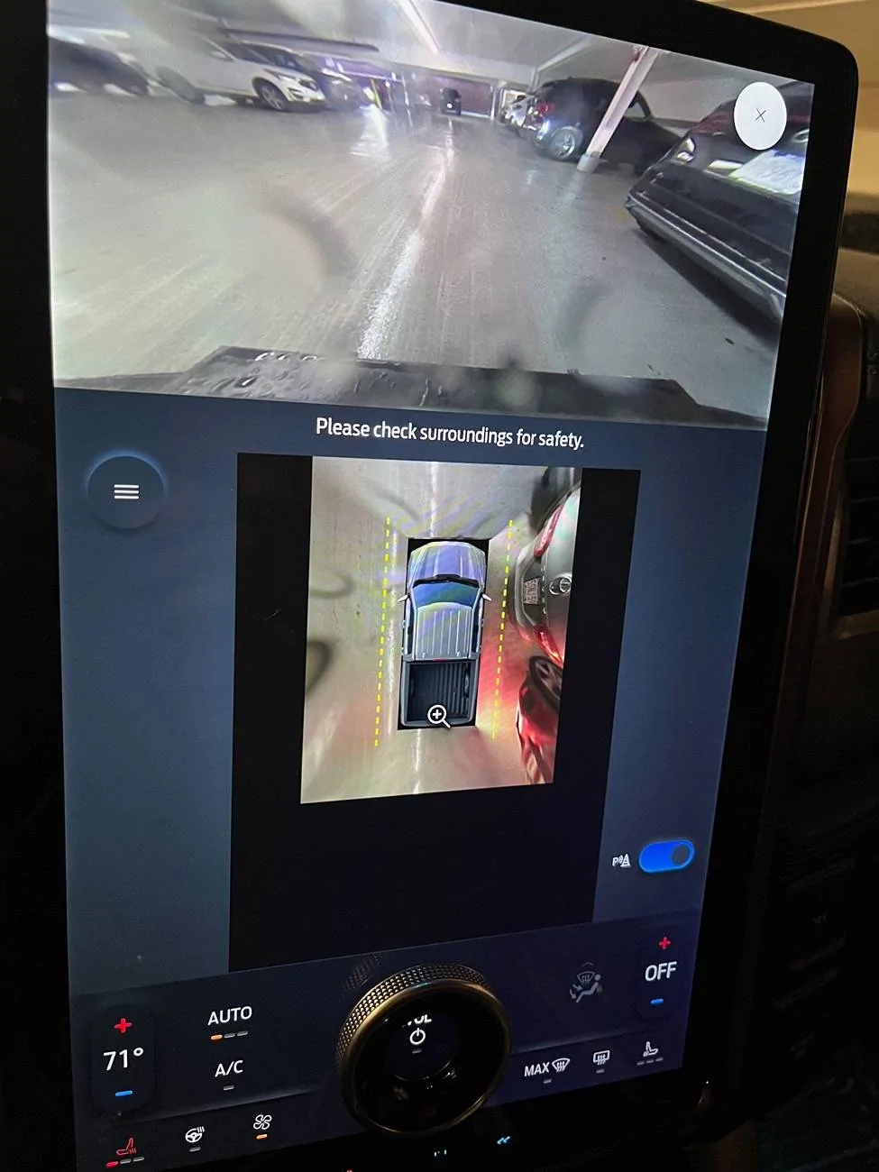

The lower camera view on the 15" screen on my ER 2022 Lariat is now smaller. Does anyone know if maybe I have a setting incorrect? This happened immediatly after getting two CSP's installed. Hitting the little Plus sign on the image does not change this. Any suggestions are appreciated.
  1. CSP 24B56 - Front Parking Sensors Imae Processing Module Software Update. Includes a Power Steering Control Module Software Update.
  2. CSP 24P24 - Front Hatch Control Module Software Update.

This is due to the tech not being able to READ THE CLEAR INSTRUCTIONS.
I may find them later, but they are supposed to run the APIM config tool at the end.
You can also do that with FORSCan.

I cannot do FORSCan, so I guess I'll need to bring it back to the dealer. If you can provide me with the instructions, that would be great . Thanks so much.
https://www.f150lightningforum.com/...24-f-150-lightning-trucks.21145/#post-416642\
11. On 2022 model year vehicles only: a. From the list on the LH side of the screen, select the APIM. b. From the list on the RH side of the screen, select APIM - 360 camera view display configuration. See Figure 1. c. Click RUN. Follow all on-screen instructions carefully.

Rick, thank you so much. I've made an appointment for next week and I've emailed them the information you sent to me. Your help is very much appreciated. Thank you.

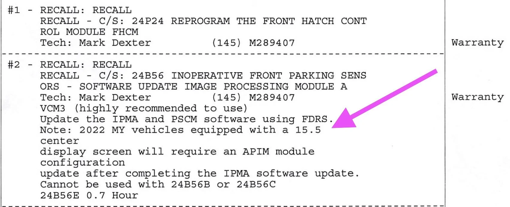

Had the CSP 24B56 done in Feb 2025 and it stated right on my service receipt that the 2022 models needed the additional APIM module configuration.
My 2023 updated just fine.
