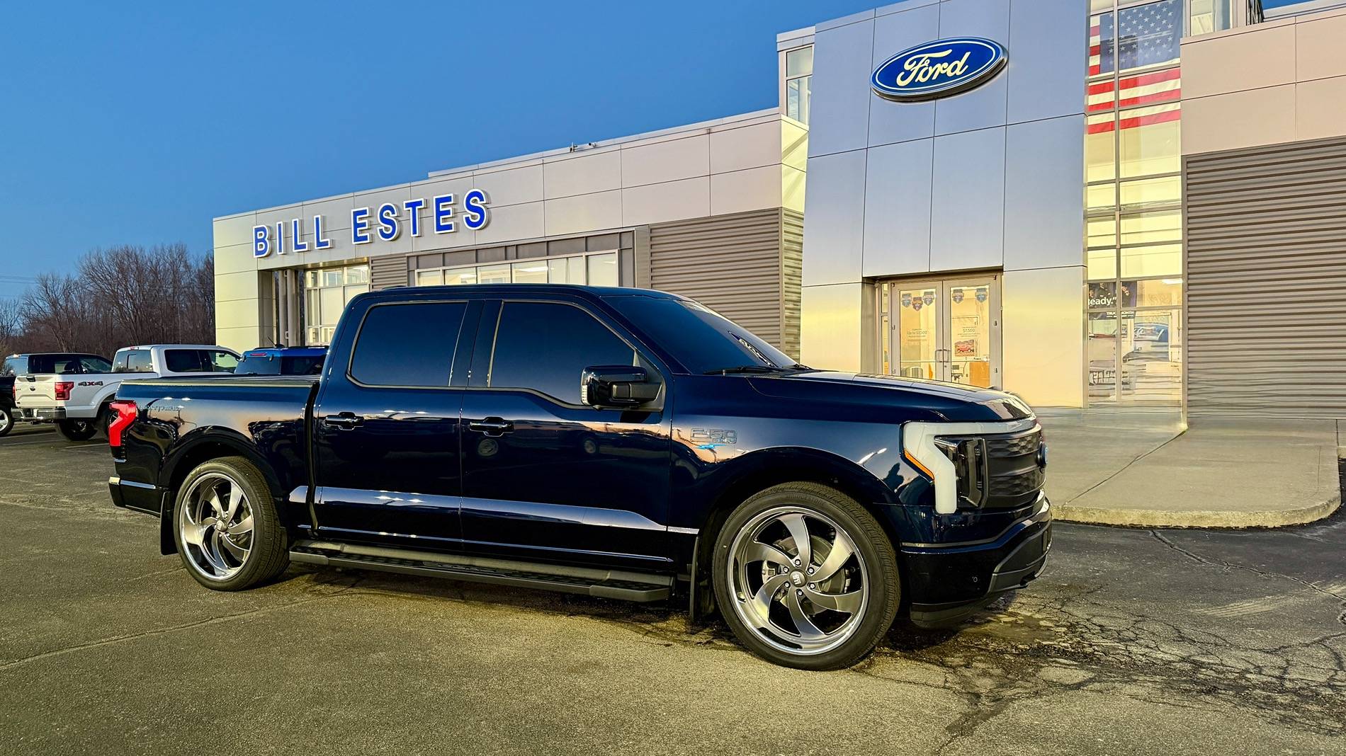

Still have a few small details to take care of but the bulk of it is done.
Belltech 25027 adjustable struts up front with one tall spacer (approx 2.5” drop)
Belltech 25001 adjustable struts put back. “Extension” between shock body and mount removed, no spacers, 1/2 coil cut out of factory coil spring, ICON Dynanics camber kit.
US Mags Desperado 6 wheels. 24x10 +25 offset

🔥 love the look. How is the ride with it being lowered?

It’s honestly not bad at all. I’m not going to kid anyone and say that it has the super plush ride that these trucks came with but that would be unrealistic. I called the ride “sporty“. The truck handle so much better, feels so much flatter in corners, and just has a little bit of a stiffer ride on crappy side streets and roads. But It’s smooth as butter down the highway

Being lowered how has it affected:
1. Efficiency up?
2. Headlight alinement
3. On board scale

1. Efficiency up? Haven’t really driven it enough to get a good gauge on that. Especially with the ridiculous ups and downs and temperatures here in Indiana right now. But I definitely have not noticed any huge decrease
2. Headlight alinement. Headlights seem fine. Nobody riding me or anything like that.
3. On board scale. On board scales are way out of whack right now. Says that I’m completely overloaded. But that’s a simple adjustment with the sensors in the back. I just have not taken the time to do it yet
