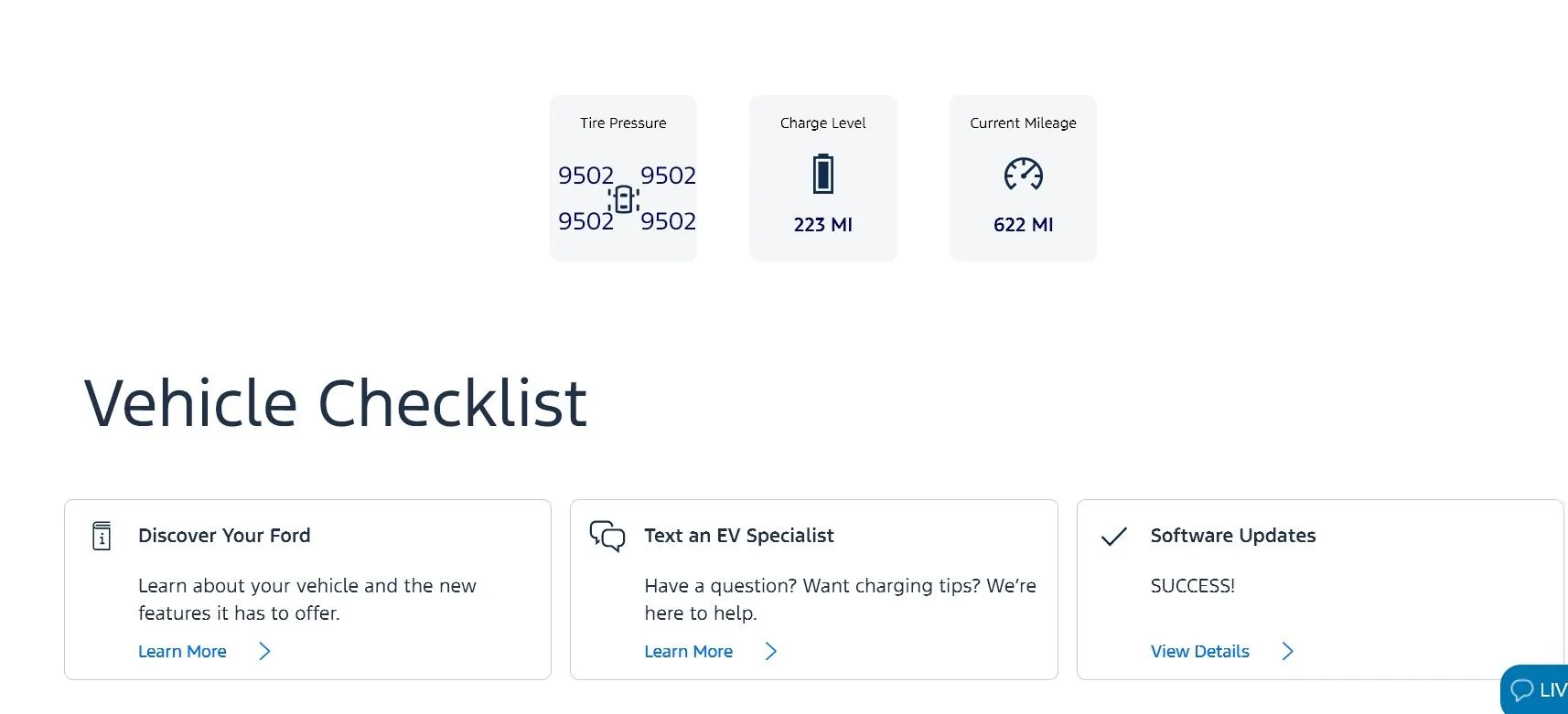

Well, finally!!! Update success...but, look what happened to my tires!
Ford F-150 Lightning LVB “normal” state of charge? Update success but tire pressure - OMG
So last night I hooked the truck up to the FCSP, turned it on in Drive Ready mode, turned off auto shut-off and lights etc., set it to charge beginning at 1am to 90% (said it would go to 4:22am), set the update to install at 4:30am, turned off pro-power-on-board, got out, locked the doors and went to bed.
At 8:20am I work up and checked the truck - it was asking me to turn off the truck to do the update but that was before 4:30am. So I rescheduled the update for 8:30am and turned off the truck, unplugged it from FCSP, and locked it.
Around 9:00am I checked FordPass - no truck connectivity. I figured that might mean the truck is updating and can't answer the phone right now, so I waited a bit. 9:15am still no truck - look out the window - it's still there.
So I go on the PC log-in to the Ford account and viola - update success! I guess that's why FordPass on my tablet will no longer connect to the truck. LVB battery at 79% (so it says). But look at my tire pressure! They must be about to explode!
Well, now I have the update and will have to figure out what it messed up besides the FordPass communication...alas.
This is what it is supposed to be:
UPDATE SUCCESSFUL
Check out what’s new! Regular Ford Power-Up software updates like this enhance the quality, capability, and convenience of your vehicle.
Automatic Updates: On
Recurring Schedule: Wed at 8:30 AM Sat at 8:30 AM
Last successful software update completed on:
07/31/2024
What's in This Update?
Priority Update- Powertrain
Your vehicle has been updated with following:
Customer Satisfaction Program 23B57
We updated the Battery Energy Control Module (BECM) software strategy to adjust the way your vehicle performs if a voltage deviation is identified within the high voltage battery. This completes customer satisfaction program 23B57. There is nothing more you need to do to complete this customer satisfaction program.
SYNC Navigation
SYNC navigation has been updated to anticipate conditions along your route and schedule battery cooling to meet the unique demands of your trip.
Software updates are designed to help make your vehicle better over time.
23-PU1129-CBC-ODP
The saga continues...

Maybe you got the monster truck tire OTA???
That's one hell of a tire!

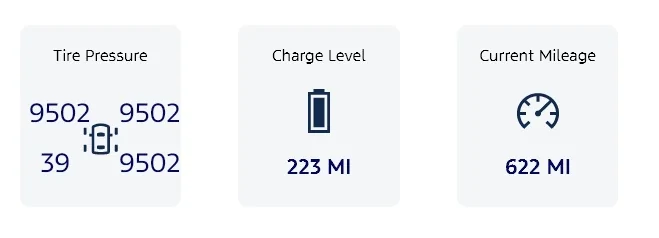

I rebooted FordPass on the tablet and started the truck and now they are talking again.
And ONE of the tires is back to a "normal" 39 psi:
Ford F-150 Lightning LVB “normal” state of charge? tire pressure 2 - OMG
LOL.
To err is human, to really screw up, you need a computer (with wheels?)
