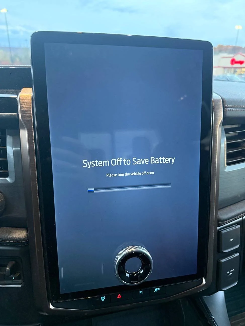

Turning off the truck produces this image (which, I suspect, is possibly causing #3?)
Ford F-150 Lightning Multiple Issues after CSP "Repair" IMG_0110
No idea what the impact of this is, but it's definitely a change.

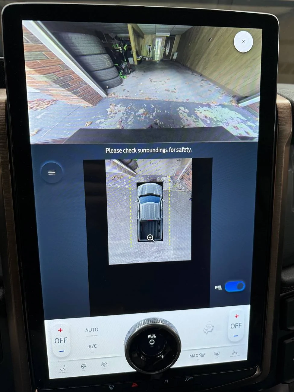

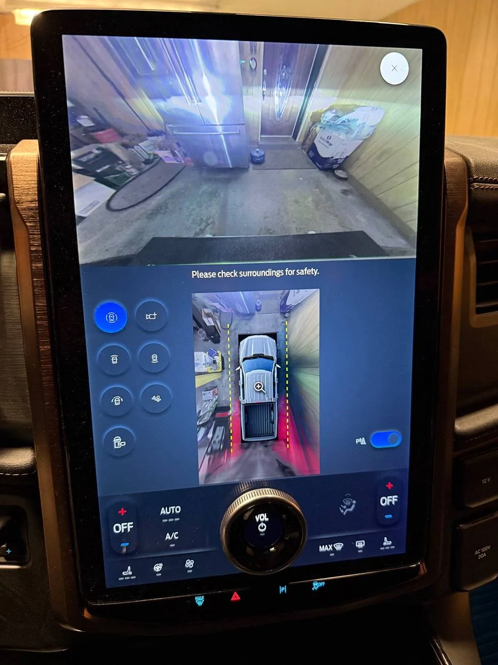

Now for the big one - my camera no longer works as expected! WTF is this?!
Ford F-150 Lightning Multiple Issues after CSP "Repair" IMG_0108
Previously I could hit the camera button and get the 360 view to take up the whole lower half. Now I get the parking/camera options taking up a whole bunch of real estate IN ADDITION TO the empty black space reducing the size of the 360 view even further.

Your 12v LVB might be weak due to improper update procedures at the shop, drive or Idle the truck in RUN mode for several hours to top off the LVB.
The other issues have been observed by others after getting direct & OTA updates (My View) is common, there may be other preferences that have been ~changed~ that are the source of too many ding-dongs.

The battery is low because they did the updates without properly connecting a power supply. I had it too, but tech says he used one. I charged the 12v on a trickle charger to 100%.
Has anyone encountered this? I'm taking the truck back in on Tuesday but since it seems not every dealer is intimately familiar with Lightnings I'd love to crowdsource experiences so I might be able to provide them with a little guidance on how to fix these issues. Thanks!
This is a common problem after IPMA updates where it fails to write the proper config for the 360 view to appear full-size. If you have FORScan, you can fix it in minutes.

UPDATE
- Bingbonging alerts were because during the "repair" they turned the lights on. Didn't even cross my mind because I keep it in Auto 24/7 (because, why not?) which probably contributed to ...
- The 12v battery was super low, causing the "System Off" screen
So most things were fixed ... but the camera was nerfed and that appears to be by design. They did fix it to remove the black screen, but a lot of screen real estate is now taken up by camera options which is ... not desirable in my book.
Old 'n Busted
"New Hotness"
Ford F-150 Lightning Multiple Issues after CSP "Repair" IMG_0126
I wouldn't call myself thrilled over the camera change but I don't think I have any other option than feedback to Ford and I definitely don't expect that to go anywhere. I miss my full 360 camera 😭
I agree on the "fixed" camera view; it's not exactly...ideal in my opinion. Still, better than a borked view that wasn't correct to begin with.
FYI, when I had this fixed today at the same dealer, the service rep explained the issue for the 360 camera settings not run had to do with a "weird page break" (his words) in the instructions that the tech had to double-check. For those questioning Ford's service techs (especially in the other humongous thread on these and other related issues to the CSP), it sounds like the big fault could be in the way the module(s) update instructions were presented to begin with 😵
