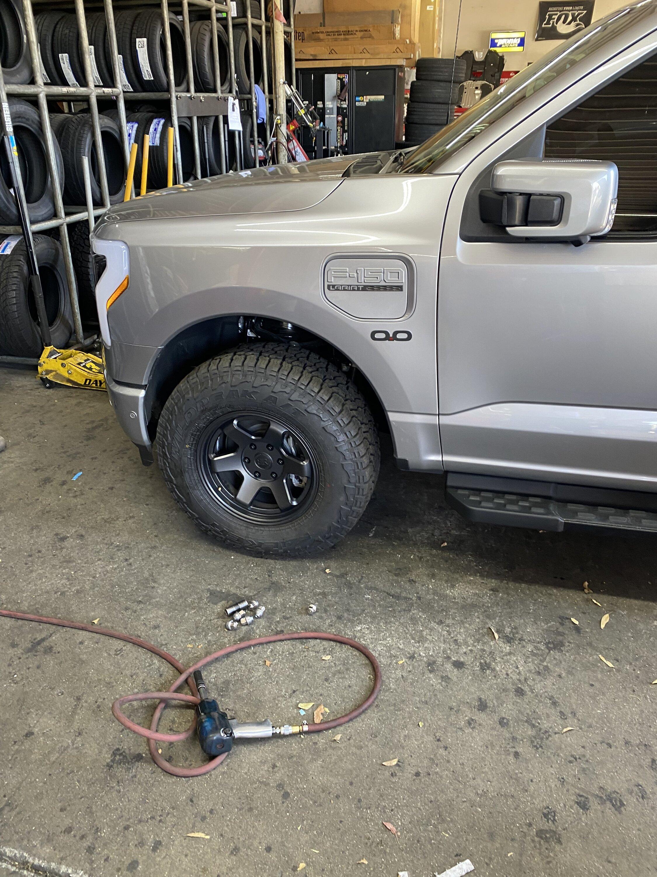

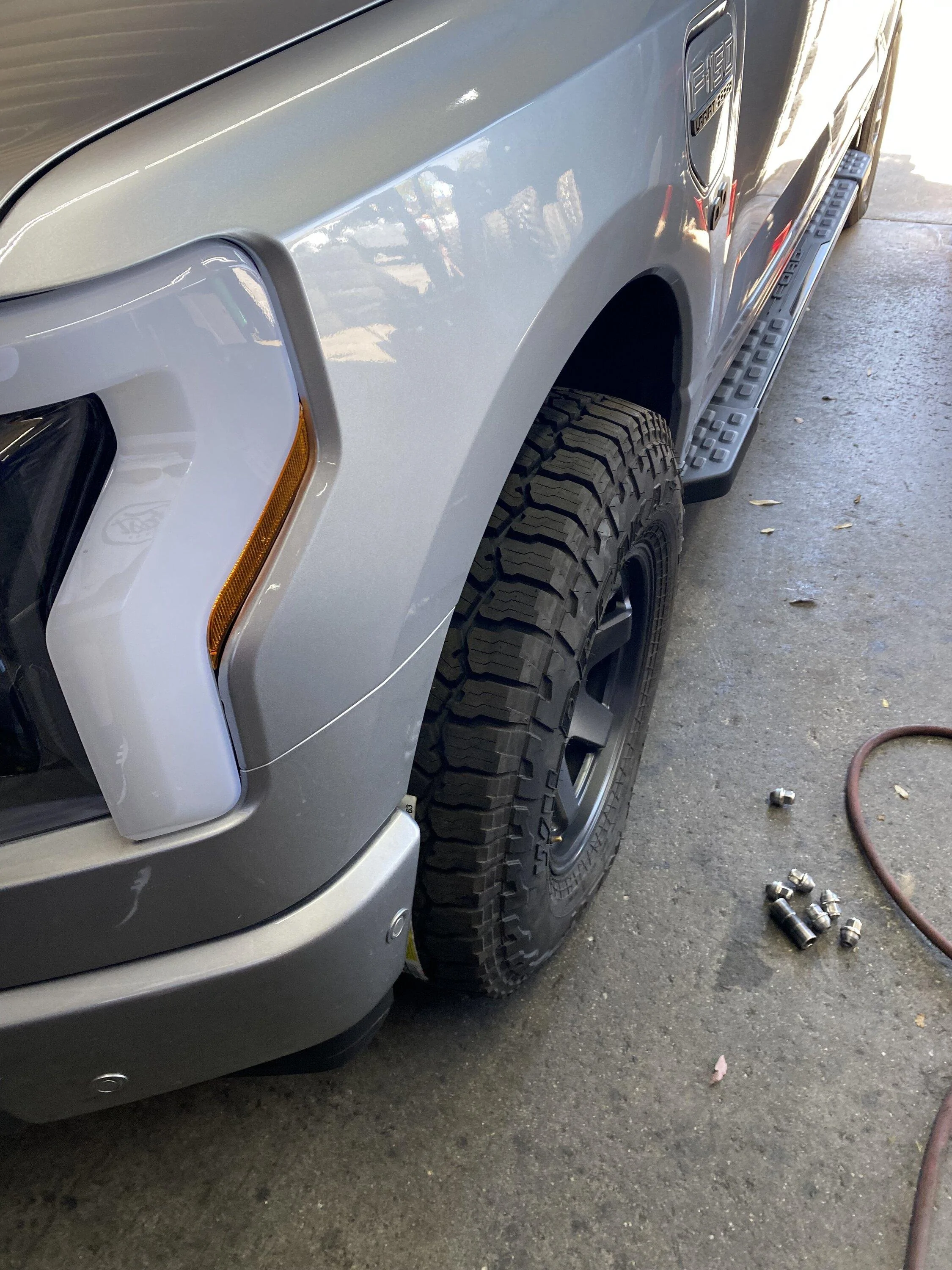

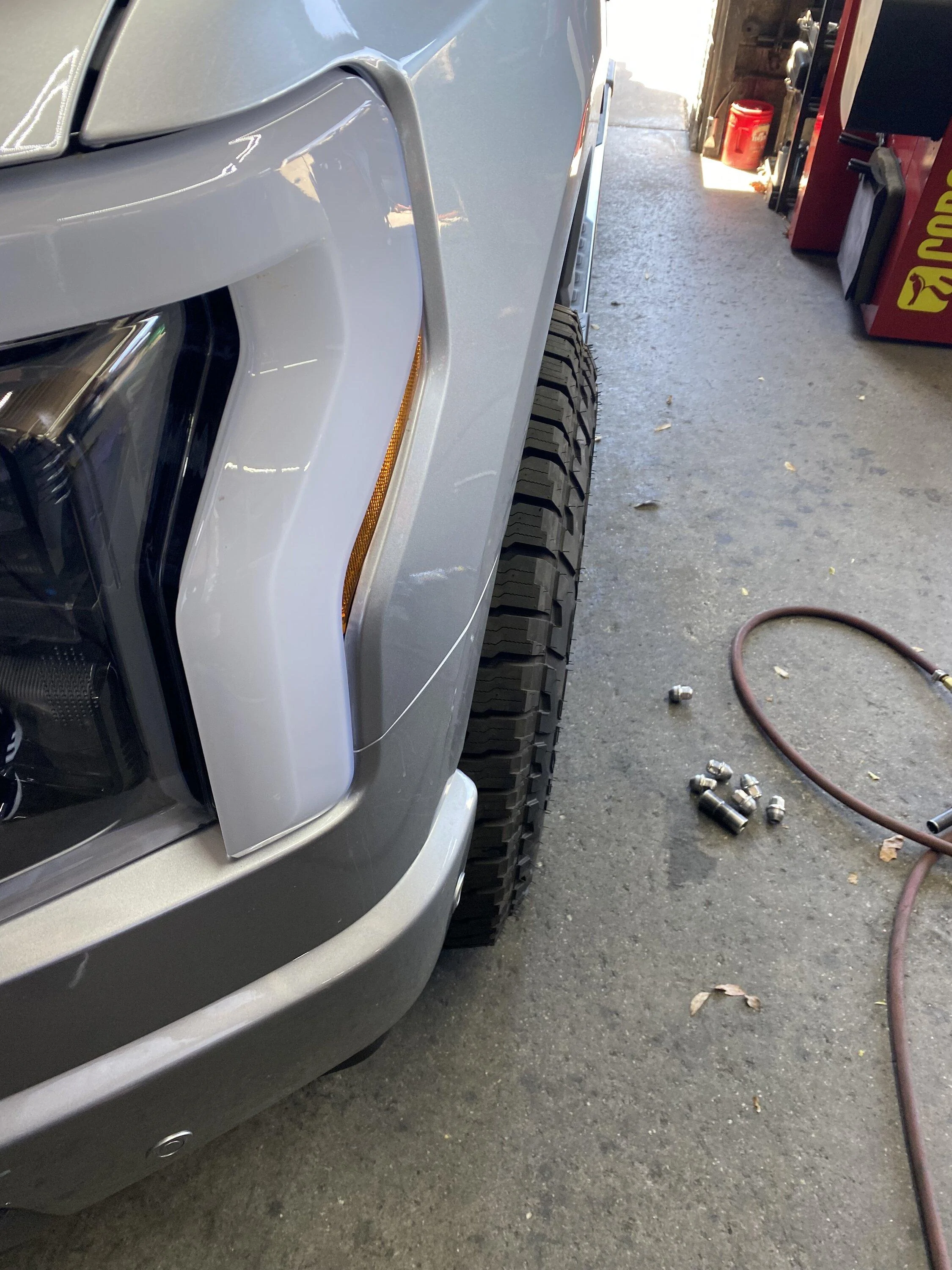

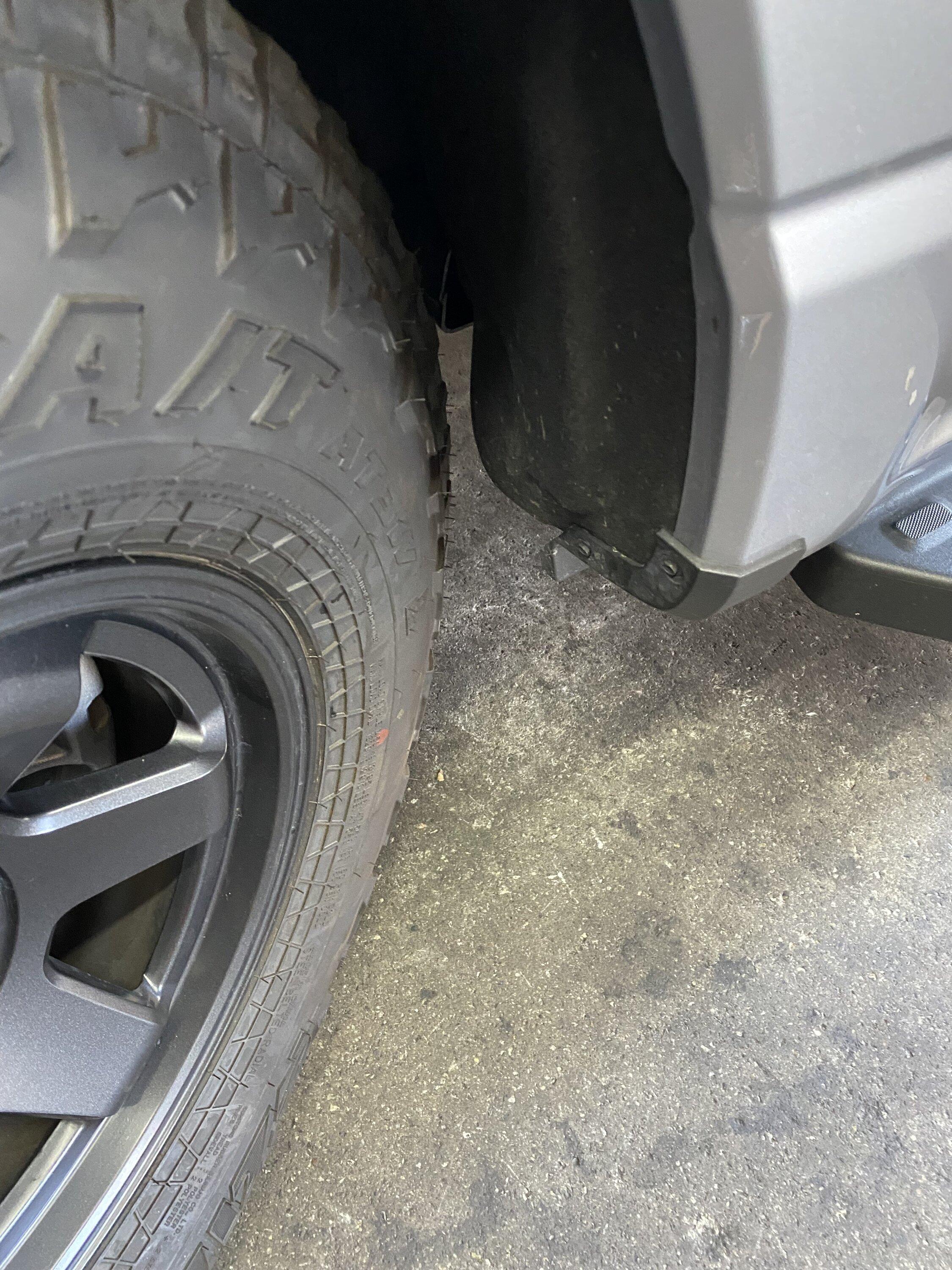

Tested my Black Rhino 17 x 9.5+12 Rokus from my Gen 2 Raptor with a 285/70/17 Falken
and they just kissed the carpeted wheel liner at the back. Easy to be screwed back or trimmed. Stock height and wheel weights will need to be tacked strategically but they clear without them.

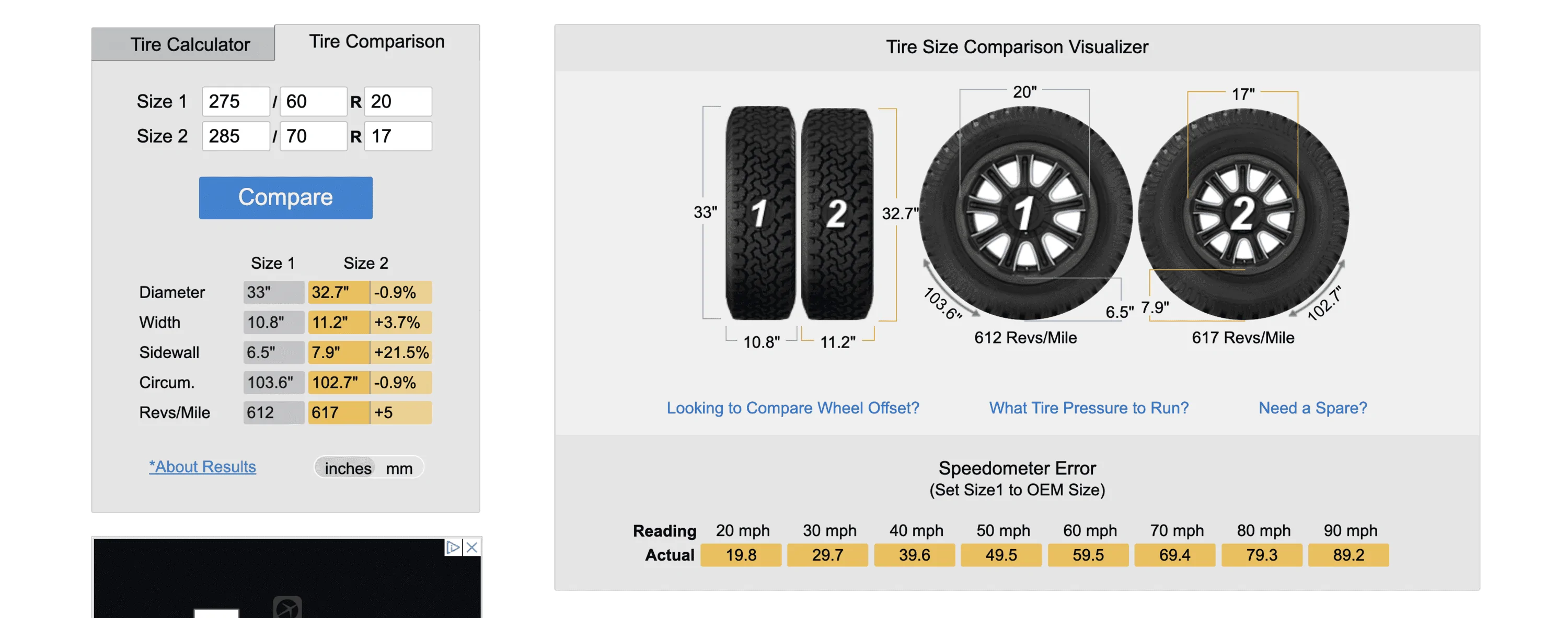

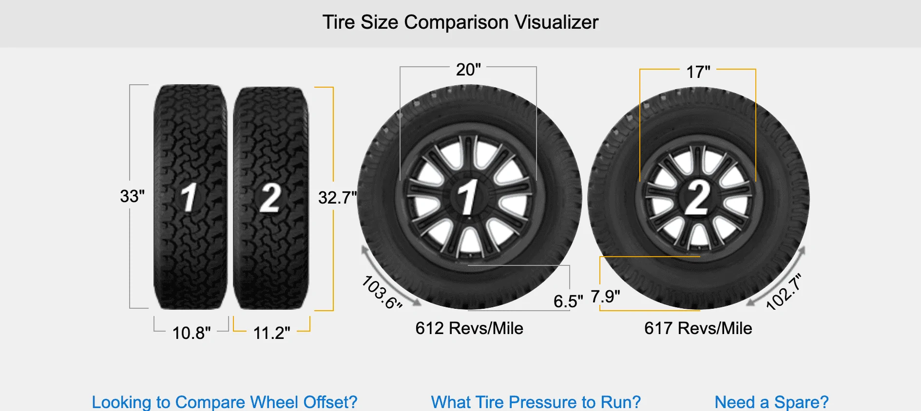

These are slightly shorter and .4inches wider, closest I could find to stock radius in a 17.
