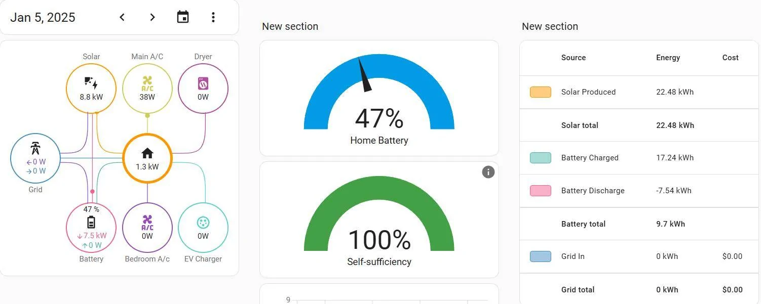

This is a pic of my power dash board. I set this up for my wife to help her decide if running the dryer (one of our largest power hogs) is going to put us in the negative.
Ford F-150 Lightning My Goal: to never pay for charging (Solar) -- my automation process Screenshot 2025-01-05 120154

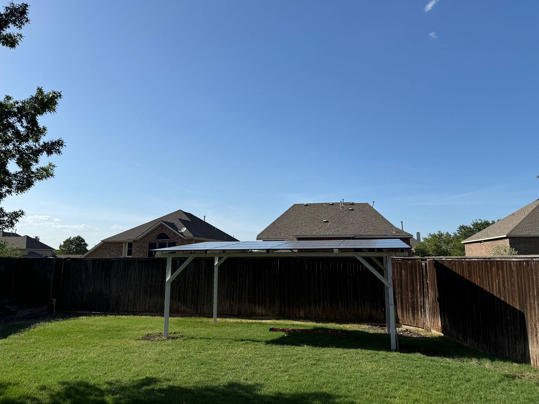

I used Solartime in Richardson for my solar install. They build a nice pergola!
Ford F-150 Lightning My Goal: to never pay for charging (Solar) -- my automation process IMG_0905
I went the easy route with a Tesla powerwall 3 Mainly because it has the automatic grid disconnect if power goes out, I can still produce and use solar.
