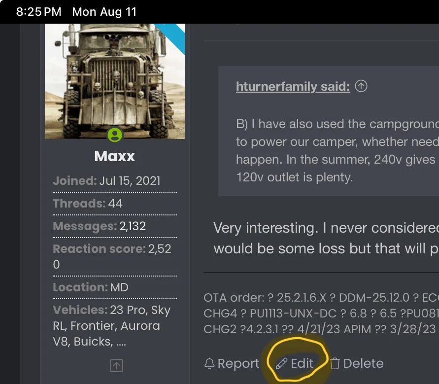

Sorry, new here and can’t figure out how to edit my reply… I was going to recommend looking up a YouTube channel by Benjamin Sahlstrom that have a number of videos showing different ways to use the Anker F3800 and F3800+, the F3800+ is the better of the two.
