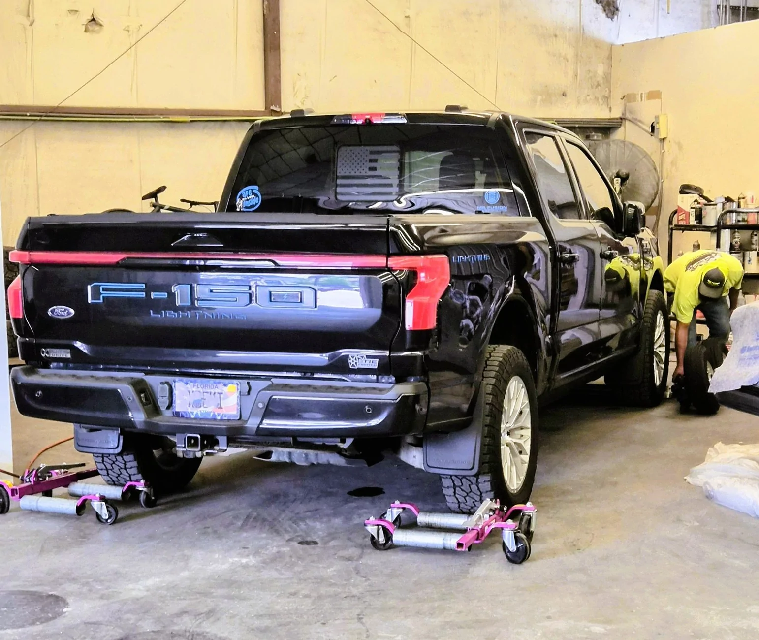

Had a few scratches so I dropped Luna at a body shop for a week. Didn't want joy rides happening, so I left just 40 miles of range on it. Unfortunately a very bad idea. Worker took it to the paint shop, the dealership, his ex wife's house to pick up something, etc... ran it down to 0% battery left, thinking it was a hybrid and he could just add gas at the shop later. Tried to pick it up this morning, but it was bricked. Not even enuff power to get it out of Park to push it out of the shop, so the tow driver had to use dollys., Learned the hard way, after paying for it to be towed to a charger, that once you're at zero, it will not take a charge unless the dealership does a recovery charge, apparently. So $175 tow to a charger a few miles away, then another $175 to the dealership 12 miles away. The dealership had never heard of anyone ignoring all the repeated warnings the truck gives and running it to absolute zero.

I don't understand what is creating such difficulty recharging. Isn't it just a matter of putting a booster pack on the 12v battery to wake the computers up, then hooking up to a DCFC?

You/they should be able to just L1 charge from 0 to 5% or so and then you can fast charger from there. Depending on how low they really got it, the pack voltage may be below the DCFC station threshold to start. This can vary from station to station and even day to day. Usually not an issue, unless you let it go all the way past 0% and stop moving and get unlucky, which sounds like you certainly are.
2,842
3,138
They managed to get the truck to 0 or below and still managed to make it back to their shop? Did you try jump starting the 12v to get it out of park? Has the dealership tried level 1/2 charging yet?
I was not aware that DCFC had a min voltage. I would be more likely to believe the 12v died and the truck just won't turn on to begin DCFC. I recall Out of Spec ran one dead in a race with Tom. They got a tow and it charged fine.
Yes but...the dealership may be uninformed about how to do it, that has happened before.
I remember reading another post on another site about a dealership saying the owner needed a whole new battery and that they couldn't charge the battery...probably dealership ignorance and probably just needed the 12v boosted so the contactors will close.
The BMS can get mixed up about the actual SOC of the HVB and one can inadvertently go to 'zero' and shut down apparently after multiple charge sessions without allowing time to re-calibrate....but there is always the safety buffer down there near the bottom so never at actual zero charge.

Between the awesome people who posted helpful responses here and the FB Group, I now have something to call the dealership about first thing in the morning.
Most recommended option- tell them to try doing a slow level 1/2 charge to see if it will start taking it into the battery. Feedback seems to be that below 2%, the vehicle battery will not accept fast charging, but will accept a low level charge. So, try that first, get it up over the 2% SOC, then go put it on the dealership chargers.
For those that asked, no, I didn't have my charge cord. It was plugged into the wall at my house where it typically stays and I was 2+ hours from home.
Second most recommended option- Another thing to try before disconnecting the battery from the vehicle and doing some lengthy recovery process, check the health of the 12V battery as it may have died in the process... and either recharge or replace it.
Bottom line, the battery mgmt system is designed to protect the battery and thus shuts off certain functionality below a certain level. As such, the truck not taking a charge from a commercial fast charging station when is it at 0% is indeed normal. I didn't know that. I doubt the dealership in Savannah knew that as they had only ever worked on a few. And obviously common sense would stop most people from running it down to that level as they would have paid attention to the multiple warnings along the way in any normal situation that wasn't an emergency.
