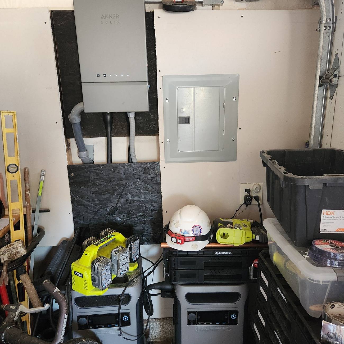

I tested this over the weekend. The generator input to the F3800P works from the Lightning. I was able to charge the battery from the truck with no problems, at 240v. However, the setup originally proposed (which I really hoped would work too), does not work for a couple reasons.
  • The generator to battery adapter uses the same port as the battery to house adapter, so you physically can't have the battery connected to the truck and to the house at the same time. Big bummer.
  • Because the port is the same, however, you can connect the truck to the home power panel via the generator adapter. The system is designed to take the output from a generator and push it directly to the house via the HPP. However, the ground issue comes into effect here and the truck shuts it down.
So, no go. I think you could have two F3800Ps and charge one while the other is in use, then swap, but that would be inconvenient and technically you're supposed to turn off the HPP before connecting/disconnecting anything, which kills all the backup circuits. Not ideal. You may be able to charge one battery via 120v from the truck while the other is being used for backup without disconnecting anything, but depending on your load it may not charge fast enough anyway. I don't think you can charge via 120 while it is supplying to the house.
