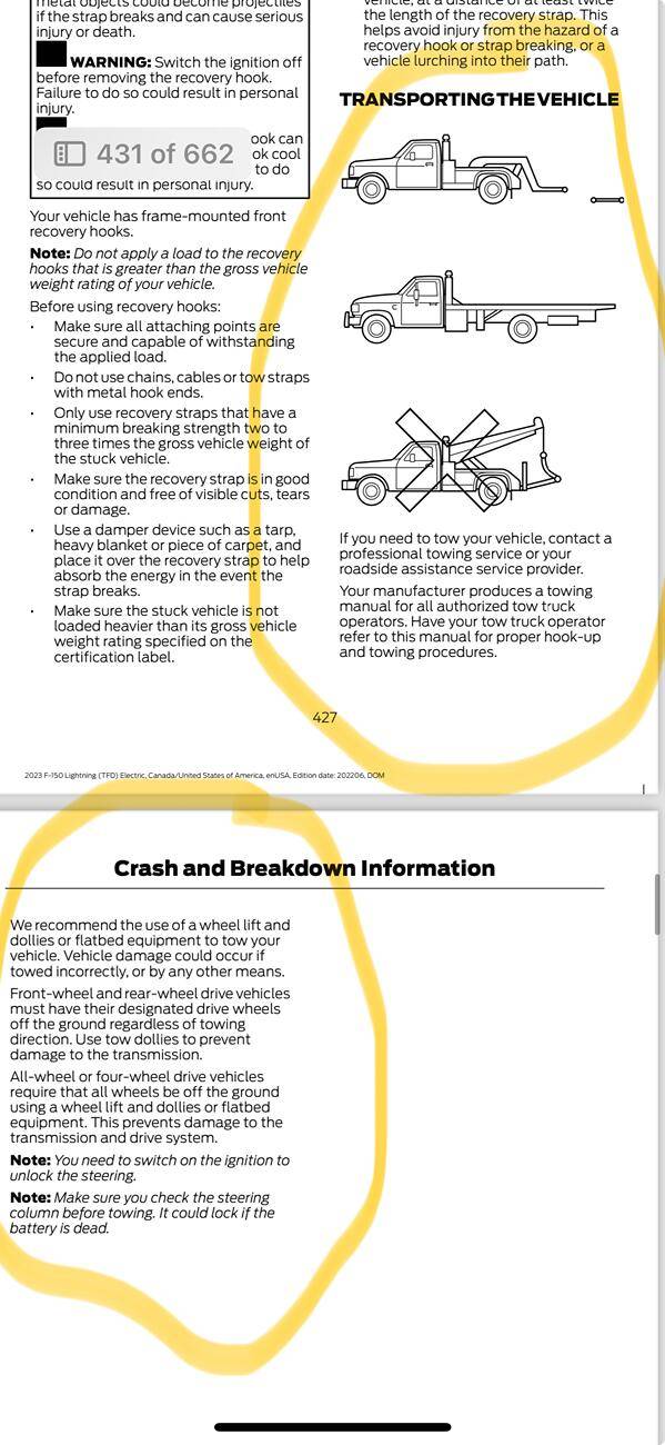

I might be a little late to mention this but make sure they get a flat bed to tow the truck. In case you didn't know, Ford recommends it since our trucks have one motor at each axle. Towing with one set of wheels on the ground can cause damage to the one motor attached to those wheels.
Good luck with the truck. Not a fun start.
Waiting for call from dealer to arrange towing. Will be sure to mention it. Thank you!!

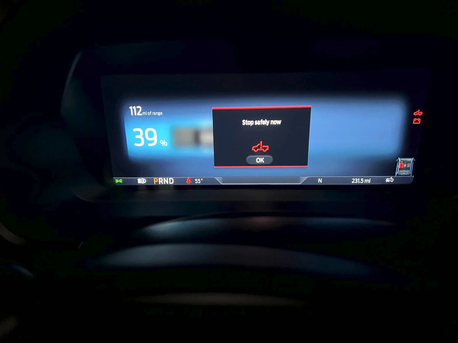

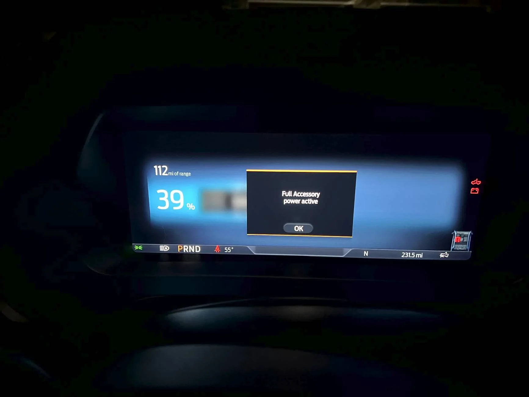

Got home and took a quick look at dash when trying to start....update pics below. Thes 2 images keep switching back and forth..
Ford F-150 Lightning New Flash Delivered and Now Won’t Start or Shift - FIX-post-111=CABIN HEATER MODULE IMG_8183
Ford F-150 Lightning New Flash Delivered and Now Won’t Start or Shift - FIX-post-111=CABIN HEATER MODULE IMG_8184

No prob. Here's the manual mentioning it if you need it. They can use dollies too.
Ford F-150 Lightning New Flash Delivered and Now Won’t Start or Shift - FIX-post-111=CABIN HEATER MODULE 1732147065988-p7

The red battery symbol typically means you are in accessory mode, confirmed by that popup message. This occurs when you don't depress the brake pedal when pressing the Start button.
I wonder if there is an error in the brake pedal sensor area - maybe it's not seeing the brake pedal and throwing the Stop Safely message. Could look under the dash to make sure nothing came disconnected.
Thanks for the info an good thought. We have been thinking that something from the trip may have shaken something loosely connected. Does anyone know what that connector should look like? I will look for anything I can see any way.
