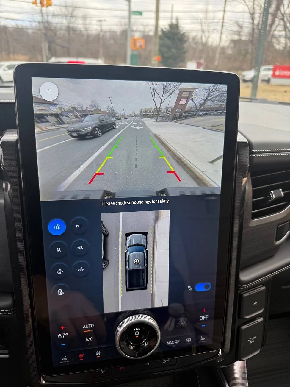

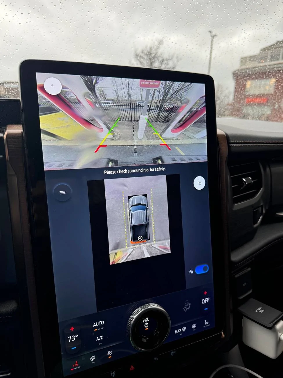

I was an early adopter and my friend just got the 2025 platinum. One of the nuances I’ve noticed that I was hoping was part of an OTA Update was the rear camera.
When in reverse, his truck offers a much larger back up screen than whichever version I’m currently running.
I don’t have a picture of his, but attached is mine and seems like a lot of wasted real estate on bottom half of the screen. I much rather have better vision of what’s behind me when in reverse IMO.

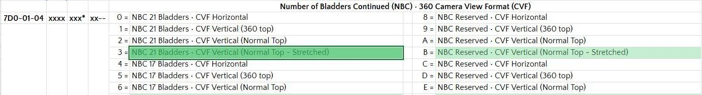

This can easily be fixed with FORScan in minutes. Message me the VIN. You most likely have a 2 in this location. Changing that 2 to a 3 for "stretch" will fix the small 360 cam view you have.

Here is updated side by side between my ‘22 Lariat and a friends ‘25 Platinum.
Ford F-150 Lightning No OTA Update since September 5th IMG_0107
Ford F-150 Lightning No OTA Update since September 5th IMG_0372

Got your message, and you do show a 2 there:
Ford F-150 Lightning No OTA Update since September 5th 1741295127725-
Your truck is on the latest Sync and IPMA software. It is actually very close to being fully up to date. I don't have a Lightning, so not sure if 22-23 trucks are supposed to have those buttons there or not like his truck does, but if your truck is supposed to have them, I am sure that can be fixed, too.
I can tell you that putting a 3 in that location with FORScan will for sure fix the smaller views issue.
