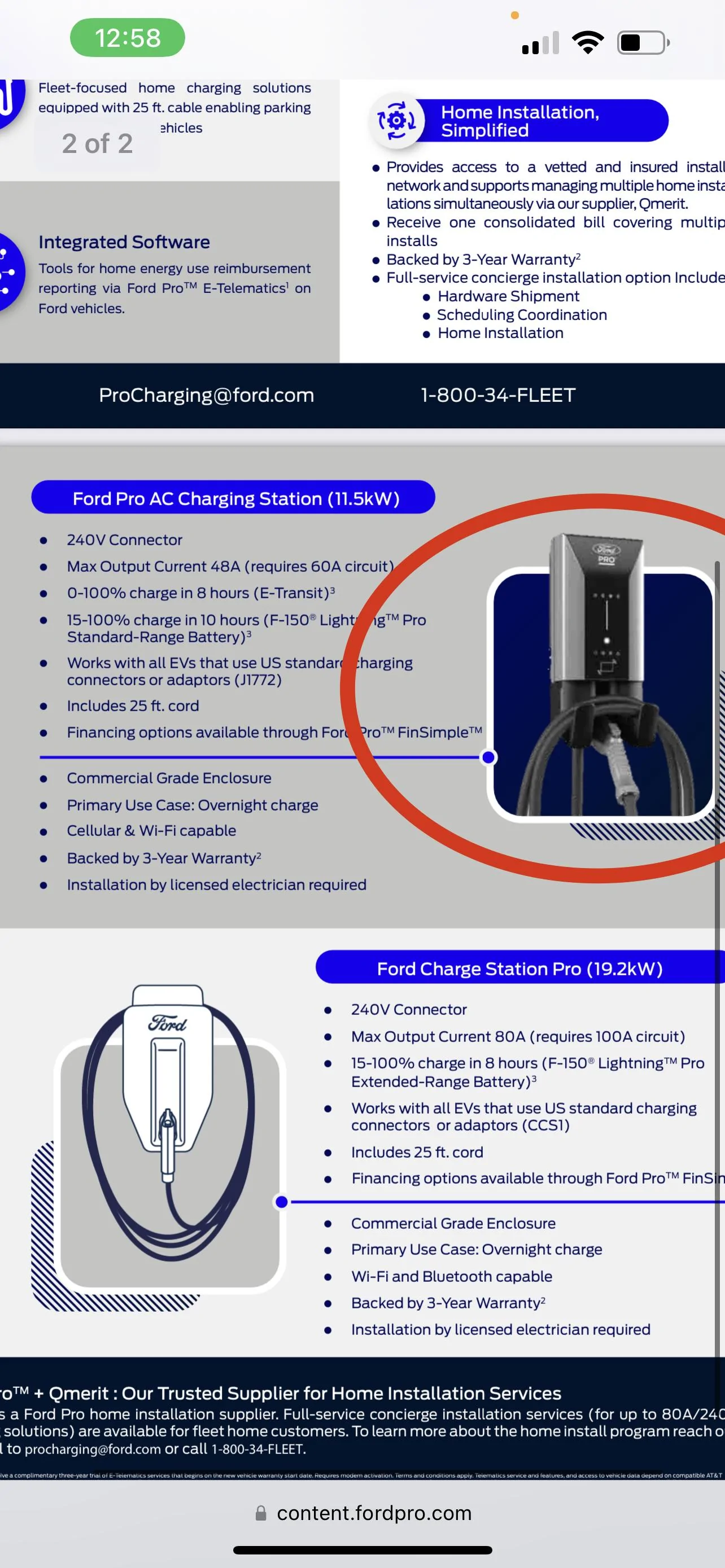

I’ve found this online Ford brochure, which describes (at brochure level) several residential and commercial chargers offered by Ford. Unhelpfully, though, for the commercial chargers there is a line-item describing “Network” as being OCPP, but for the Residential chargers there is no such line-item and so no affirmative confirmation or denial of whether the FCSP is OCPP compliant/networked.
Because I can’t find anything affirmatively stating compliance, I am assuming it is not compliant. Which may be a bit of a bummer with respect to my regional rebate.
