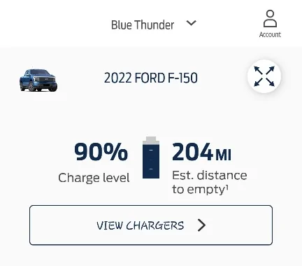

Lariat ER. It's cold in Michigan.
Ford F-150 Lightning ODDLY LOW BATTERY RANGE Screenshot_20221117_132602

Wow, that is about a 33% drop in range. GOM, beside temp, looking at your highway speeds for estimating range? Preconditioning (still trying to figure that out) accounted for?
My SR would be lucky to have 160 miles of range at 100%. Think I will move to Central America. Visiting my Mom in Detroit is out of the question for when below 50F!

My commute is 80% highway. I set my cruise to 74mph. I don't precondition anymore because of the glitch with the heated steering wheel.

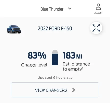

This is my "range" after charging overnight.
Ford F-150 Lightning ODDLY LOW BATTERY RANGE Screenshot_20221118_083435

First rule of EVs: The range estimate on your display isn’t your actual range.
