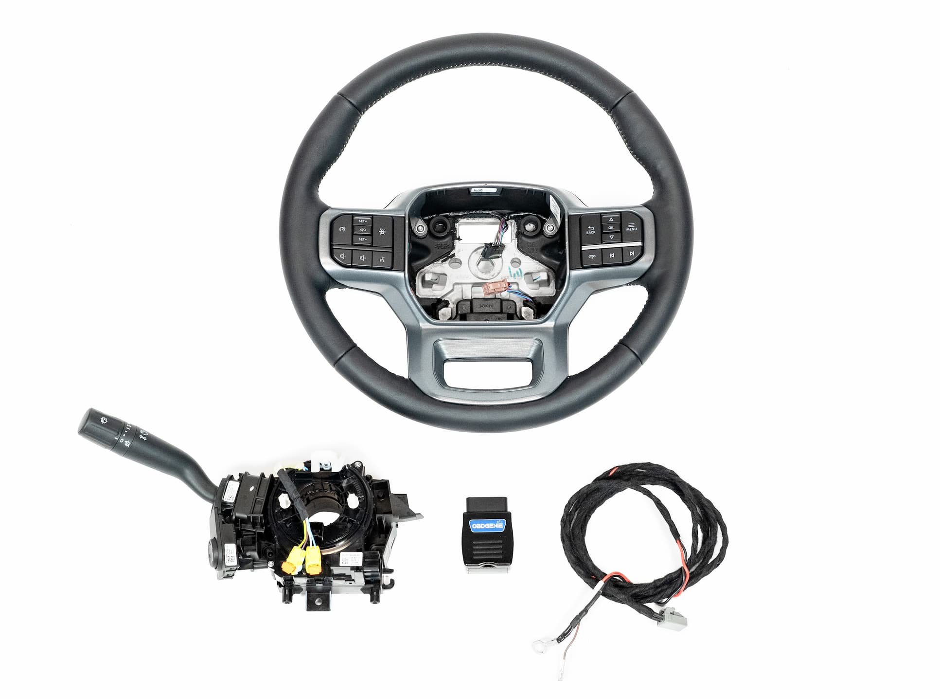

A heated steering wheel was standard on my 2012 Nissan Leaf. It would have been nice on my 2023 Lightning Pro. Now maybe I can upgrade and have it?
3,820
6,981
I did it on my 2018 F150. Needed a wire harness, new clockspring, steering wheel and FORSCAN changes. Looks like they have the same process, but provide everything for you.
Before ordering, I would ask if thier programming process works for the Lighting. The truck in the video is a pretty basic truck. I can't remember the last time I saw a truck that needed a physical key turned to start it.

Sorry, I thought there would be a link on the video page:
https://ctrk.klclick.com/l/01KH6DEESCMCTWT9SAMGHBM86B_3
They can check the vin to make sure it will work with your truck, btw.

$1000 oof! This will have to wait and I’ll probably do the adaptive cruise at the same time since I’ll have to swap in new wheel buttons anyways.

I didn't look up the price...I was afraid to.
Directing the Ford heat vents towards my hands does a pretty good job for my climate - if I lived in the North country, might be worth it.
There are some other inexpensive after market products that wrap aroung the outside of the steering wheel and plug into the accessory (cigarette lighter to old folks) outlet, but they get mixed reviews on Amazon for example.
In the Leaf, the cabin heater is pretty weak, takes quite a while to warm the thing up an takes a big hit on range - well, 10% seems like a lot when your range is 80 mile in the cold weather.
Heated seats and steering wheel is all I ever use in the Leaf in winter.
You know when I watch videos like the one for installing the OEM one, I think to myself, no wonder the truck costs so much! Could they have made it any harder to change things?
