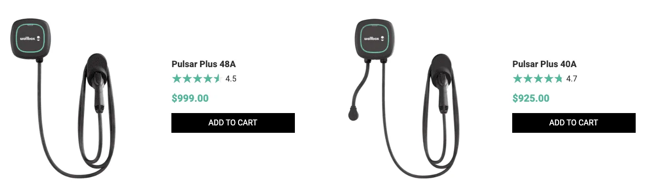

Yeah, even though wallbox's are on the lower end ( I think around $400 a pop ) that's still a lot.
I haven't received any of the 6.x updates yet so I'm afraid I can't help determine where the root of the problem is. I haven't seen any other threads (that I can recall) related to it, likely because only a small portion of owners have actually had it pushed.
Youch. I think it is CAD but still.
Ford F-150 Lightning OTA recently causing EVSE to go into Error mode 1706282164465
2,634
2,821
I stand corrected...I hope you are able to figure out what's going on so you don't need to replace your current setup. Nice to know there's an alternative but I wouldn't go that route unless it was my only option.
