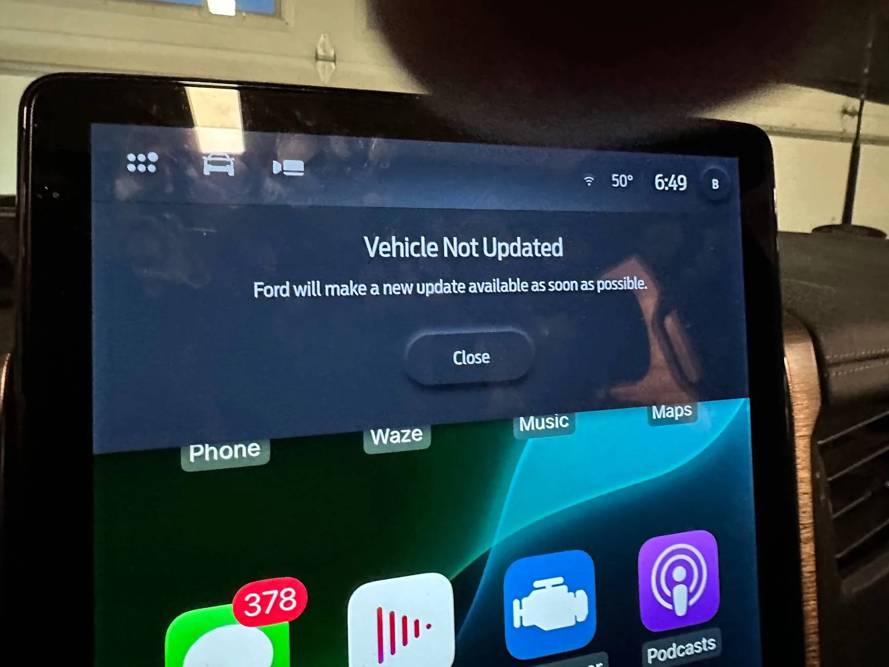

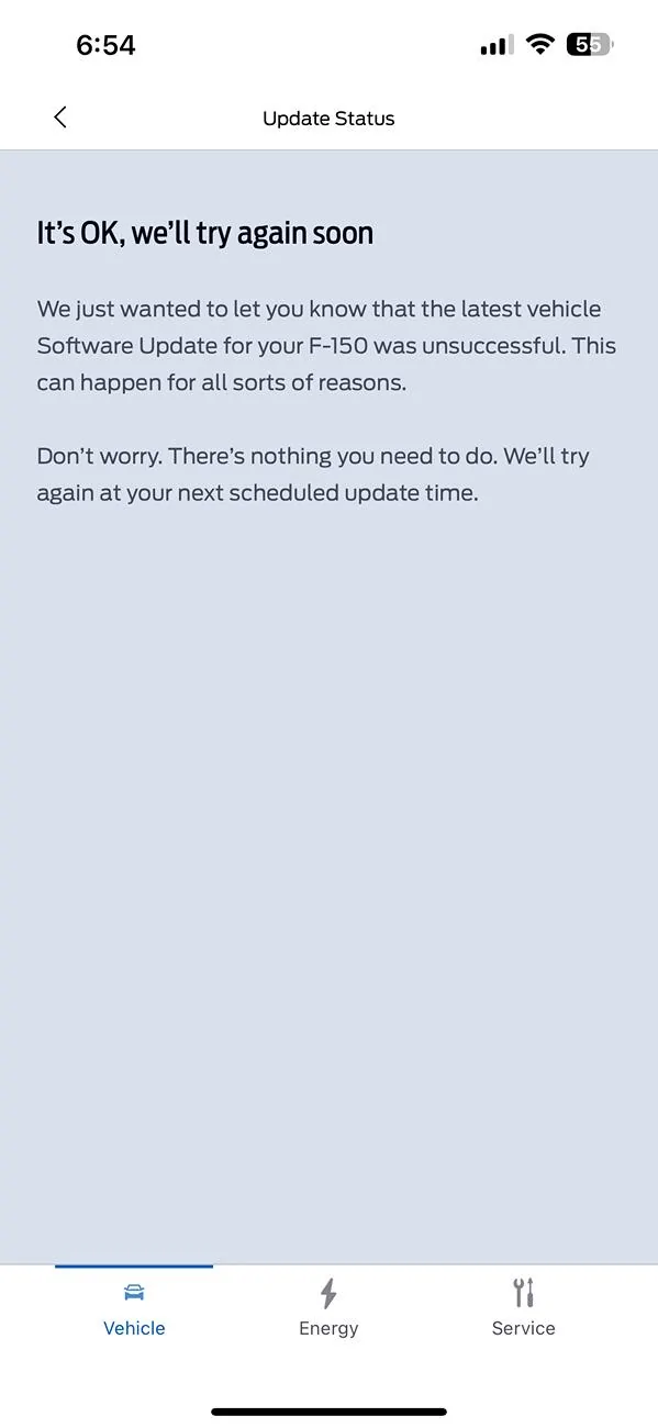

It's not you... I'm in the same club. Only in a nice warm climate. Update won't take. HVB at 55? Nope. 95? Nope. LVB at 81? Nope. LVB at 99? Nope.
Update haas failed a few more times and LVB was definitely above 80%. On Sunday morning I got a slightly different message on screen and in Ford Pass app.

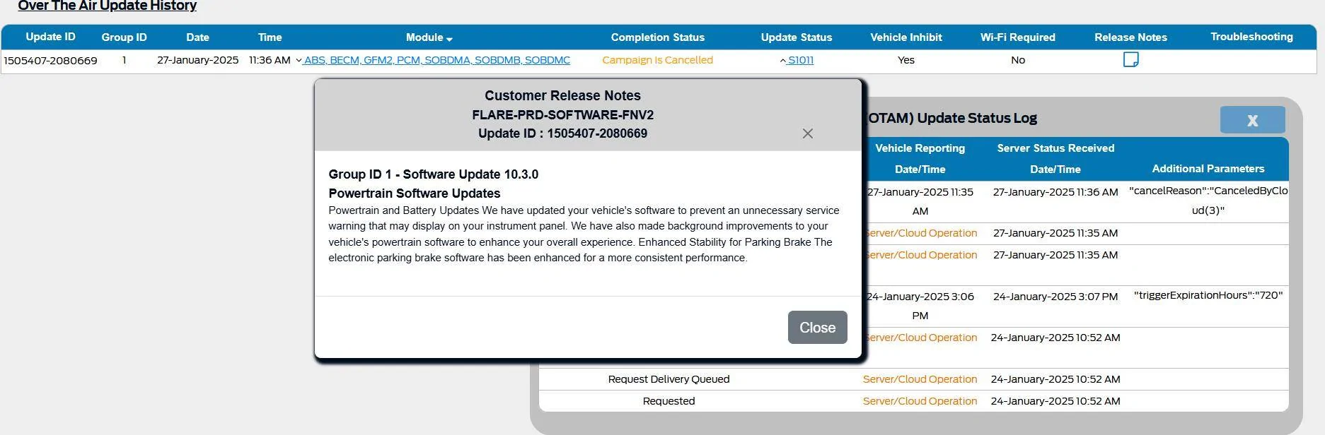

Almost certainly the powertrain/limited power error that stresses everyone out but 99 percent of the time a restart of the system clears it out and you’re fine.
I had this issue too; the service light came on literally the night I bought it. It was in the shop for half a month before I could actually drive it lol. I highly recommend that if you get this error that you bring it to the dealership and have them look at it because they found other issues in the meantime while they tried to figure out what the powertrain issue was.
Gimme_my_MME
May 29, 2022
653
1,253
There must have been too many people complaining about issues with it.
Complaining makes it sound like they were doing something wrong making Ford aware and thus stopping and fixing it isn't the right thing to do
3,828
6,995
I didn't mean it like that. Let me rephrase.
Ford must have received reports from beta testers of problems with the update and will rescind said update until these concerns are taken care of.
