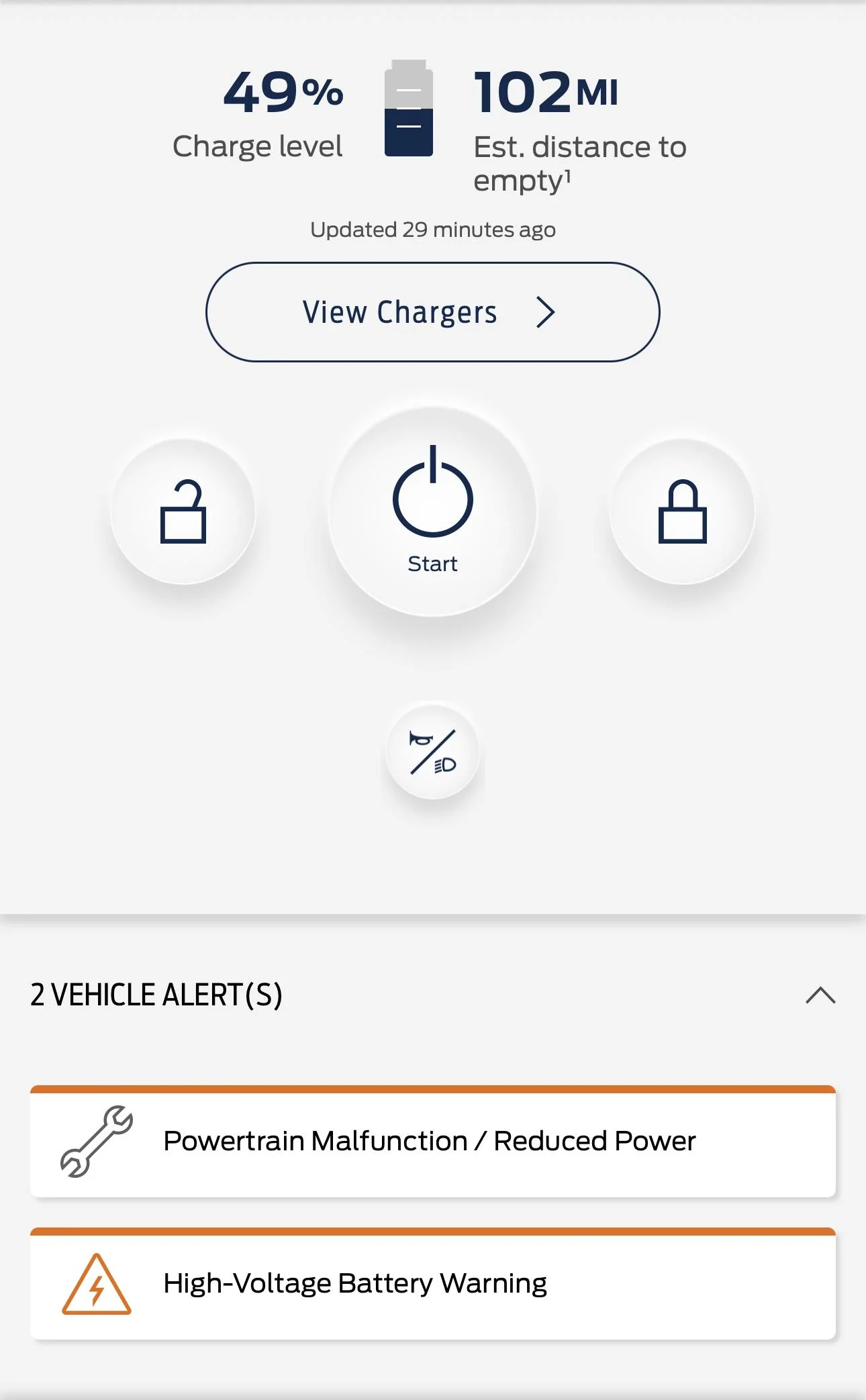

I left for an extended weekend vacation, left the truck at 49% SOC. Arrived home and try to go out for a drive but the truck was throwing me all kinds of bad news, decreased power, service asap. I only had 4% available power.
After using a code reader I somehow ended up with P0B24, which is,
OBD-II Code High voltage system may not operate is defined as a Hybrid Battery "A" Voltage Unstable

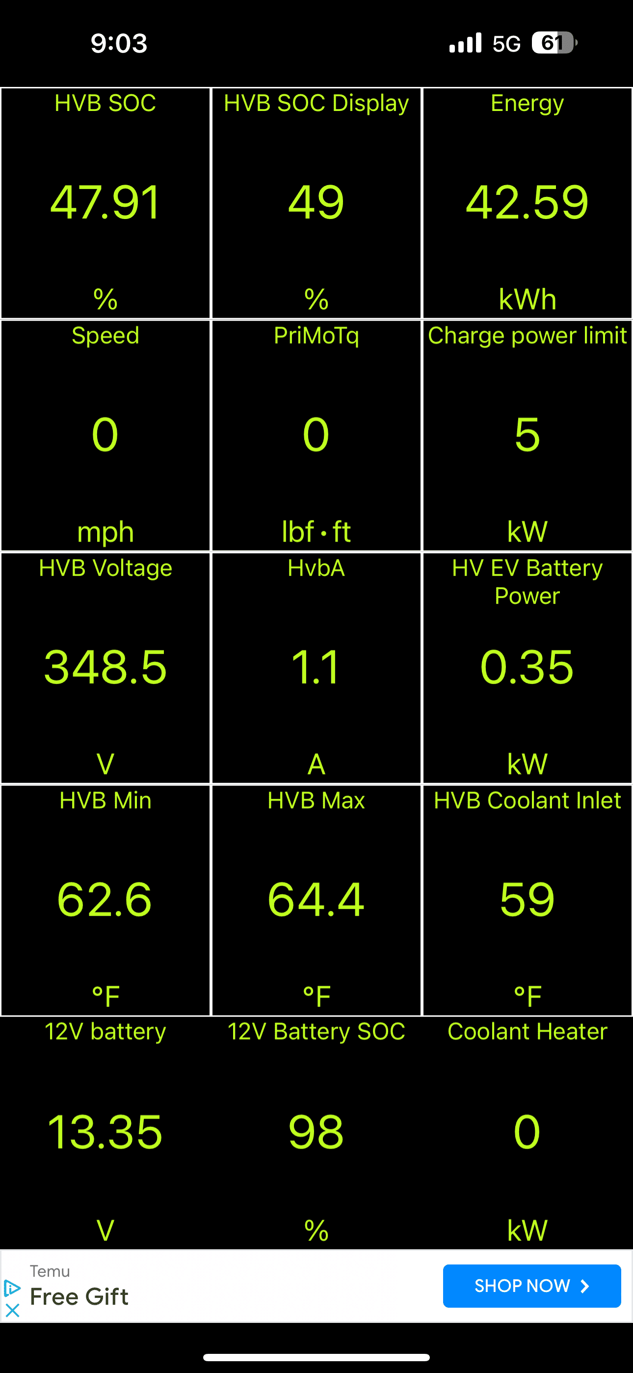

It looks like I'm pretty hosed as I disconnected the 12v battery and all codes re-appeared. My ODB II reader is showing me SOC 47.91, HVB 348.5, (isn't this supposed to be over 400?)

Here are a couple pics. I’ll have to take pics of the dash tomorrow.
Ford F-150 Lightning P0B24 Hybrid Battery "A" Voltage Unstable IMG_1289
Ford F-150 Lightning P0B24 Hybrid Battery "A" Voltage Unstable IMG_1287

Looks like your pack definitely has a problem. Your Charge Power limit is 5Kw which is pretty low.
What OBD-II code reader did you use for that? Lots of interesting info on that page. I'd like to see what the Charge Power Limit parameter says when I'm plugged into a 350Kw DC charger and only getting 33Kw!

I have an ODBLink MX Wifi edition and using the Car Scanner app, recommended from Kyle Conner. It was actually the first time using it so I don't have a baseline to compare it to.
